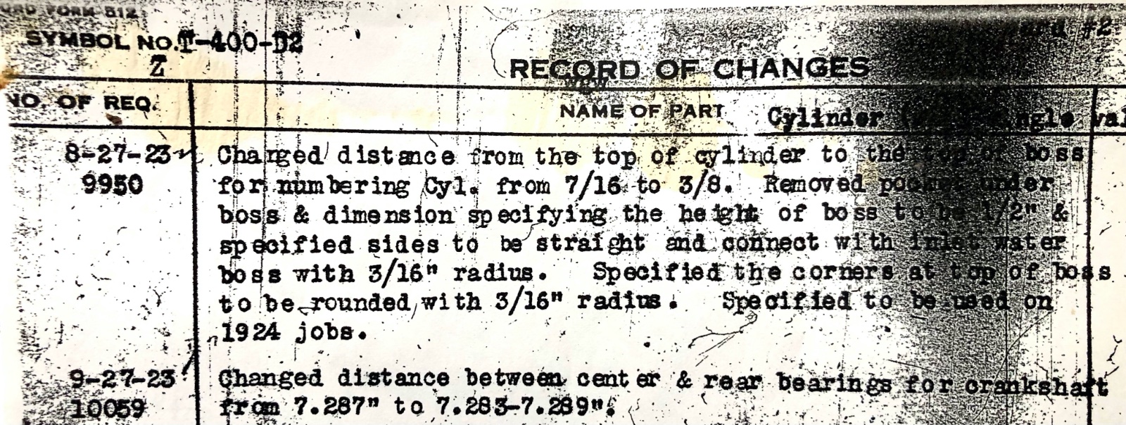

That is a much later block, with the longest length boss, shaved, and has been re-stamped with a ‘14 number, not a factory stamping.
Compare to the below pic, as the years went by the serial number boss got longer to handle the million serial numerals.
The lower block is a real 1914, with correct shorter length serial number boss, and correct casting date.

The length of the boss proves that engine was made after May of 1924, way later than the so called new production that was purported to be in 1917.. Believe the issue is that perhaps this photo is series of when a new assembly plant was built after 1917, likely '23 or '24 there.
Why the early fake number? Who knows, but from the clear photo that serial boss shows signs of being milled or filed down with the sideway marks, and the funky stamping. ;)
Note the curly inward pig tail on the 6 and 9, that is too fancy.
As for the motor, that block is later than 1924, as that is the final date of the 'longest' serial boss, as more T were being made......The last change to the boss happened in 1923.
Easy way to identify a block is that serial boss, even if no serial number is stamped, and it was a bare block sold to dealers for replacements.
Final Serial number boss length:
