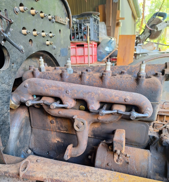

This is the exhaust manifold from the barn fresh tourer I am working on returning to the road. It is not as warped as some, as the front three ports are still in line.

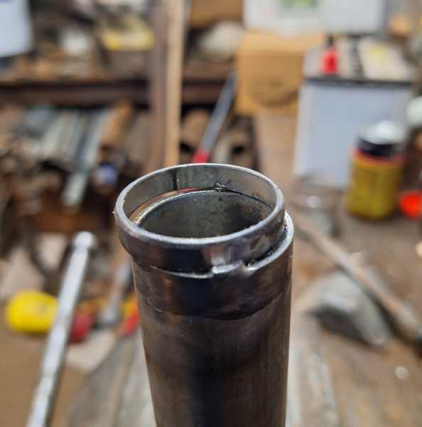

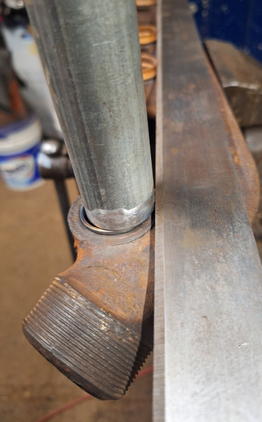

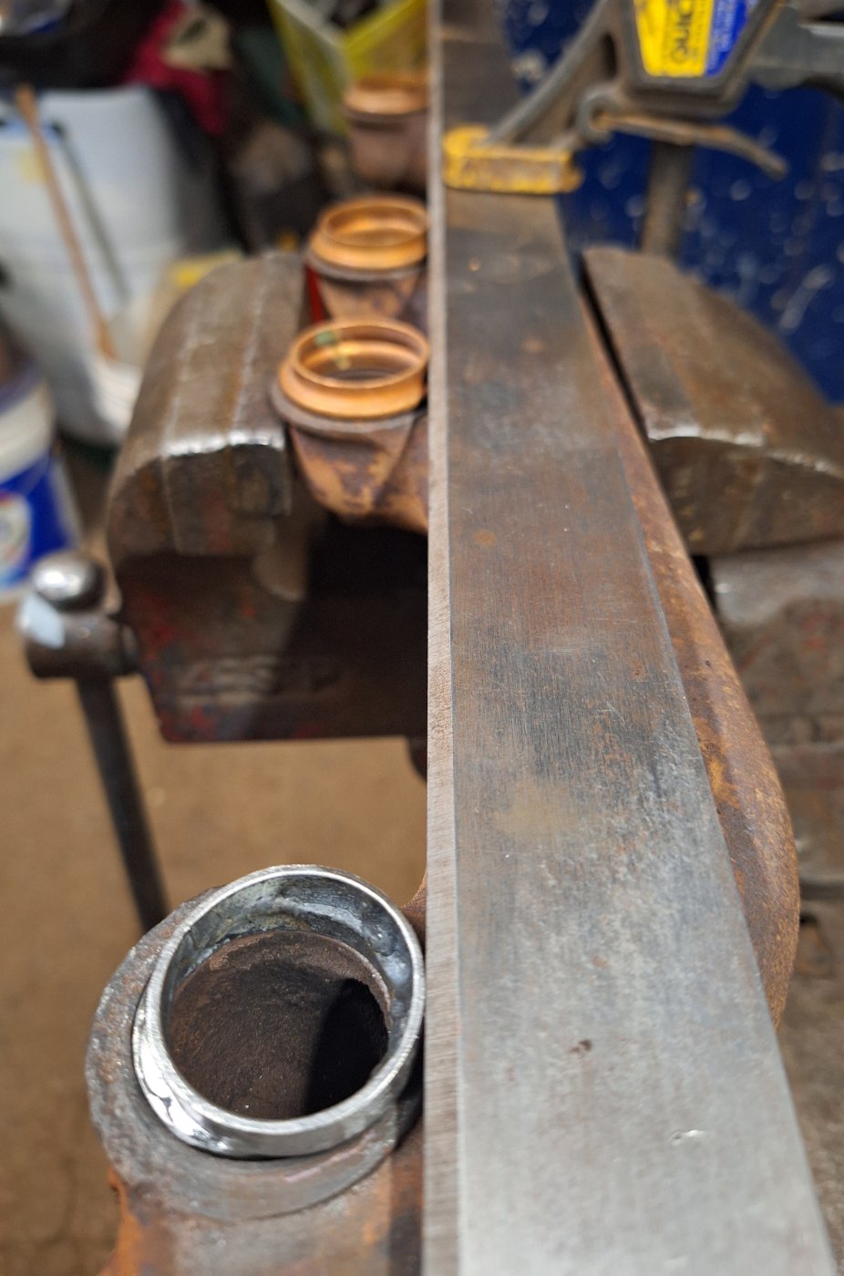

To enable fitting the bent manifold, I make offset glands like this. I cut one gland ring from a piece of exhaust tubing and fit it into the manifold. This photo shows the offset needed. The two pieces are the tack welded together and the offset checked. By tacking on one side only, the offset can be adjusted to suit the need by twisting the two pieces before welding them together around the inside. Then all you need is one of the copper rings from the vendors to go on the offset gland.

This manifold was not as bent as some, as the front three ports were all in line still. Usually I have to line up the straight edge on the two centre ports. This usually shows the front down a bit, and the back port more so. I then follow the same process to make two offset gland rings to make the necessary corrections.

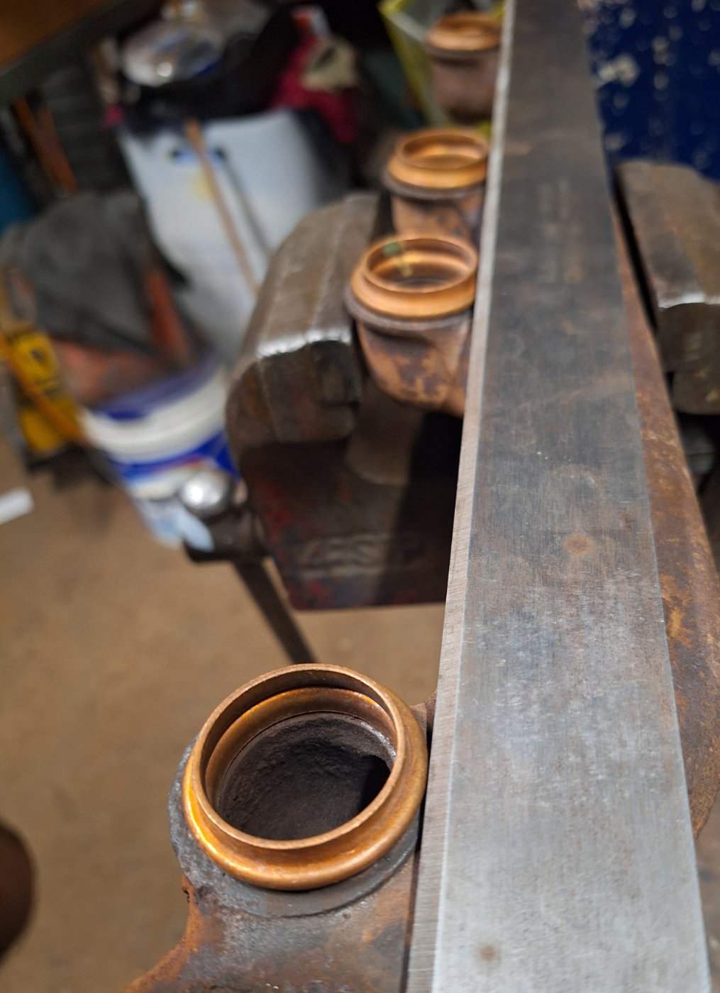

It"s on. The copper one piece glands needed some massaging. They fit a little too well. Thankfully they are thick enough to take some filing. Tha back port has two thicknesses of the green three hole type gaskets. Being isolated from the exhaust by the gland ring, it holds up well in this application.

On this manifold the front three ports were still in line, just the rear one warped downwards. Usually the warping starts at the front and gets progressively worse towards the rear. Then I put the straight edge along ports two and three to see how far the front port and rear ports are down. That allows me to make two offset glands to accommodate the two out of line ports.
