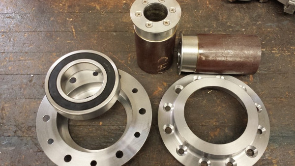

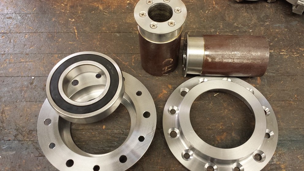

they work great and have a nice big sealed bearing here is how i make mine these are not finished but
you can see the design

Phillip, I use a similar design to make floating rear axles for my T's, but do not make them into a true safety hub.
I presume the unmachined tubular part of your spiggot goes into the axle housing, the bearing goes over it, and is retained on it by the thin flange screwed in place. Then this sub assembly is fitted in the carrier to be fixed to the wheel. Your photos of the unfinished set-up raise a few questions.
How do you fix/retain the spiggot in the axle housing and seal around it?
I presume the 6 larger holes in the carrier coincide with the 6 hub bolts. If so, does the countersink mean you use a countersunk bolt with a nut on the outside of the wheel?
What purpose do the six smaller intermediate countersunk holes serve?
I may have to adjust my work to make improvements.

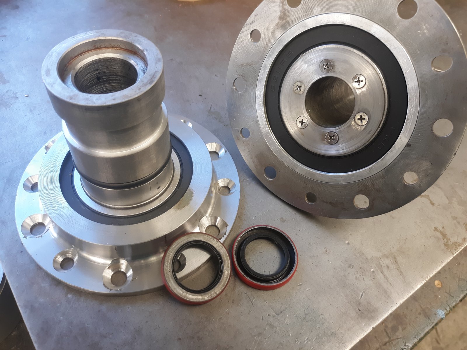

i use 2 big o rings to seal it then t put a groove that lines up with the grease cup. tap the hole in
the grease cup and put a set screw there cap then hides it. the extra holes are for holes i tap in the inner
hub flange.
hub flange.

i also just tap the holes for the thru bolts on my current design. bolts go in from outside.
better but you see the hex heads but less clearance issues and you can check tightness

Re: Floating Hubs / Safety Hubs
on these i used chamferd nuts but i didnt like them
