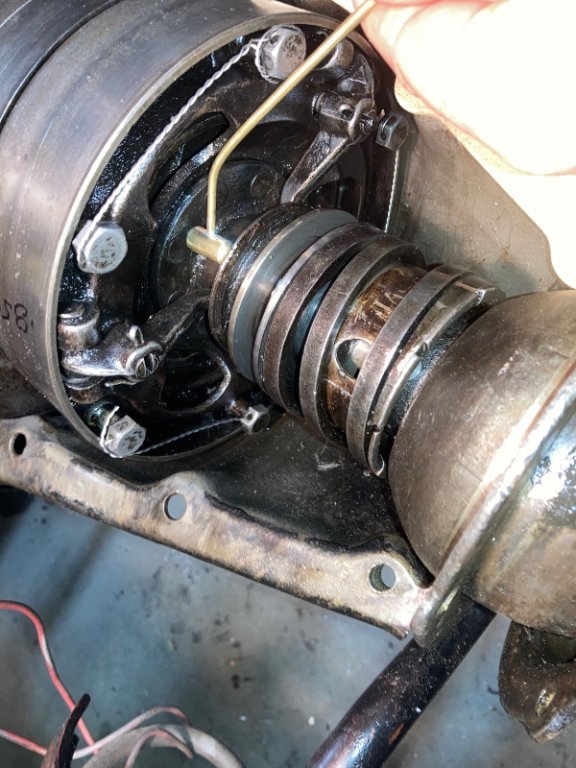

Just to be clear, is this where you're measuring a 1.25" gap? In this photo, someone has devised a tool to quickly gauge the gap. The length of the brass rod is 13/16".

Jerry that is where I am referring to. Right now the gap is just over 1". It was at the original
1.25 when I first noticed it. I then adjusted it back to 13/16" using that same tool in your photo.
I drove it and then got the shuddering (it did not really shudder when it was originally at the 1.25").
Then I increased the gap to where it is right now at just over 1". The shuddering is there but goes away
after a short time as I accelerate. Then is smooths out up to about 30 mph.
