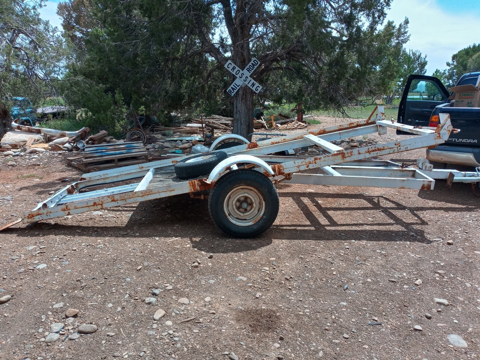

My uncle built this one in the early 70's and passed it along to me. I've run it across the western states twice now, works great! Tandem axles are preferred these days but the lightness and ease of a smaller single axle hauler is appreciated. Because uncle set the balance so well 2 people can easily roll a T up on it. The front has 2 big turnbuckles that hook to the front axle of the car that hold it in place, I use tie downs as well but the T would stay there without them. Of course open trailering does require that you pay attention to any loose items.

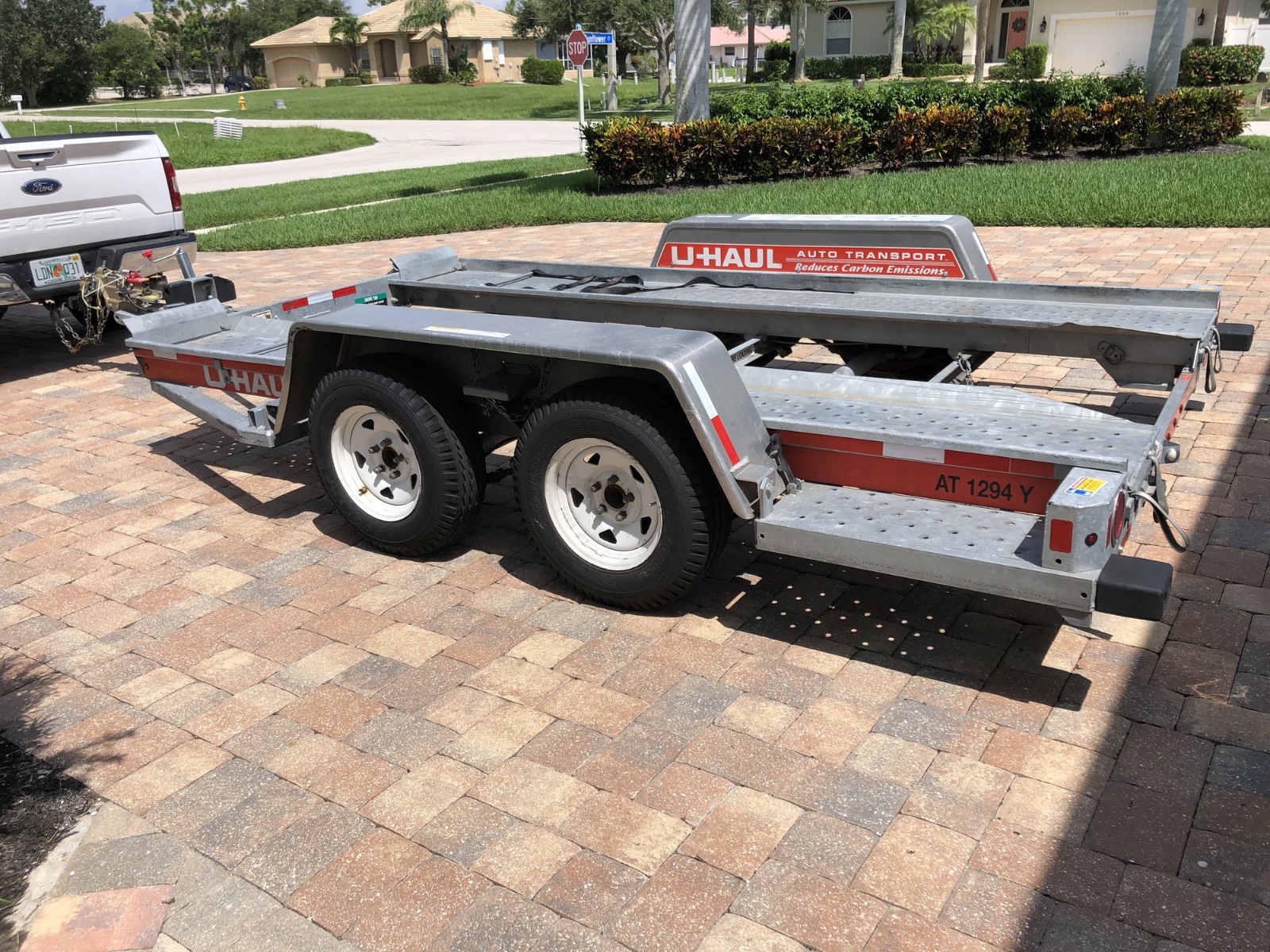

In 2001, I hauled my 1926 coupe on an open U-Haul trailer 1,400 miles from York, Maine to Bartow, Florida with absolutely no problems. I pulled it onto the trailer using a 12v battery operated winch and hauled it behind my F-150 Ford truck and at times, I forgot I was even hauling anything. I highly recommend it. The only worry was when I had to stay overnight in a hotel, I was worried that someone would mess with the car, but you won’t have this worry if you are only hauling locally. Since it was restored in 1972, my T has never been exposed to rain, so I would have worried about rain, but the weather was perfect. Jim Patrick

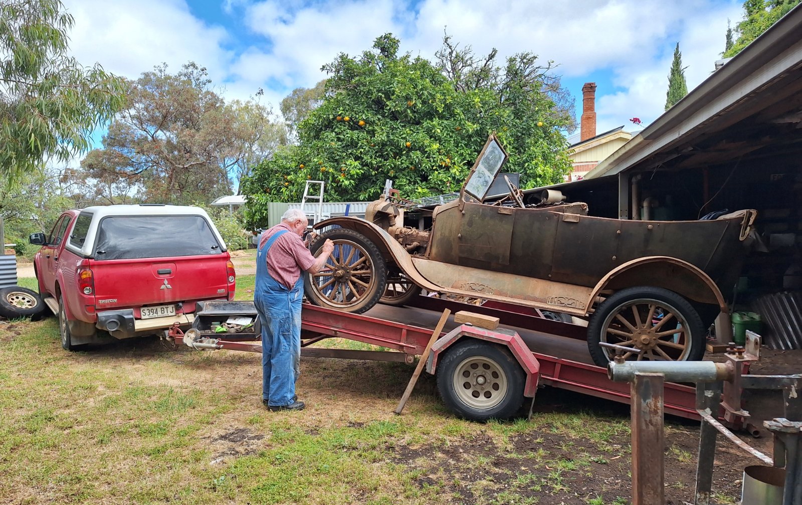

This is the 5th tilting, single axle trailer I hàve
built. At the 2010 National T Rally, all 5 were there!
It has a bed of 6' x 12'
It has a toolbox on the drawbar for the jack and tiedowns, and some spare wheel bearings.
It has a hand winch for breakdowns, but I drive on.
It has electric brakes
It is light and tows excellently at legal highway speeds.
It has a jockey wheel which allows me to push it into tight spaces with ease.
I can even adjust the axle fore and aft for unusual loads, but have never done so.
It has had two blow-outs in 20 years of use, both with loads and without incidents.

Those U-Haul trailers really are not only nice looking, but sturdy as heck. When my folks wised up and moved to Arizona from Ohio to live out the rest of their golden years, they used one of these behind their 24' U Haul box truck...about 2000 miles, hauling a full sized 1985 Chevy Caprice. Like you said, never knew it was back there. Gotta remember, U-Haul are hauling PROS...so you can bet it's had any "kinks" worked out of it for safety sake. I wonder if Bill could buy one used from U-Haul?

Google “Uhaul sell used trailer “ see what you get.

Ha ha, guess I shoulda thought of that. Answered that question! It's "nope"!! Too bad. Probly the usual liability fears thanks to our wonderful lawyers.

All timed-out U-Haul trailers are destroyed. If they were sold, you wouldn't rent one.

Bill, mine have all been 12' long for a particular reason. When I build them I use three 4' x 8' sheets of 2mm plate. Each is folded to form the sides and coaming rails in one piece, giving a 6'deck width and low enough sides that a modern car can be driven on and still be able to open the doors.Then all are seam welded to the frame. They become a structural member rather than an add-on. Today, I can buy 5" x 8' sheets, and i would use one of these in the centre section to make the trailer deck a foot longer. If you look closely at the photo you will see that the T is run about 4" over the front of the deck to a restraining bar. when the car is tied down at the front, all the tie downs do is pull the axle to the bar. There is no load at all on the radius rod or its ball on the pan.
