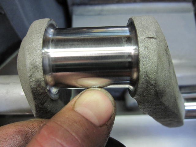

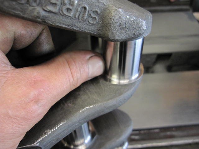

Post by J and M Machine » Mon Feb 12, 2024 6:50 pm
We try and keep them as big as possible. At least 3/32"
Problem is after 100 years and bad machine shops most often nothing left.
