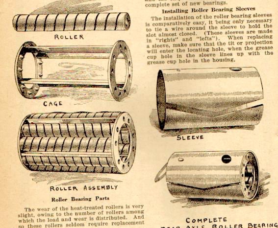

These bearings were invented by John Hyatt in about 1895 for the sugar beat industry. Eventually these bearings were used in automotive rear axle bearings.
The advantages of wound roller bearings are the ability to absorb shock, to accommodate some misalignment, and to tolerate a fair amount of contamination (dirt). The downside is they have lower dynamic capacity than a similar size conventional cylindrical roller bearing. I want to calculate the capacity and expected life of these bearings in the outer axle bearing position. The analysis of the inner bearing position is much more involved because of gear loading.

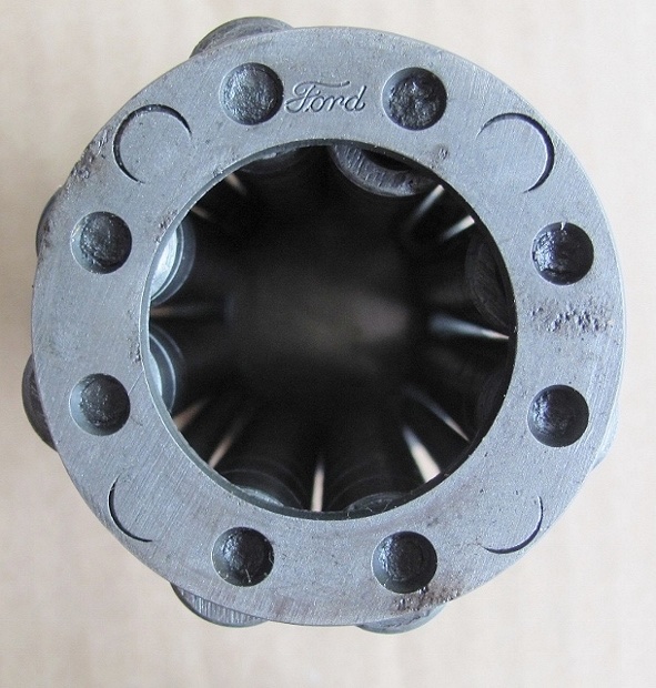

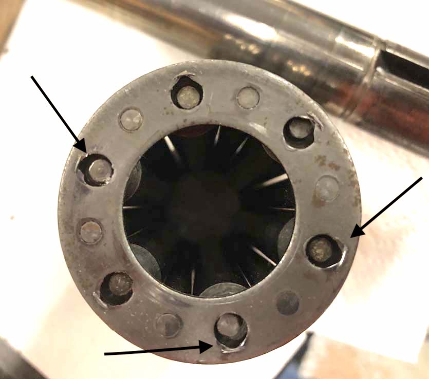

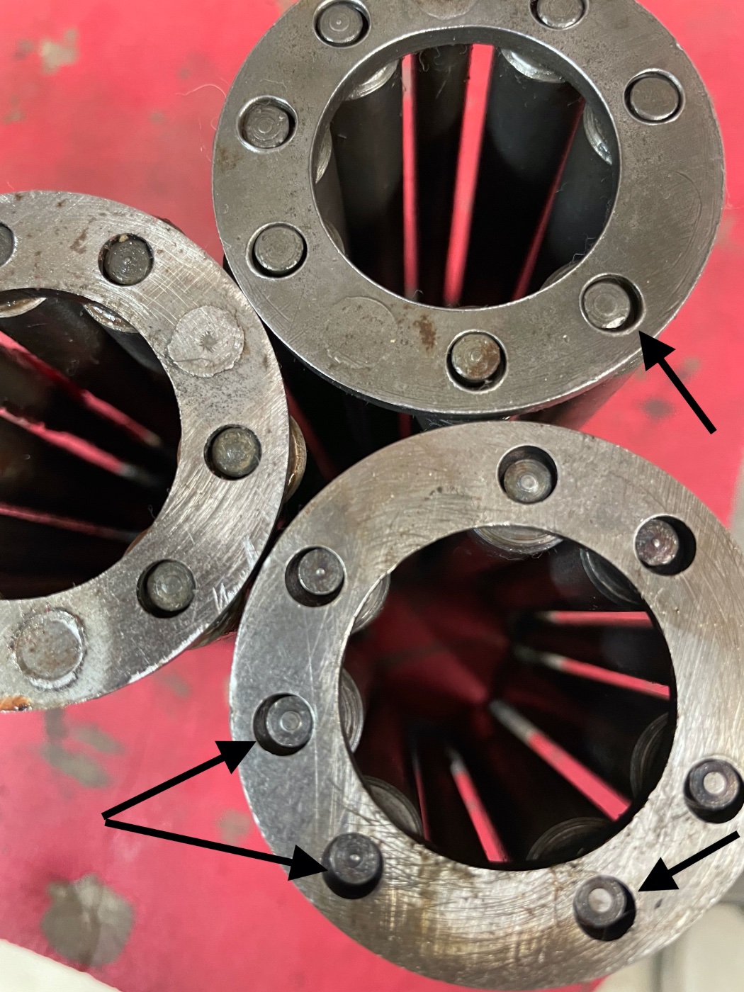

Every one of those solid Rollers that I have removed, IMO, show distinct wear out of the pinion ends of the solid roller. Some solid mfg. have 6 and some have more of those tiny pinion ends that are extra axles that turn in the cage, and wear out the cage holes.
The Hyatt Ribbon Roller bearing doesn't use a pinion axle in the cage, the Ribbon Roller can float a tad and that prevents abnormal wear. Of course the cage end rivets can become loose, and that renders a Hyatt bearing useless.
But that solid Roller design can escape the cage holes and bind. Known happening with the large dia. solid Roller driveshaft bearing.

The original drawings were drawn with ink on linen clothe. I worked on these in the 60's. They are difficult to make changes and don't reproduce very clearly.
In response to the roller axles (called trunions) wearing on the cage: this is where development comes into play.
I think I have seen solid roller axle bearings without trunions. The cage controlled the rollers

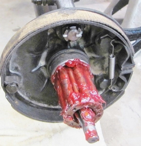

Those inner Hyatt's get lubed from the rear axle lubrication, usually 6000W.
The outer Hyatts get lube from filling and turning the grease cups, a good wheel bearing grease, like Valvoline universal red type is just fine.
