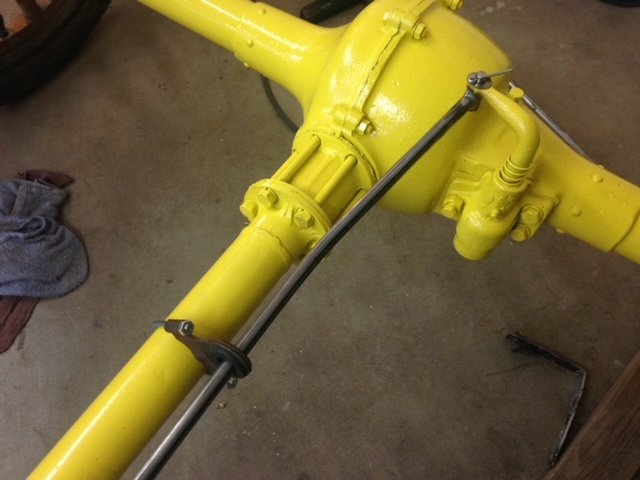

Hi Iu'dai,
I did not put the park brake outside the the body but did move the the Ruckstell shifter out side the body. I mounted the shifter on the radius
rod & drive shaft tube so the shifter moves with the driveline outside independent of & under the body. I installed the shift lever up so the shift handle is reversed from normal. ( Ruckstell forward & Ford back ) Craig.

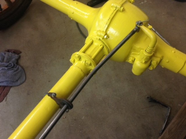

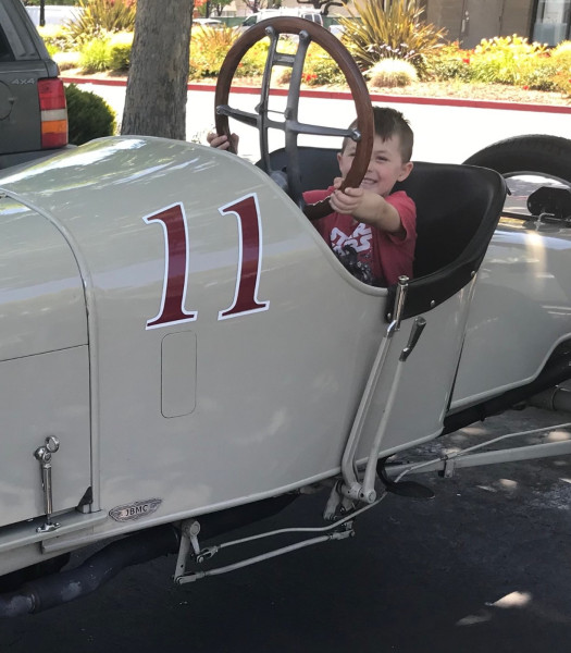

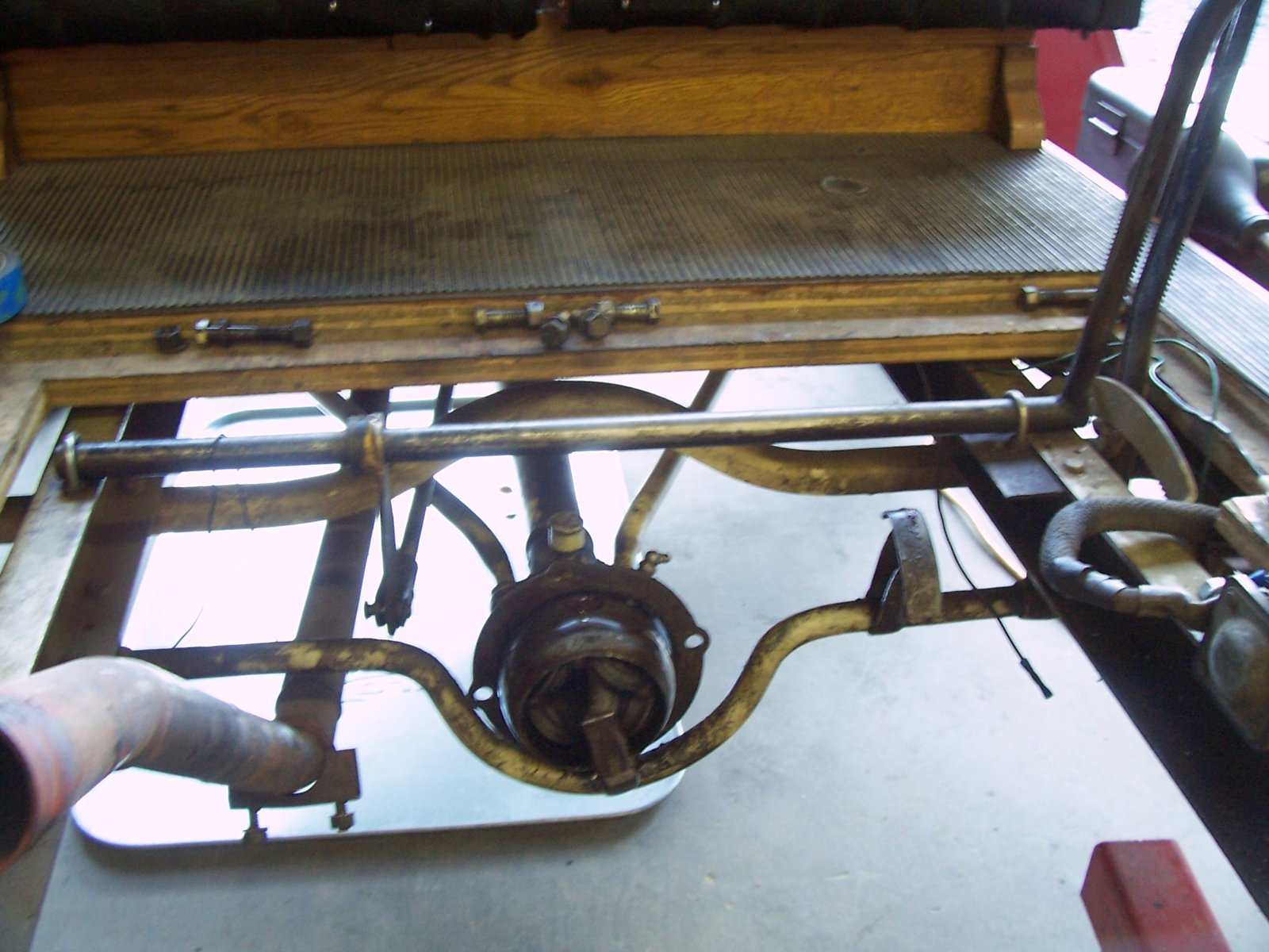

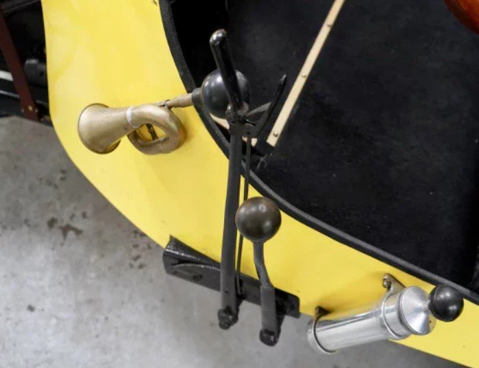

Found these 2 pics. Love to see the undersides of these cars. My car has one of those brake equalizer set ups for a 20-27 T that allows the brake to work as either foot operated or the hand brake lever. But I am removing it and going to just stock style lever E-Brake.
I want to use a Model A brake lever for the outboard left-hand shift lever for the Ruckstell and the OEM lever as is but keep the left side E-brake connection in the stock location. Craig, I like how you got yours going in opposite directions. I imagine if I have both outboard, I will have to take the knee bend out of them.

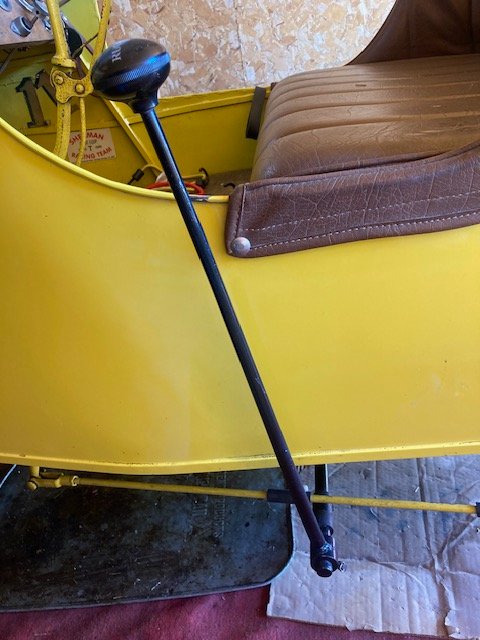

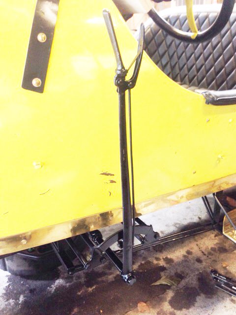

Here is how it was done on my '23 Speedster.
Craig Leach
- Posts: 2033
- First Name: craig
- Last Name: leach
- Location: Laveen Az
Re: Anyone with a speedster and a Ruckstell and hand brake on the left outboard off the body?

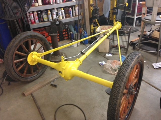

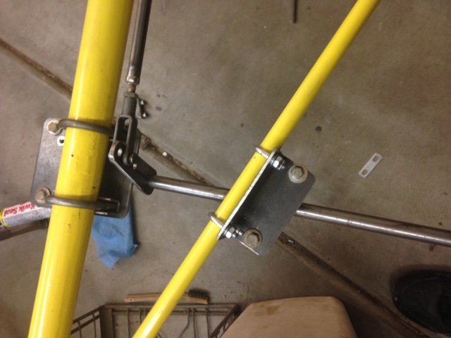

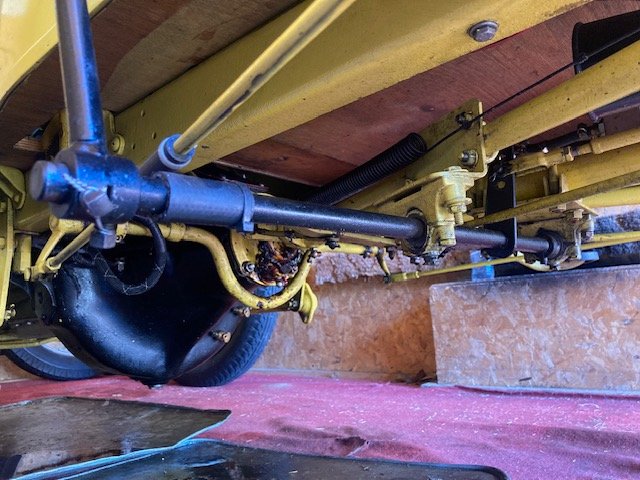

Hi Skyhunter,
I was unable to email these so I'll post them. Hope this helps. Sorry about the mess I haven't cleaned it up since the last speedster run.
Craig.
Craig.

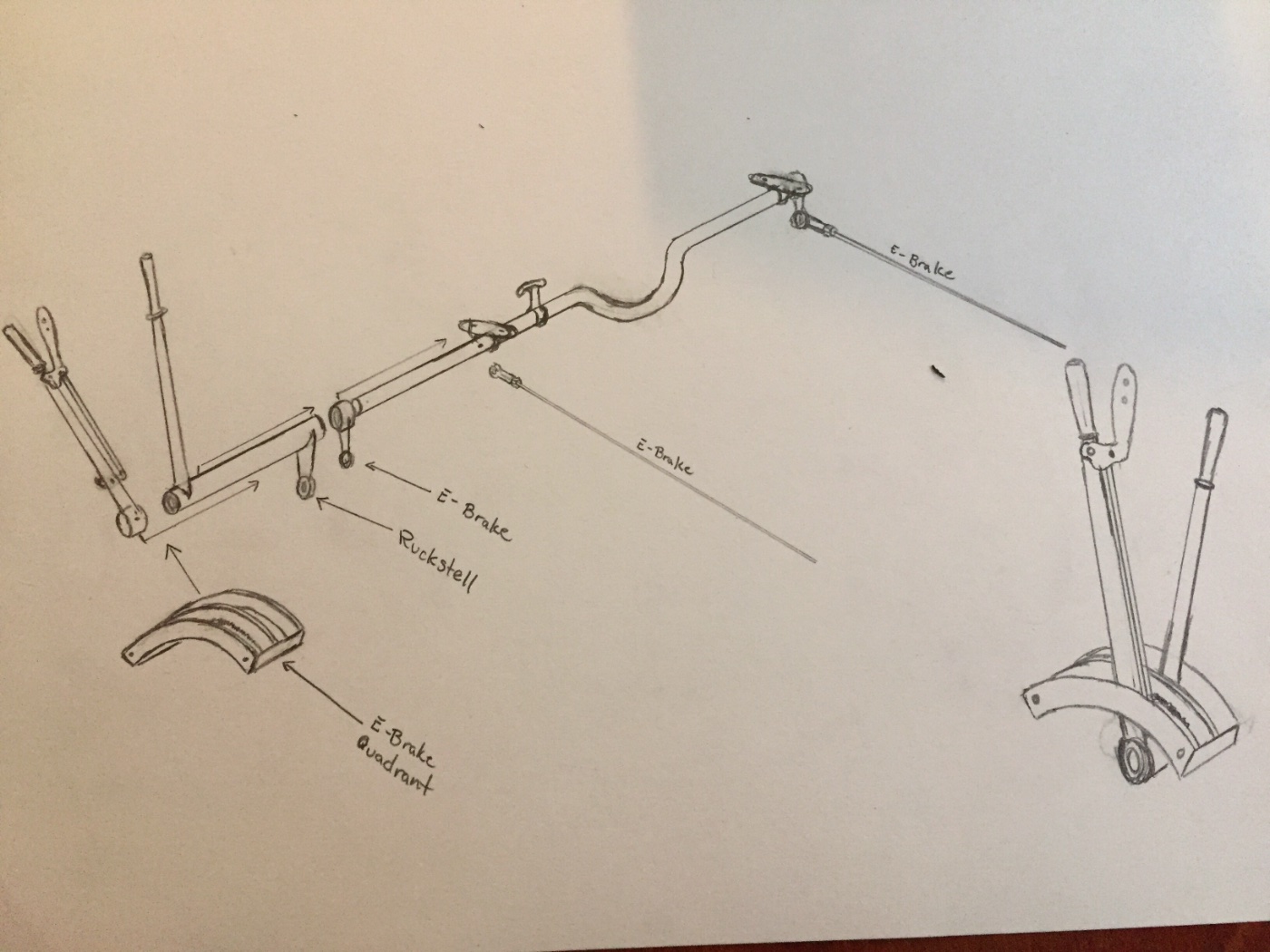

Well, I have not built this set-up but I have thought about it. It uses a factory parking brake shaft extended to the outside of the speedster body. A tube with a handle welded on slides over the extended section of the parking brake shaft. The factory emergency brake handle then goes on. For a speedster appearance, a “gate style” quadrant goes around the Ruckstell and emergency brake handles. It would require a clever Ruckstell shift rod to go from outside the frame to the shifter on the Ruckstell.

Hi Chris,
Thanks for posting that drawing I will print & save that.
Craig.
Craig.

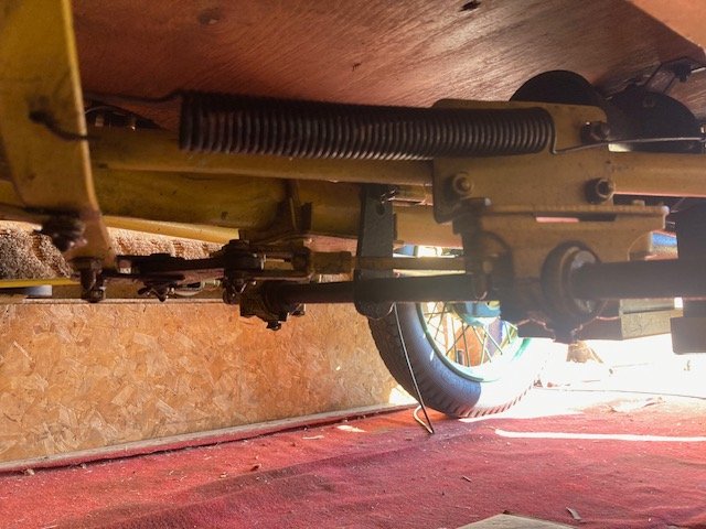

Ruckstel and Model T brake lever on the same shaft. All levers are farther back than stock location. Ruckstel shifter goes through, Model T brake lever goes forward to actual cross shaft that is Model T brake/shift handle.
