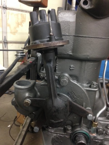

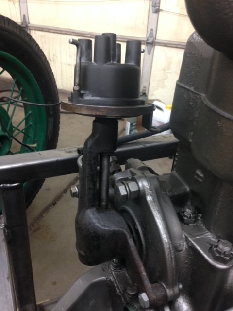

I was frustrated with not knowing the coil system, so I adapted a Model A distributor to my Speedster. I have learned much about the coil system on my stock Ts since then (thanks to the Forum). I still like the A distributor on my Speedster.

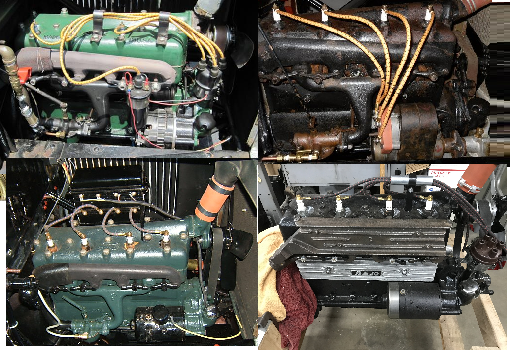

Was wondering why you couldn't put an Etimer in a Timer Elevator
just an example --
Speedsters engine looks

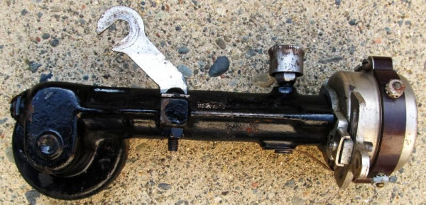

Craig. This is a Model T Ranch dizzy mounted on a Atwater-Kent drive. I think this is one of the best & most reliable dizzies out there but like a timer
mounted on the end of the cam is a PITA to work on. I should note that other than lubing the point cam & checking the point gap I have not
done anything to the one on the firetruck for 5 or 6 years.

My two cents (and probably not worth that), a speedster should have either a distributor or a high tension magneto. Speedsters were the reason many of these accessories were created. I’m all for taking these parts of collector’s shelves and putting them on a car. Is an accessory distributor or mag more or less reliable, I couldn’t say. But if you look at the old photos of nicely done speedsters that have these kinds of accessories.
Andy
Andy

TrueAndyClary wrote: ↑Sun May 19, 2024 9:40 pmMy two cents (and probably not worth that), a speedster should have either a distributor or a high tension magneto. Speedsters were the reason many of these accessories were created. I’m all for taking these parts of collector’s shelves and putting them on a car. Is an accessory distributor or mag more or less reliable, I couldn’t say. But if you look at the old photos of nicely done speedsters that have these kinds of accessories.
Andy
