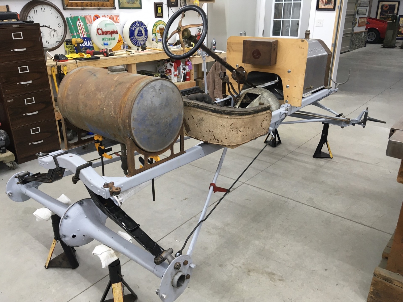

Posts: 3736
Re: You tell me
Post by Dollisdad » Sat Sep 30, 2023 9:09 pm

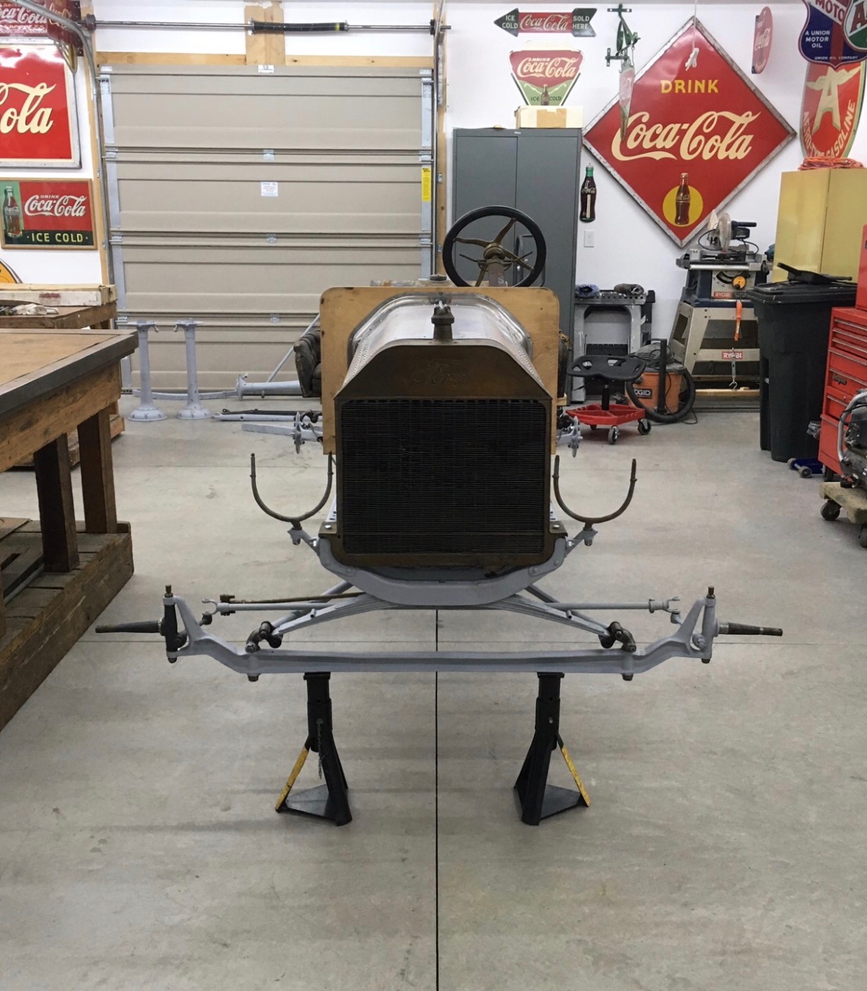

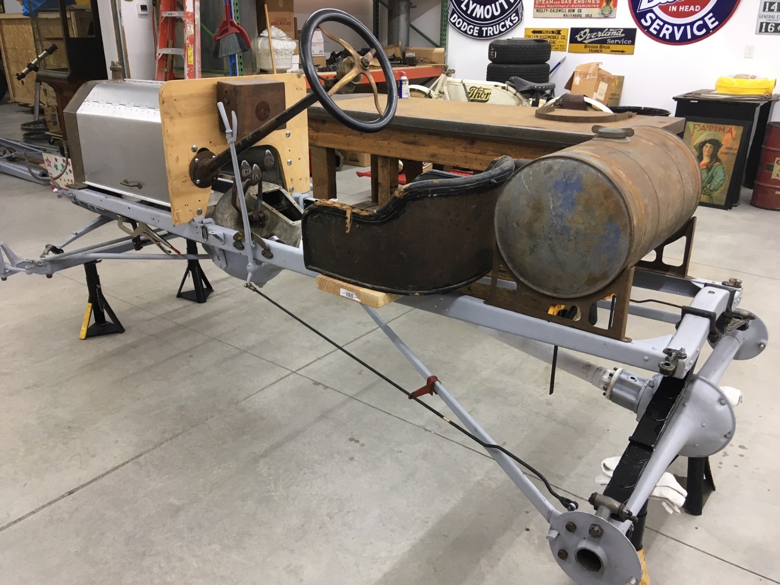

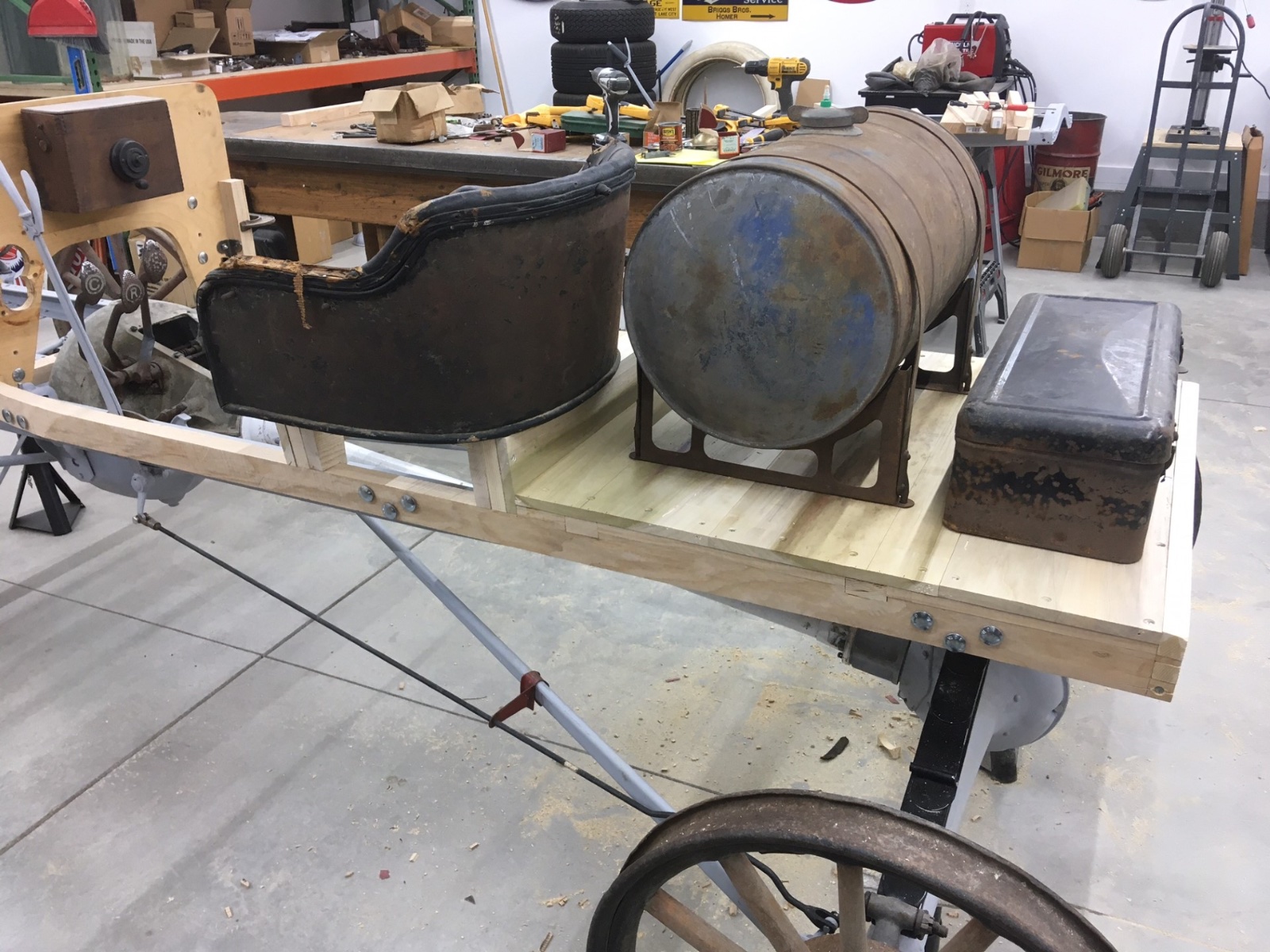

Well, I moved this to Ohio and have started to place some parts on the chassis to get a feel for what to do for a body. I like the basic feel of the spacing, but it needs a body platform of some type. Step in or step over. Flat dash or scuttle cowl. Tool box or ? on the tail end. Suggestions most welcome.

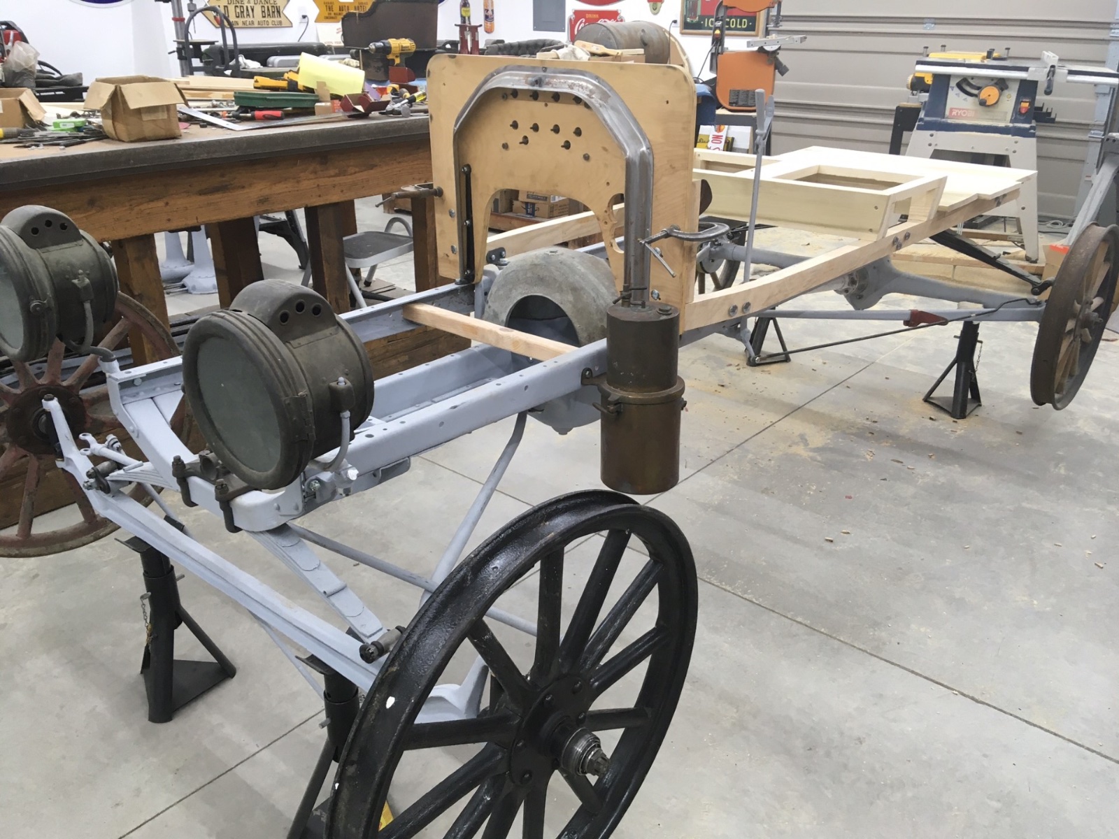

Posts: 3736
Re: You tell me
Post by Dollisdad » Sat Sep 30, 2023 9:10 pm
Posts: 3736
Re: You tell me
Post by Dollisdad » Sat Sep 30, 2023 9:11 pm

A simple floor/platform, cut down the firewall a little bit? I like it! Speedsters aren't supposed to be great travel vehicles, lack of luggage space an all? Although certainly Ed and Karen Archer would disagree with that!
What is the reason to be given for the long hood? You could have a six cylinder model T engine built for it? (Something I always wanted to do?)

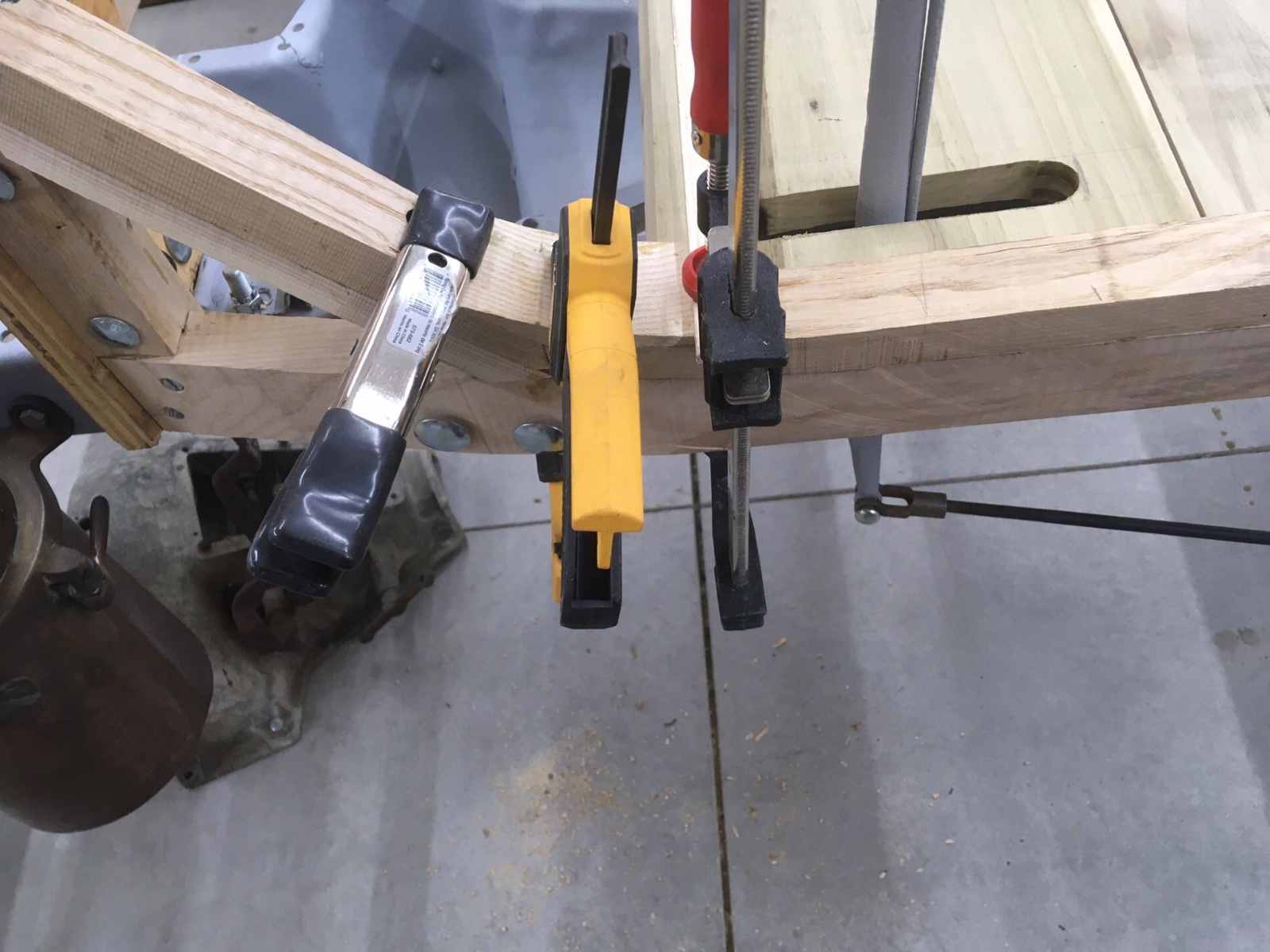

Posts: 3736
Re: You tell me
Post by Dollisdad » Thu Jan 11, 2024 12:47 am

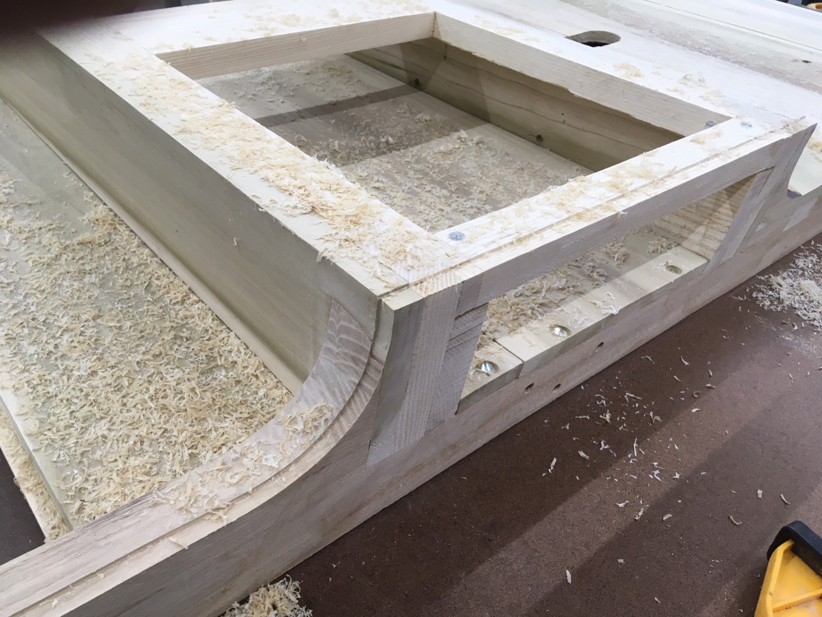

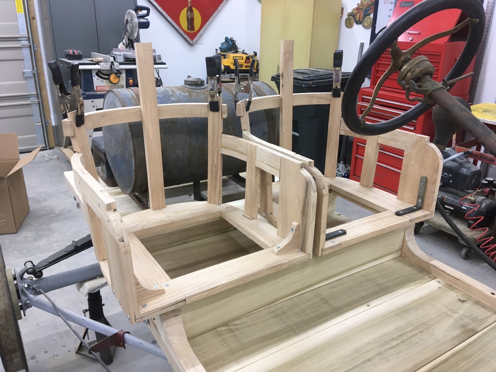

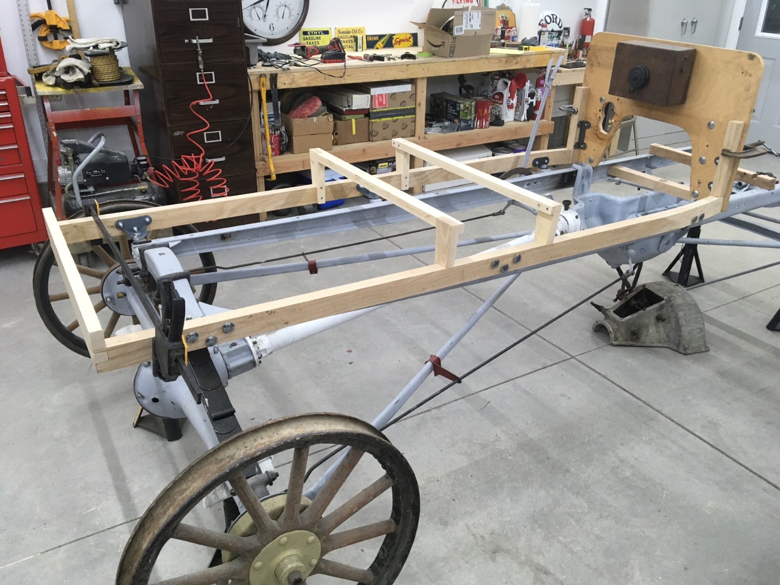

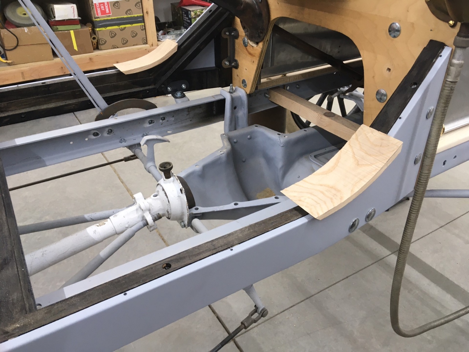

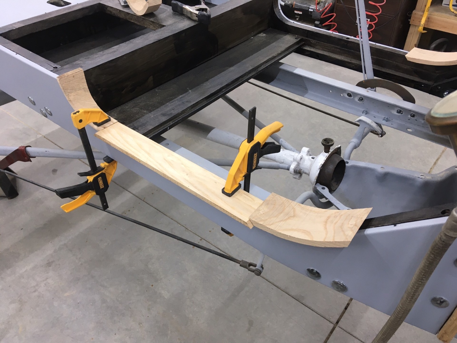

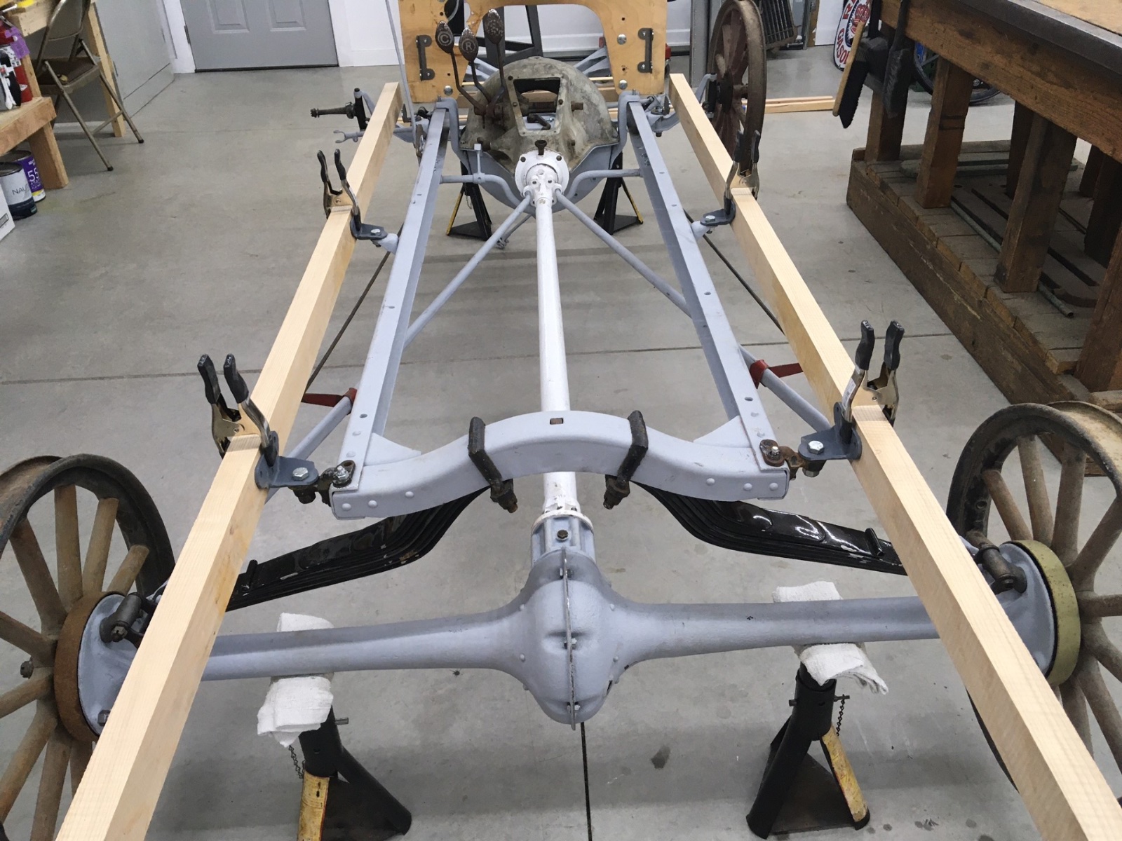

I decided to go along these lines.
So I ripped a pair of stringers 2 1/4 x 1 1/2.
Glued in pieces to reach the body to firewall brackets.
Cut curve in front and drill body mounts.
Posts: 3736
Re: You tell me
Post by Dollisdad » Thu Jan 11, 2024 12:56 am
Look at mock-up positions.
Start seat riser after cutting 7 degree taper along outside of stringers and riser.

Post by Wayne Sheldon » Thu Jan 11, 2024 2:16 am
Looks like you are heading in a good direction! Even if you hide a stock engine under that long hood, it would be a great speedster and a lot of fun!
It is a personal thing with me. I like to see earlier engines in early looking speedsters. And I tend to prefer them kept closer to their apparent era. But that is silly me.
But it is your car! Do what makes it most enjoyable to you.

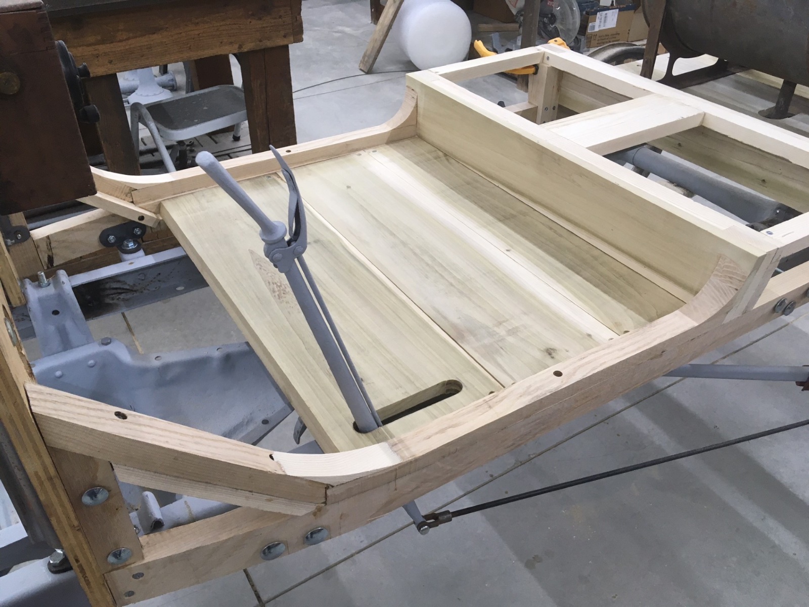

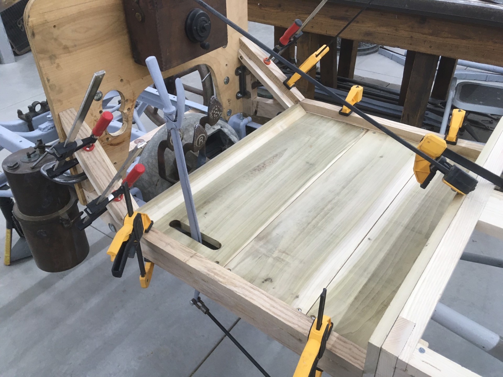

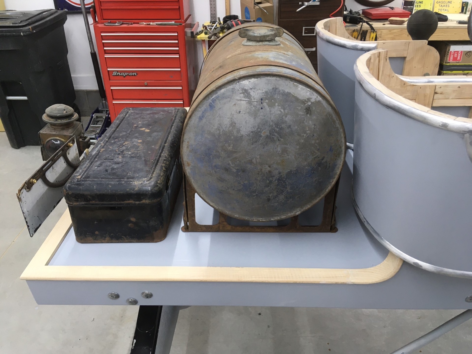

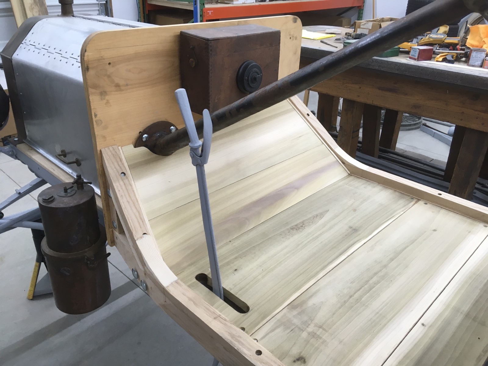

Post by Dollisdad » Sat Jan 13, 2024 11:14 pm
Set the supports for the gas tank.
And closed the ends of the seat riser.
Start to put floor on rear deck.

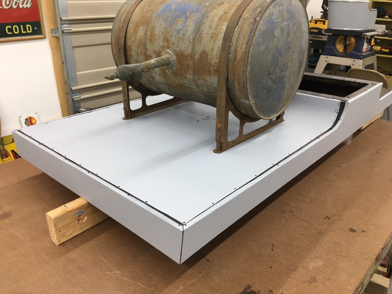

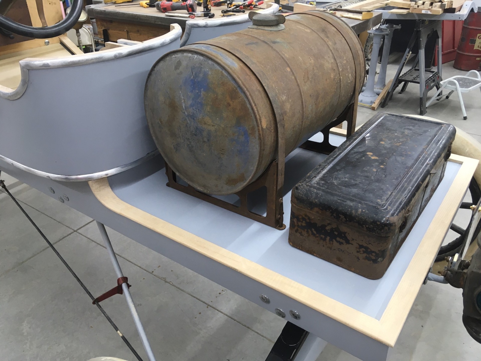

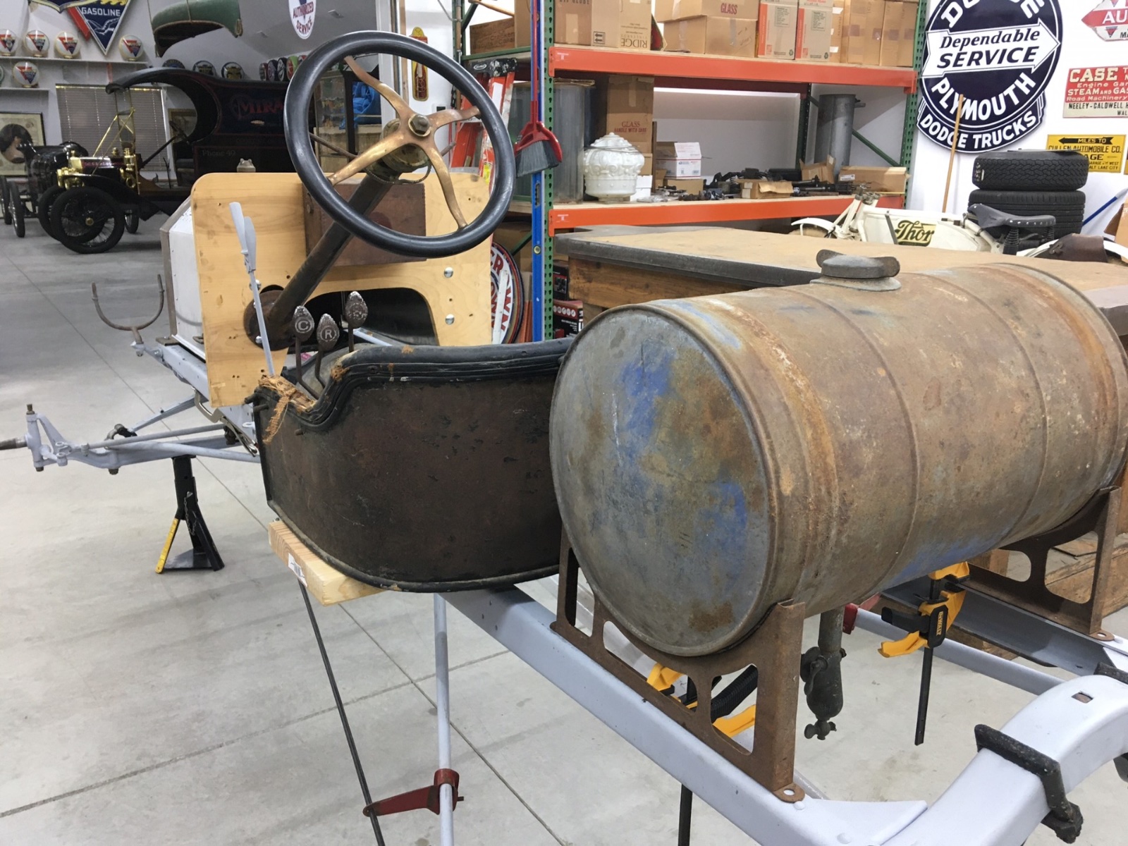

Posts: 3736
Re: You tell me
Post by Dollisdad » Sat Jan 13, 2024 11:23 pm
Drill mounts for gas tank.
Finish deck and end cap.
Drill mounts for tool box.
Posts: 3736
Re: You tell me
Post by Dollisdad » Sat Jan 13, 2024 11:25 pm
I think it’s getting there.

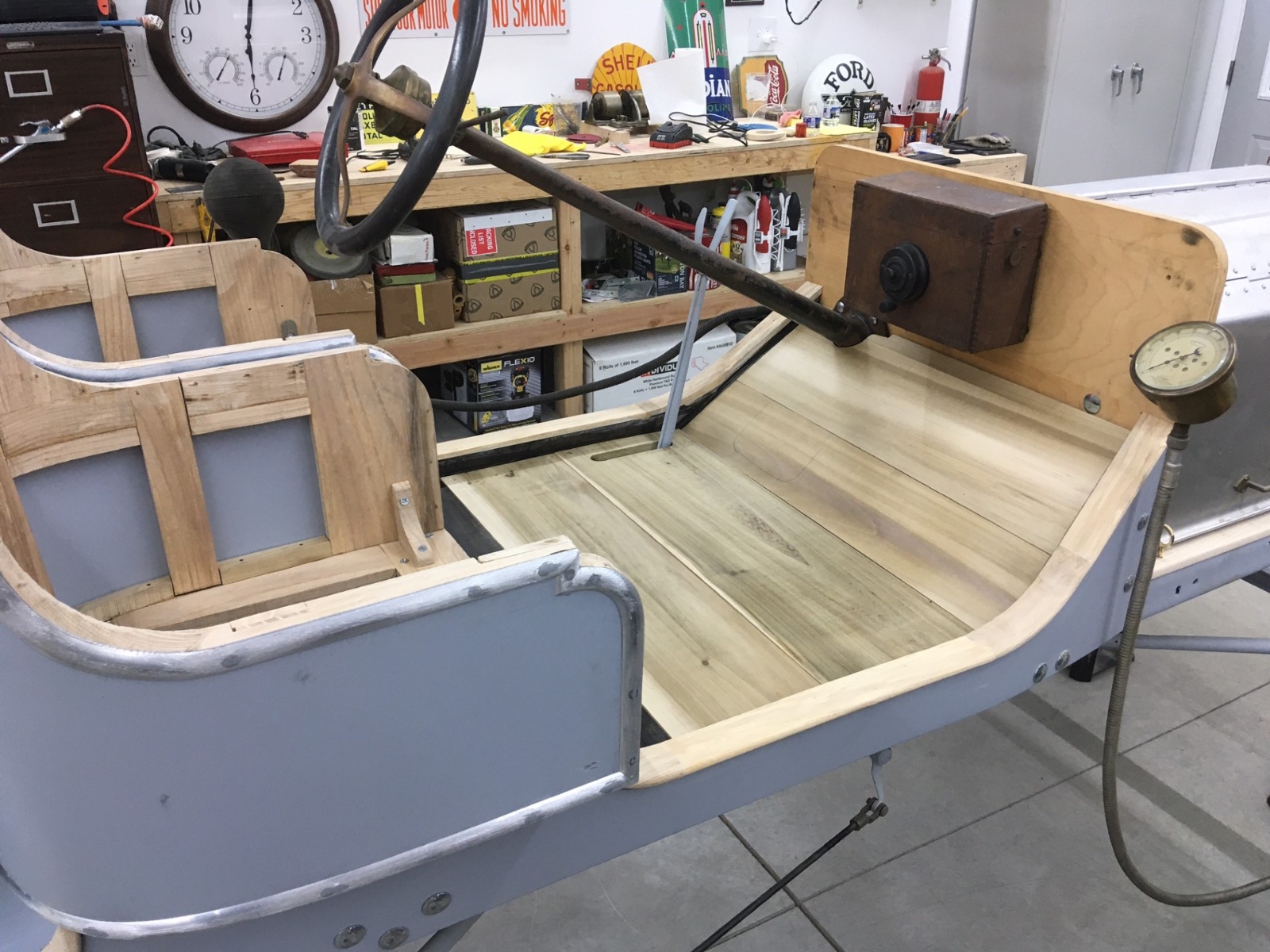

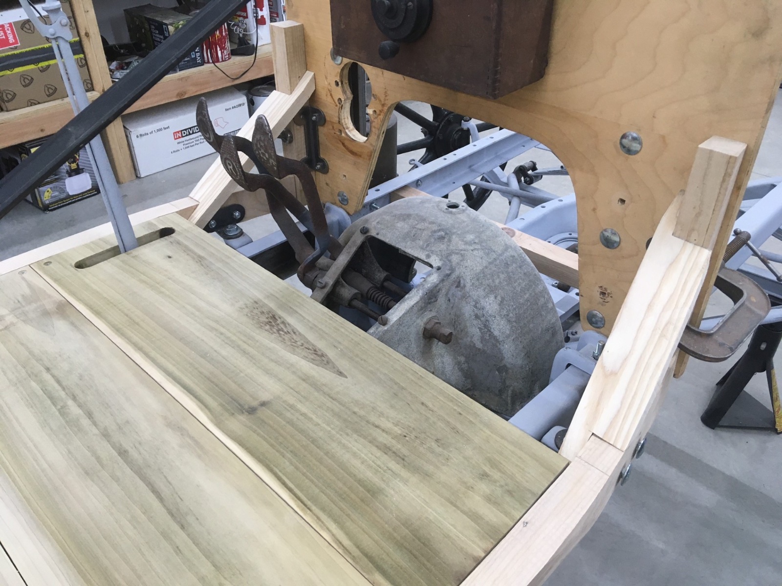

Posts: 3736
Re: You tell me

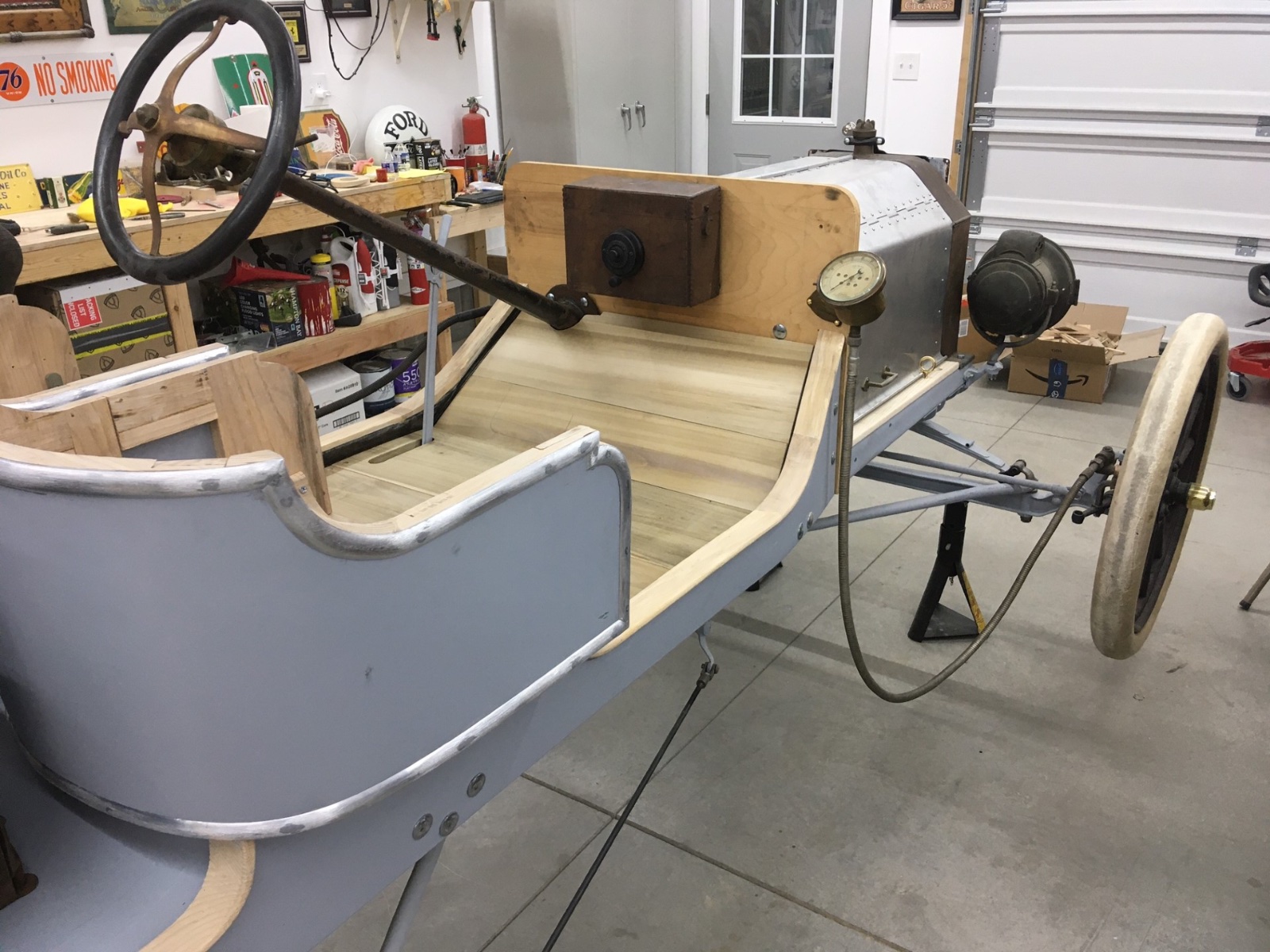

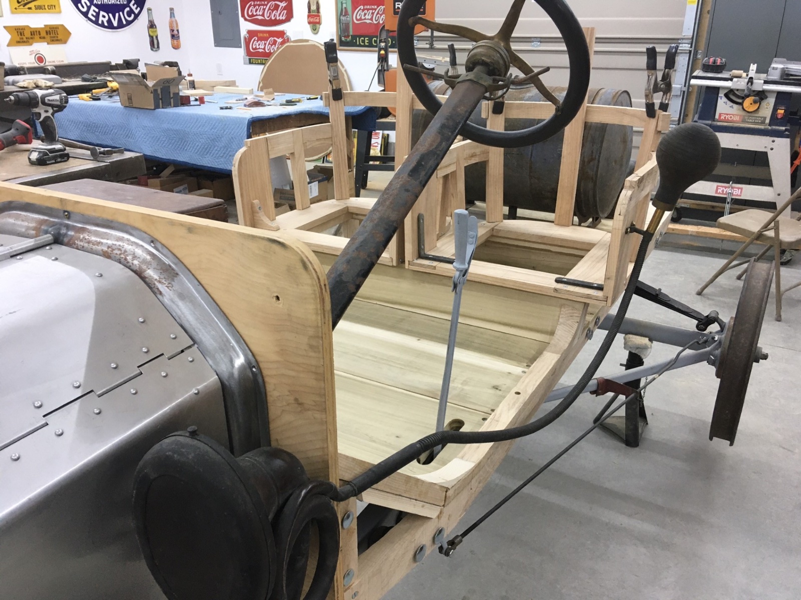

Post by Dollisdad » Sat Jan 20, 2024 1:44 am
Set the floorboards.
Set the risers.
Set the sill caps.
Posts: 3736
Re: You tell me
Post by Dollisdad » Sat Jan 20, 2024 1:56 am
Set the corners.
And forward sweepers
A little clean up,
Posts: 3736
Re: You tell me
Post by Dollisdad » Sat Jan 20, 2024 2:10 am
and I’ll make the upright floorboards when I get the pedals reshaped.
All the framework is Ash and the deck,floorboards,heel and back panel are poplar.

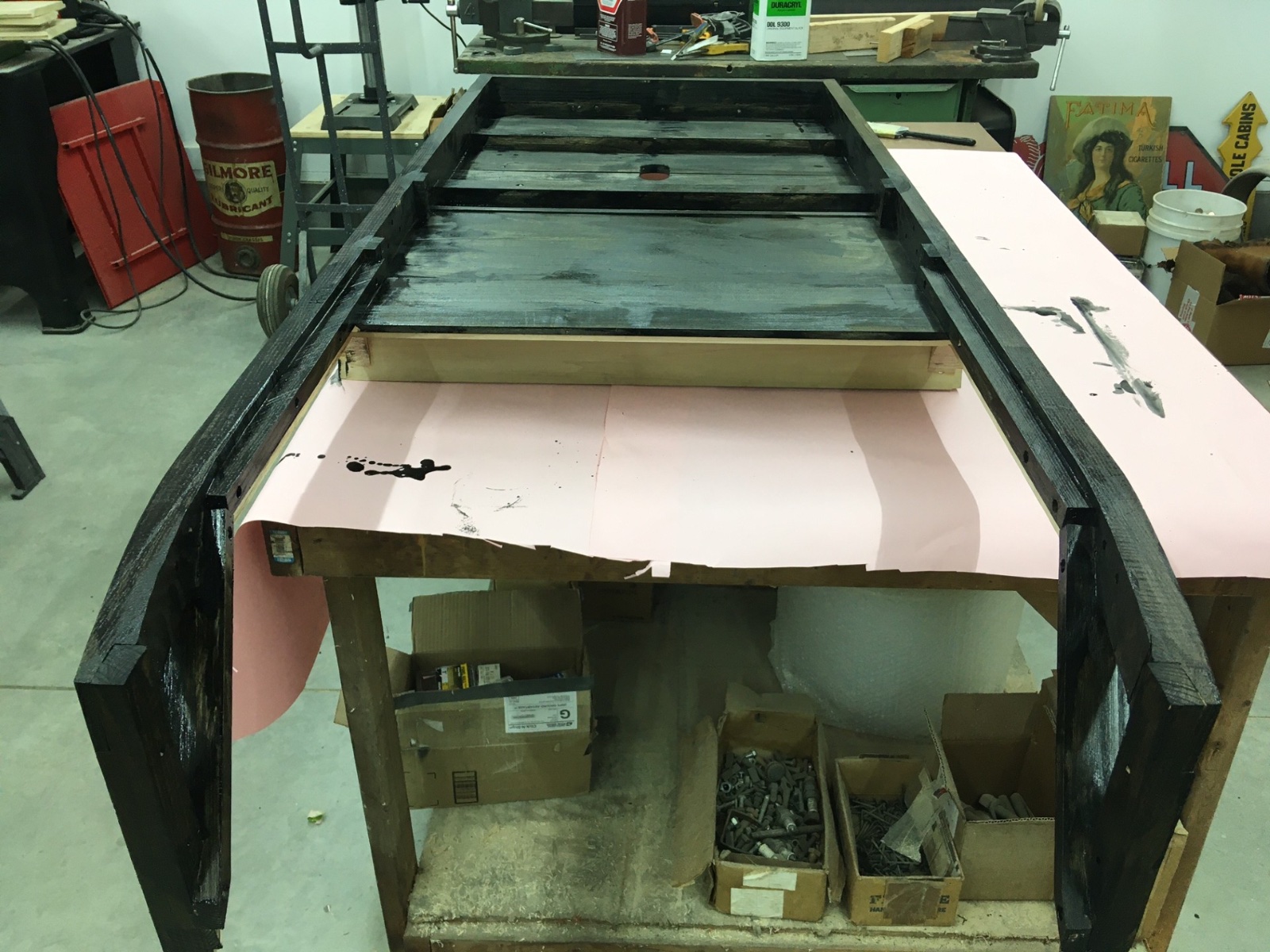

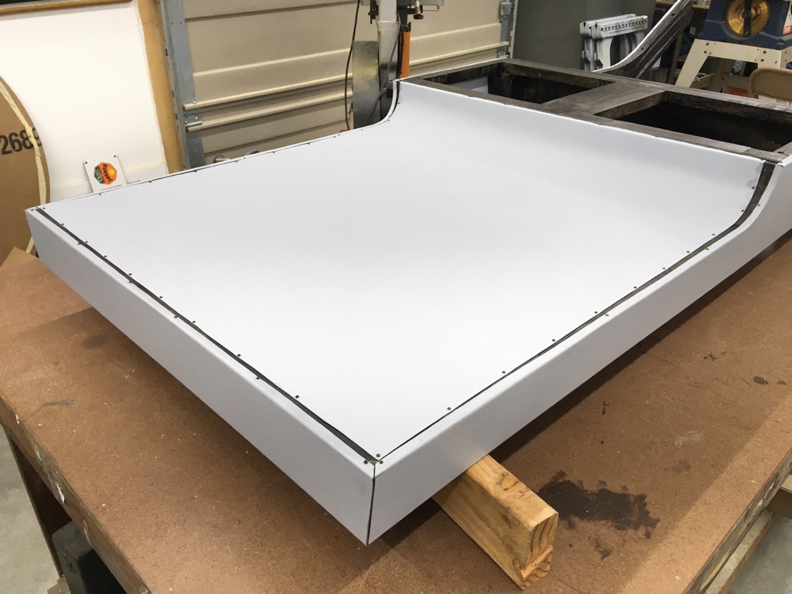

Posts: 3736
Re: You tell me

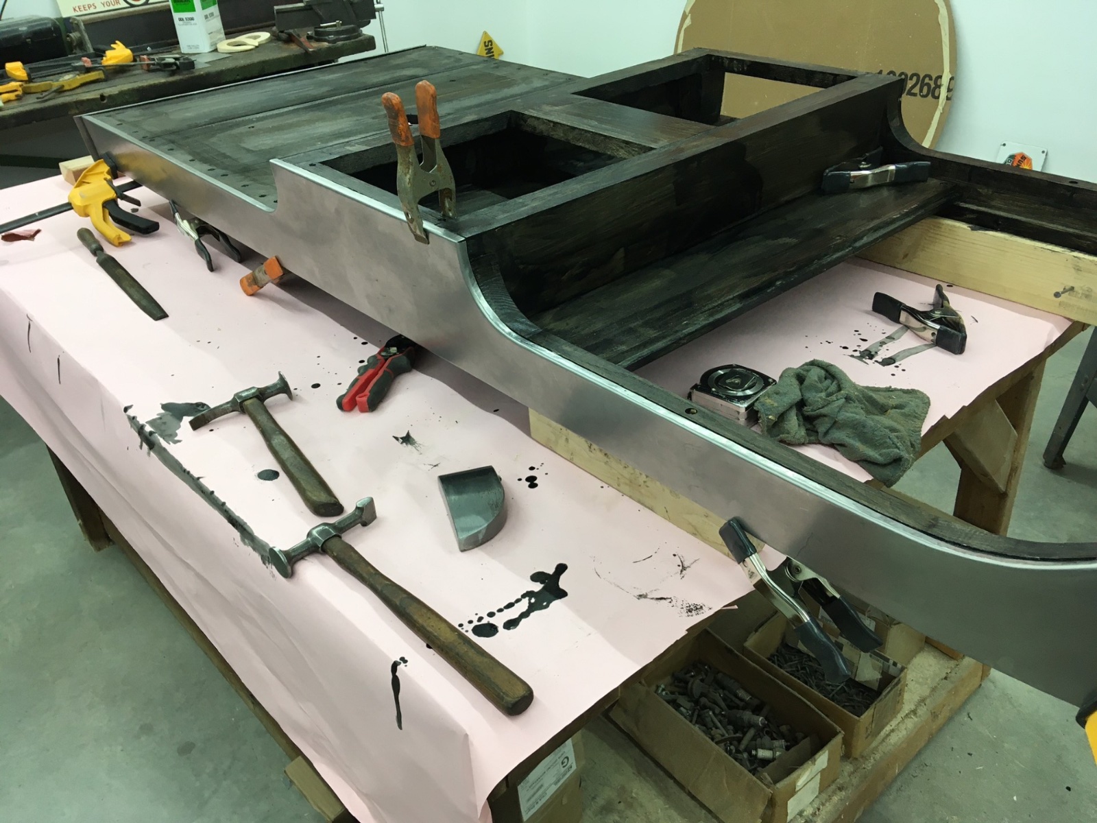

Post by Dollisdad » Tue Jan 30, 2024 11:43 am
Floor and hood sills done.

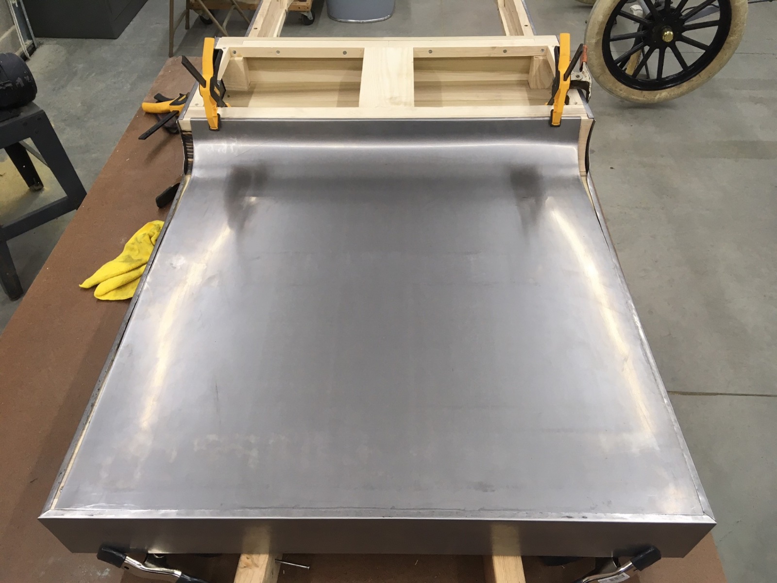

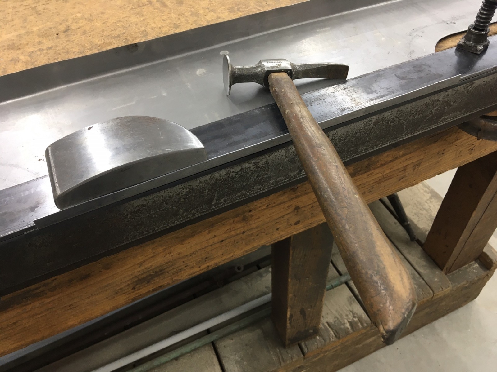

Now I need to find someone with a 8’ brake so I can start to skin the deck. In the meantime I’ll start to build the frame works for the seats.

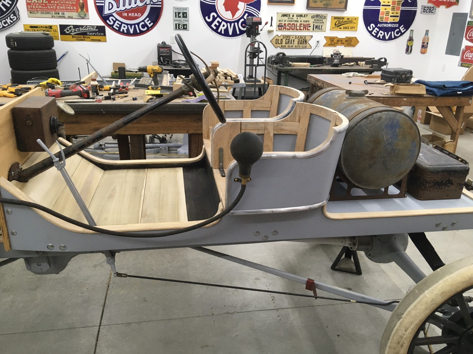

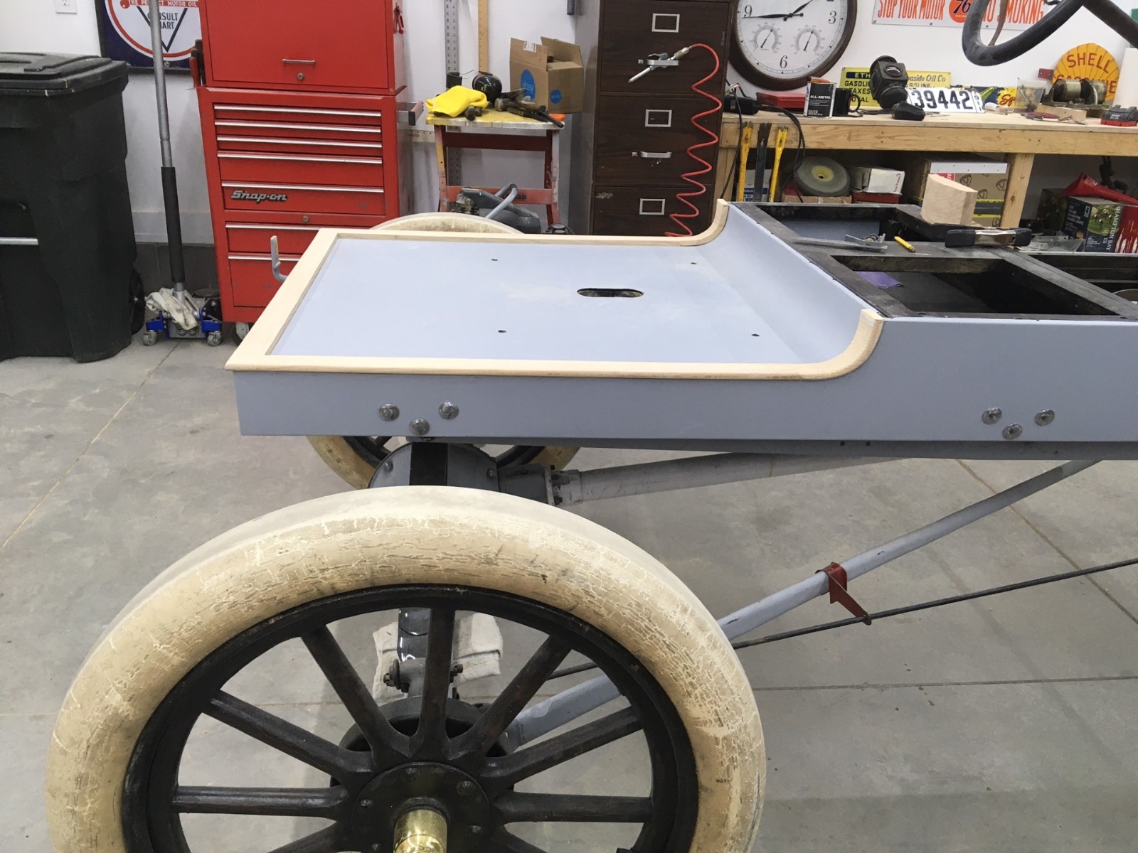

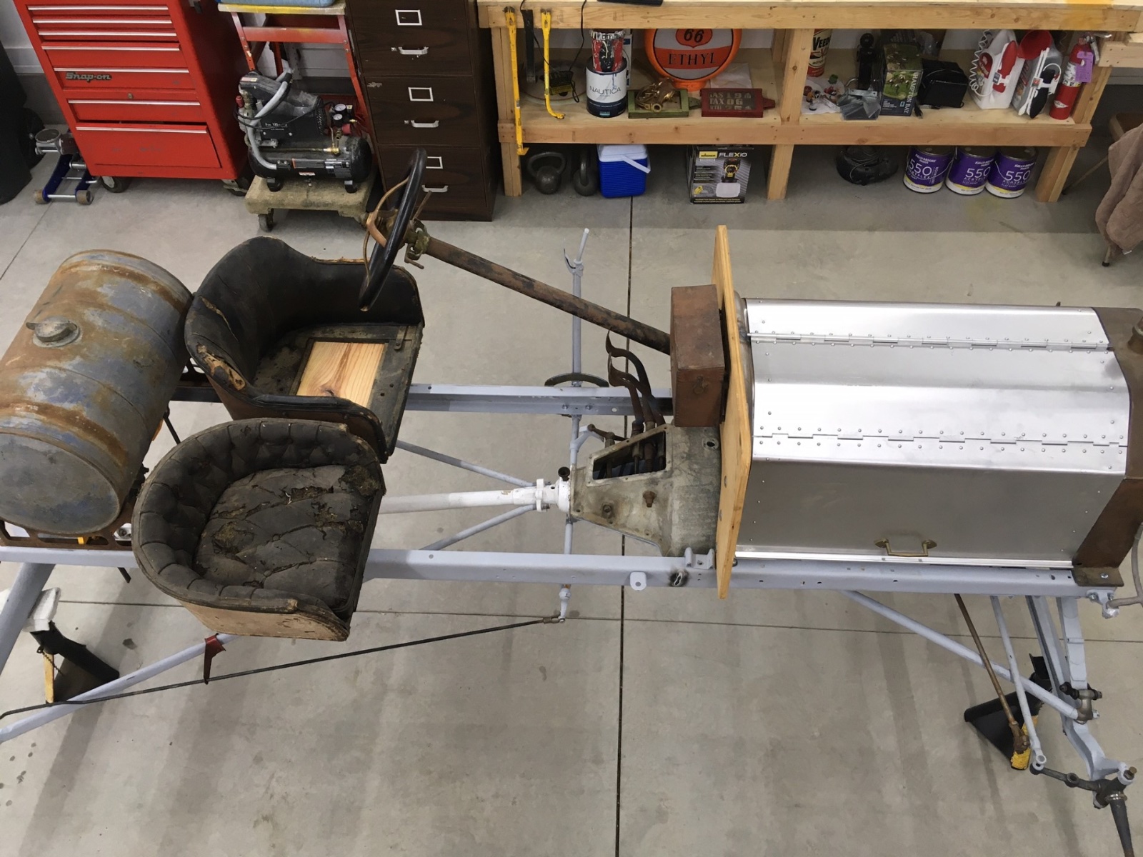

Post by Dollisdad » Thu Feb 08, 2024 6:33 pm
Making progress on seats
Tbird
Posts: 1274
Last Name: Bird
Location: Goshen IN
Re: You tell me
Post by Tbird » Fri Feb 09, 2024 12:38 am
Great progress Tom! It's coming together. Love the frame mounted carbide generator!

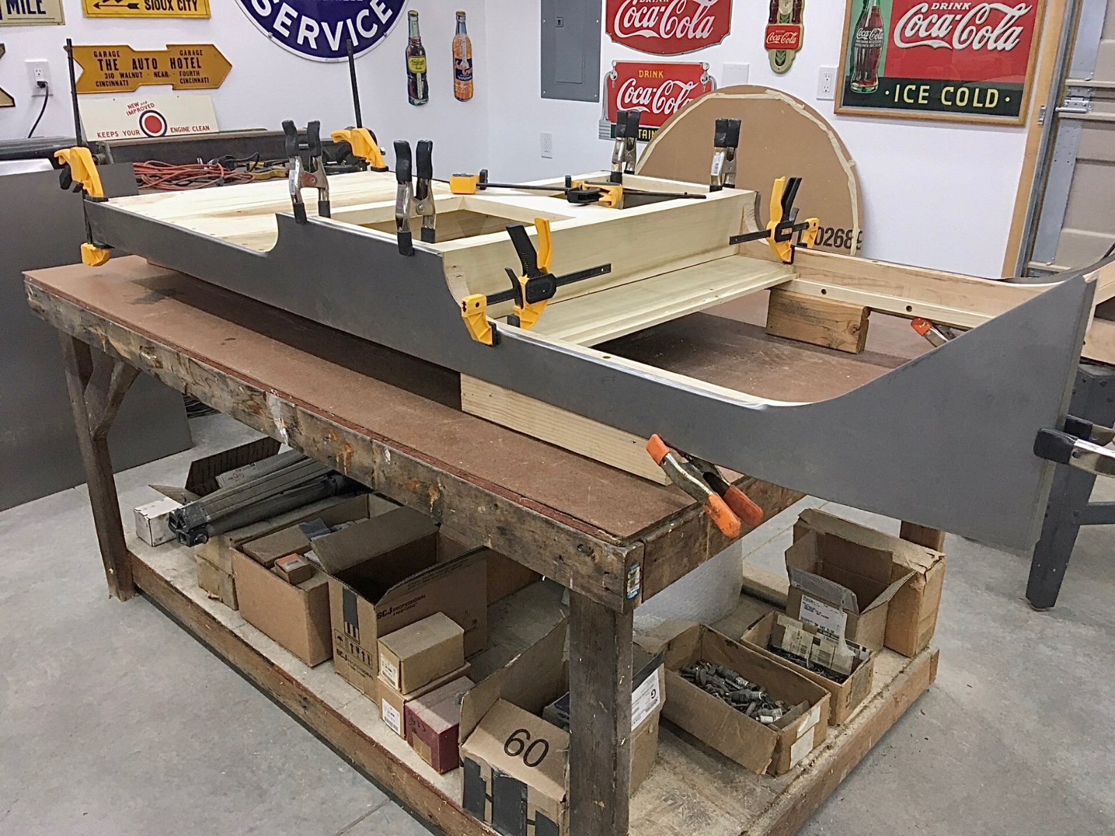

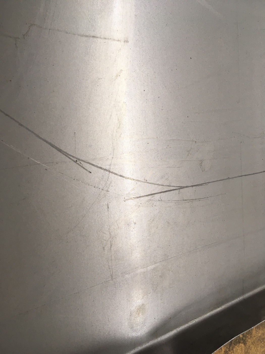

Posts: 3736
Re: You tell me

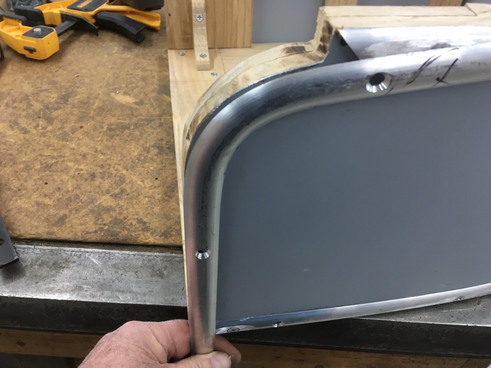

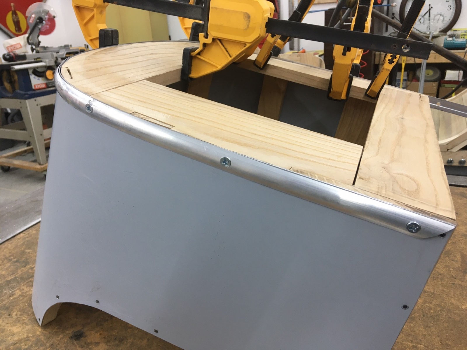

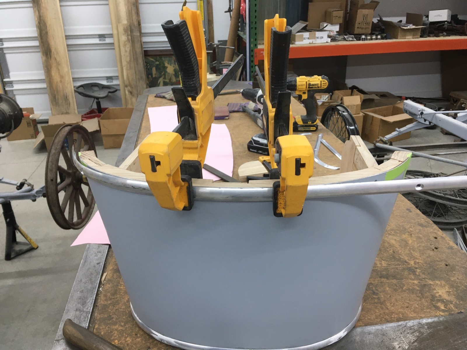

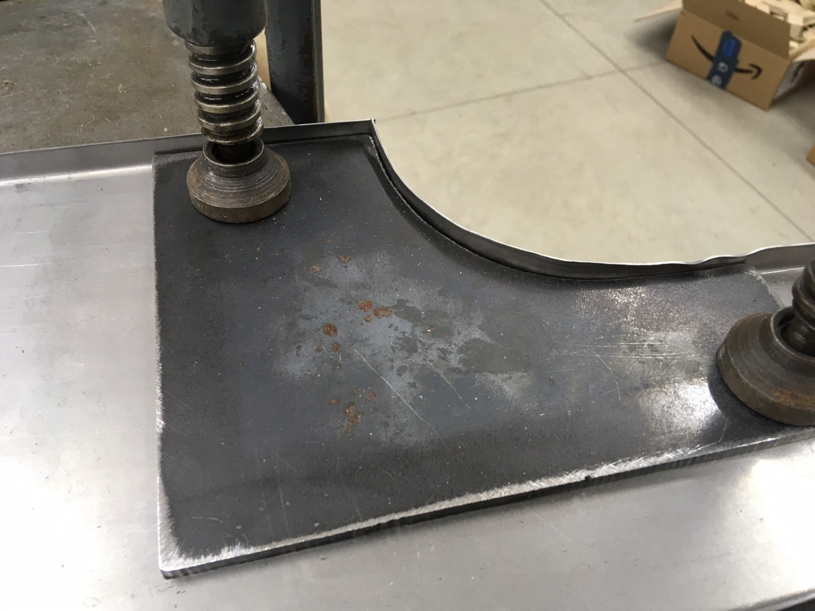

Post by Dollisdad » Wed Feb 21, 2024 6:55 pm
Seat frames done
Pulled patterns and transferred to sheet
Cut out skins adding 1/16” to allow for misalignment on my part,

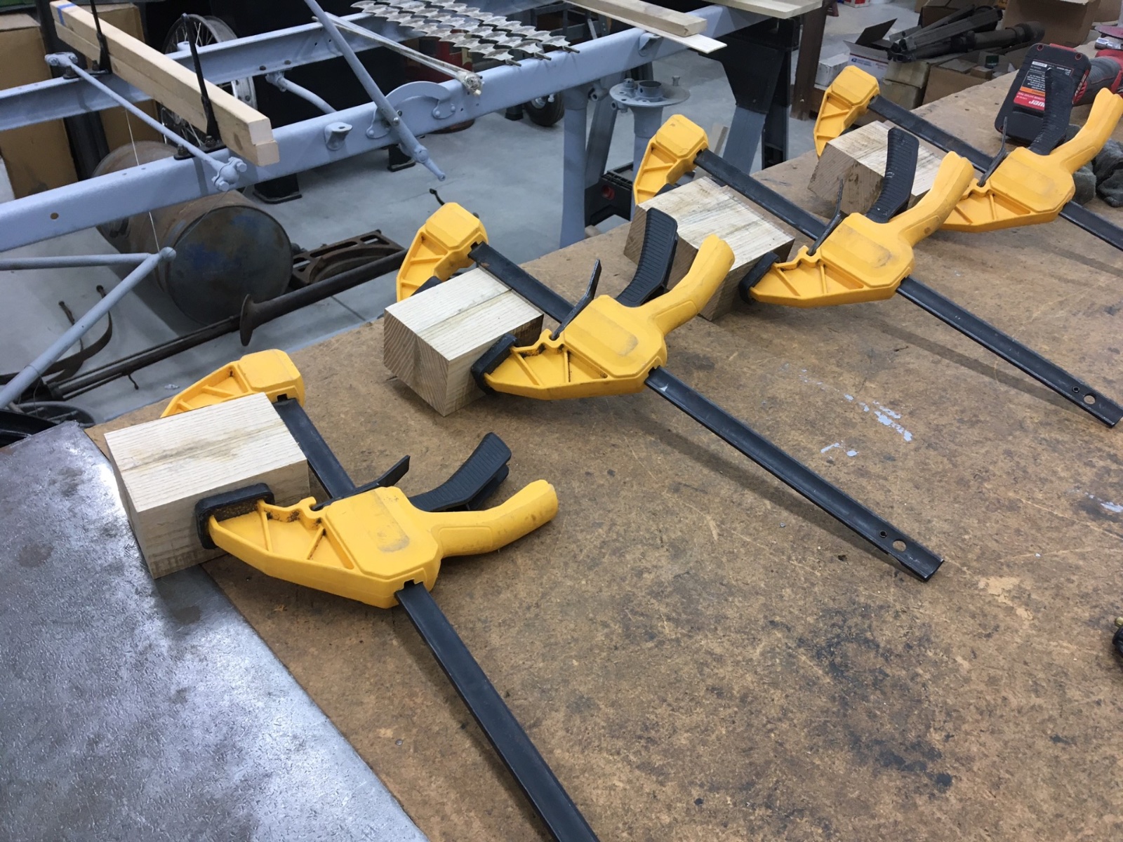

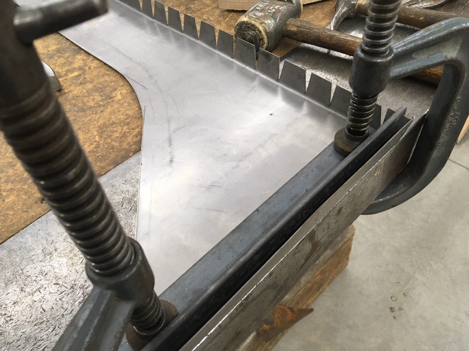

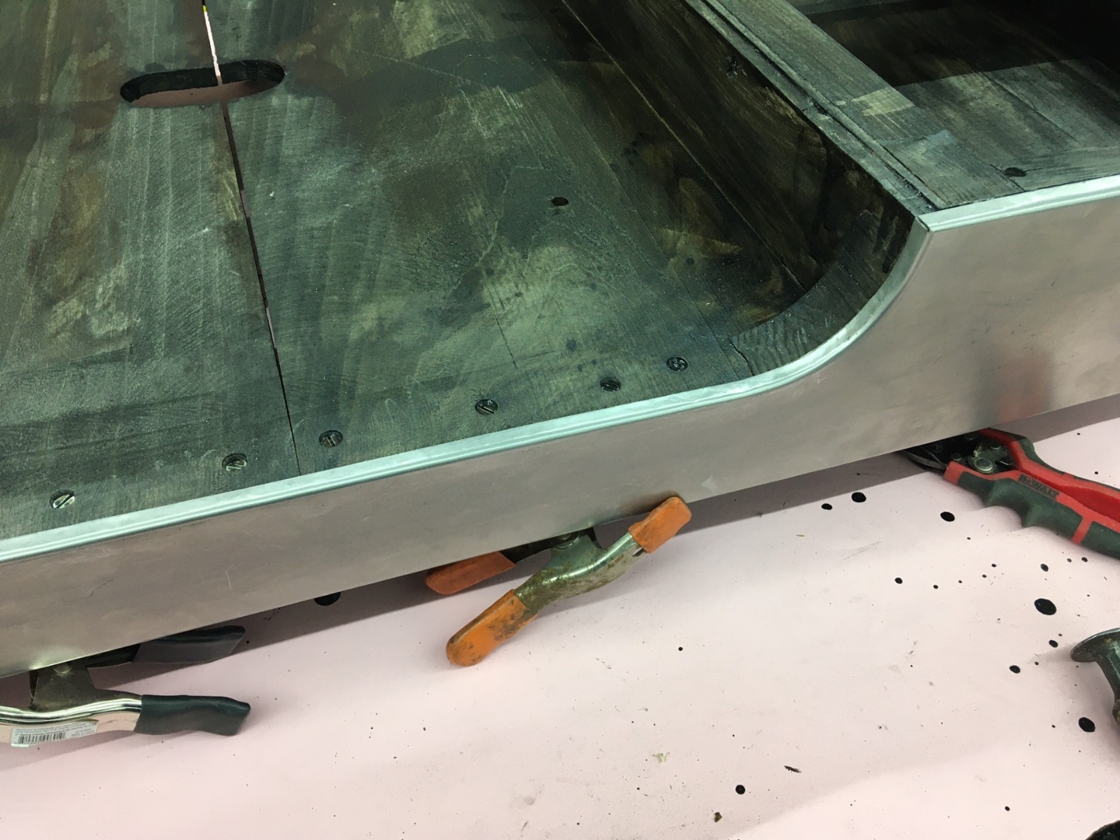

Posts: 3736
Re: You tell me
Post by Dollisdad » Wed Feb 21, 2024 7:01 pm
Clamped skin to the frame on one end and pulled it around and clamped as it made contact. Pretty happy with the trial fit. Material is 20 ga. cr.

Post by Wayne Sheldon » Wed Feb 21, 2024 8:40 pm
Very nice workmanship! Going to look wonderful.

Looks better than the last time i saw it! Nice work on the sheetmetal, who did it? just joking!

I really like your choice of the body design. I always wonder how seats like those are fabricated ever since I saw Tim Wrenns former 1912 pickup truck.
Very nice design snd work. I'm anxious to see it went complete and on a tour.

Beautiful woodwork. Poplar?
Posts: 3736
Re: You tell me
Post by Dollisdad » Thu Feb 22, 2024 11:50 am
Jim, all the floorboards are poplar. The deck and seat skeletons are ash. Here in Ohio, on Facebook marketplace there are quite a few people who process and sell rough cut lumber off their own land or others. So I’ve been buying 6/4, 5/4, and 4/4 rough material, so I can plane it to my needs. Ash is getting harder to find due to the Emerald ash borer which has destroyed millions of ash trees. You can buy green if you have the time to air dry and save money. Otherwise kiln or aged works best.

I drill two holes at the center bottom and countersink them to better sink the nail heads. Then center the skin best I can and proceed to nail the skin on.
The left side came out pretty good.
The right side not so good. My misalignment.
So I had to grind the sheetmetal down to the wood. That’s why I oversize the skin.
Posts: 3736
Re: You tell me
Post by Dollisdad » Thu Feb 29, 2024 9:05 pm
Then I put the moulding around the bottom after I anneal the rear portion of the moulding.
And around the top.
Then form the front corners around a front wheel hub.
Takes around 4-5 times annealing to get it to form. It will buckle and you have to tap it flat between annealings, but it comes out flat in the end.
Posts: 3736
Re: You tell me
Post by Dollisdad » Thu Feb 29, 2024 9:18 pm
And fits pretty good.
Then bent the up swings. I use the paper pattern I pulled for the skin as a template. I made a wood buck to bend them around as I could not find anything the right shape. You see where I have scribbled on the moulding with a sharpe. That is the area I want to anneal. So using a hand held torch I evenly heat that area until the markings disappear. Then it is ready to bend. Like I said it will take 4-5 times to complete the curve.
Posts: 3736
Re: You tell me
Post by Dollisdad » Thu Feb 29, 2024 9:36 pm
This is what I use to anneal.
Ready to cut the angle.
Almost done.
What was leftover from 24ft. of moulding.

So time to skin the body. I start by routing the edges where I want the sheet metal level with the wood.
Posts: 3736
Re: You tell me
Post by Dollisdad » Thu Mar 21, 2024 9:06 pm
Cut the blank for the side.
Since I don’t have a 8’ brake at home, I sandwich a 1” flange between two 3/16” strips and knock down with a rawhide hammer, checking to see it is approx. 7 degrees short of 90.
Then clamp it to the woodwork.
Next I scribe the edge of the woodwork.
Posts: 3736
Re: You tell me
Post by Dollisdad » Thu Mar 21, 2024 9:19 pm
Then I add 3/8” to the scribe lines.
I use an electric hand shear to cut out the part.
Using the strips I knock the straight stretches up with the rawhide and then straighten the edge with a steel face hammer and dollie.

I pie cut the bottom so it will sweep inward at the front and bend the end cap.
Next I test fit the panels on the skeleton.

Post by Dollisdad » Sat Mar 30, 2024 7:00 pm
Got the tail panel made.
Next knocked down a 3/8” flange and clamped a 4” pvc behind it and pulled the sheetmetal around it to give it the upsweep.
And check rough fit.

Took the sheetmetal off and sealing the woodwork with black lacquer.
Now waiting for plates from the steel guys.

Post by Dollisdad » Tue Apr 09, 2024 7:13 pm
Ok, well I got the corner plates finally. Clamp them in place and knock the material up.
Then fit the finished panels.
Posts: 3736
Re: You tell me
Post by Dollisdad » Tue Apr 09, 2024 7:22 pm
Then acid treat and prime the panels.
I routed the rear corners and inserted small corner shields to back up when I weld the corners shut.
Then start to nail panels on starting with the bottom.
Posts: 3736
Re: You tell me
Post by Dollisdad » Tue Apr 09, 2024 7:34 pm
Then do the topside.
When I put the rear deck top piece on I shoot some liquid nails under it to kill any noise that may arise from rpm vibration
ThenI bolt the tank down to press the skin to the framework. I will leave this now fora few days to make sure the bond has cured.
Posts: 4344
Re: You tell me
Post by Wayne Sheldon » Tue Apr 09, 2024 9:29 pm
Is that the gasoline tank you are going to use there? Just curious, it would look great!
Wonderful, beautiful, work you do!
Thank you for sharing it here.

Post by Dollisdad » Fri Apr 12, 2024 11:16 pm
Thanks for the comments. Installed the inbody mounting brackets and slid the deck back on the chassis. I must have mixed the brackets up, as some didn’t want to line up easily so I had to rework them All the 3 hole bracket bolts had to have the heads bent to flush fit the side of the body.
Welded up the rear corners, cut the tank opening and now it’s ready to make the trim pieces.

Post by Dollisdad » Wed Apr 17, 2024 9:23 pm
Well, I think that the fabrication is pretty much done (seat bottom doors still to come). Still some work on the front and rear suspension to adjust the ride height and steering connections. I’m going to try my hand at upholstery and I’ll take pics, good or bad and share them later. But for now here is a look at the final vision that you guys helped steer me to. Thanks for the words of encouragement and I hope you learned something that can help you on your project.
Posts: 3736
