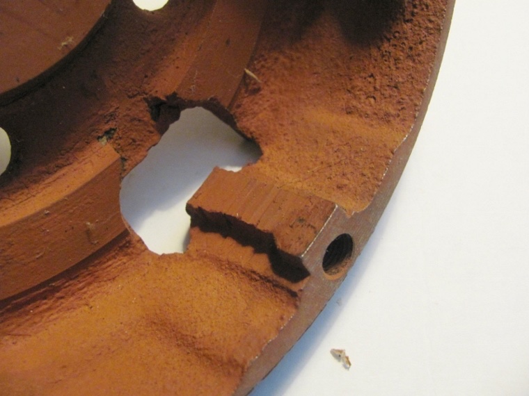

Post by DanTreace » Fri Mar 01, 2024 4:34 pm
As others, the lug boss is rather narrow to begin with on the small brake drum. Ink mark shows what might be needed to cutaway to install the replacement lug.
Then again, the lug may look like this! Hardly anything left to cut on.
