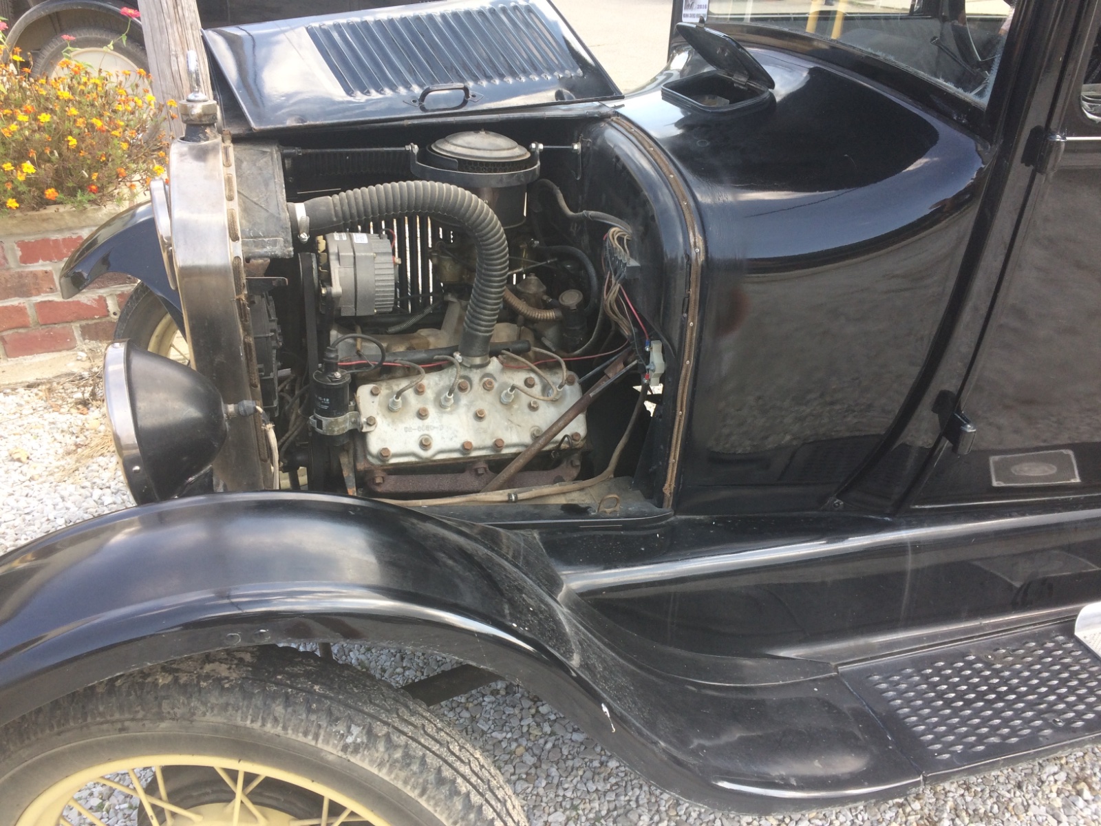

I'd like to put a 60 HP Ford V-8 engine and transmission in a 26 or 27 T.

Why Pat ? If you want a hot rod, go for a ‘56 Chrysler hemi

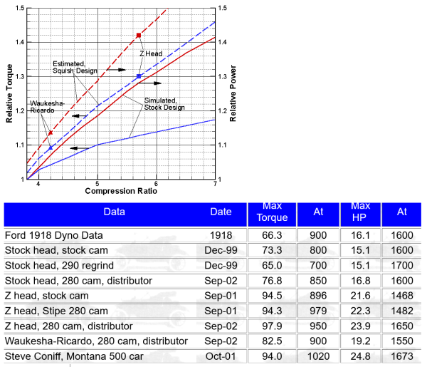

A Model T has some inherent limiting factors in an effort to acquire a higher rate of speed. One is the stock Model T engine's internals that were not intended to achieve RPMs much above 1800. Other's include aerodynamics (windshield), rear axle gear ration, suspension, and its ability to stop. So the relationship of engine RPM to rear axle gear ratio is what determines top end speed
This link explains what can be done and what the resulting gain is
https://mtfctulsa.com/Tech/power_and_torque.htm
Stock engine Spec's
177 cubic inches - 2.9 litre (2900cc);
Engine Horsepower 20-22 BHP @ 1600 Maximum RPM
Engine Torque 83 Ft-Lbs @ 900 RPM
Top Speed Approx. 45 MPH, normal cruise 35 - 40 MPH
Engine RPM@Speed 1400@35 MPH, 1600@40 MPH, 1800@45 MPH
Simple way of thinking (somewhat)
Torque is what gets the car moving from a stop; accelerates the vehicle onto the freeway; allows the vehicle to do more work, like pulling a trailer.
Horsepower is what allows the car to climb a hill without slowing; push a car into a head wind and maintain speed.

The V8 60 would solve the RPM limitations, lubrication, and vibration issues associated with the T engine and transmission. The low, smooth-flowing torque of the V8 60 would not destroy the model T chassis, if handled responsibly. Cooling the V8 would be a challenge.

The z head looks like a VERY good choice for a T.
