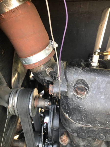

Great drive and good info. I've been monitoring my truck for temperature with a thermal gun and its running around 210 in and 145 out with the outside temp in the low 80's. So where did you install your temperature sensor for the digital?

My car was the oldest and the oldest that was driven to the show there was a 1927 T but it was a trailer queen. Steve, I drilled and tapped the gooseneck for the temperature probe.

I tried to attach some pictures of how I did it. But I can’t seem to load them. I’m not sure why.

Last try. 12345678910

I should note that no holes were drilled other than the goose neck to mount the probe

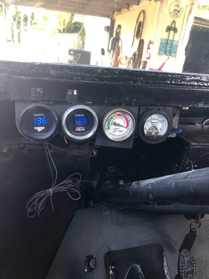

Will, thanks for showing the picture!
