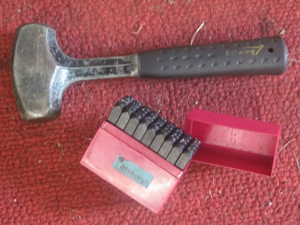

When using a set of number stamps, how much effort should be required to stamp new numbers into the block pad above the water inlet on the side of the block? I have a block that's original use was probably for a stationary engine as it has a non Ford type motor number stamped on the pad of a 1927 vaporizer block. I know its going to require a machinist's hammer or such to hit the stamp hard enough with; a carpenter's claw hammer or a light weight ball peen hammer isn't going to be heavy enough. I only want to hit the stamp hard enough to create an imprint like the factory did, and not cause damage to the block. What do those of you who have experience, recommend?

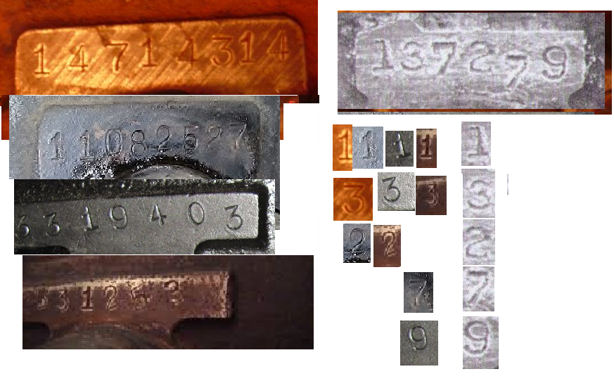

2. The stamp font should be similar to what as well. Aliment isn't to critical but reduces suspicion

We have stamped both thin data plates as well as engine blocks with serial numbers. The data plates take very little force as you will go right through the brass or zinc plate. The engine block can be done by hand with larger numbered stamps and a 2 or 5 pound hammer. We cobbled up an old socket to hold the numbered stamp die so we did not mash our fingers. Drew a felt pen line so we could be reasonably straight and hammer away.

The file drag caused a line across the boss, if you used a mill you could get a true flat boss. Then you have to choose nice fonts, I found Harbor Freight numerals to be pretty good to use. A 2.5 lb. mallet was best, but the factory guys used a machinists hammer with a wide swing, but they did thousands!
Takes steady fingers to hold the small stamp dies, and worry of hitting them with the hammer :shock: So some are more faint than others, but it sort of looked like some factory stamps, but the file line is a give away. The brass tag over was better looking and less work.

I use a 3 pound hammer and a decent swing.
