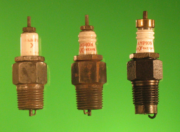

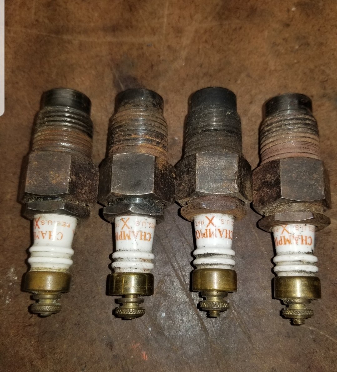

.024 to .028 should be fine for the gap. I'd use the old Champion plugs if they're in good shape.

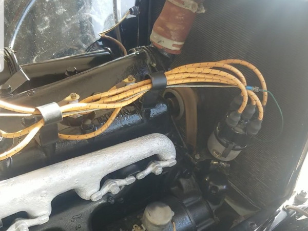

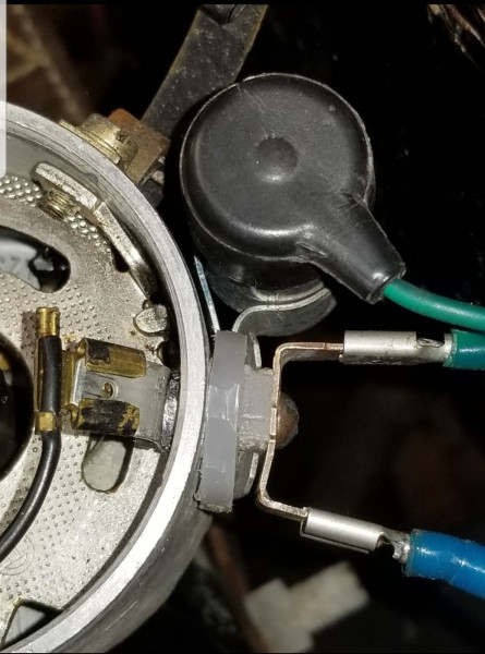

See pic. What kind of wires are these and how do I check condenser. Coil checked out ok. Dizzy, points, cap...all installed before I got the car and all were 100% new.
Old champion plugs with brass tops, 1 insulator cracked. I'll try the Champion 25s I have.

Did you do the old tried & true screwdriver from spark plug to the head test for spark to verify distributor is putting out spark?
I see a possibility of an issue with the condenser wire being in contact with the high voltage wires and having high voltage leak from the plug/coil wires to the open/exposed terminal connector, which could damage the condenser. Also possible poor connection of the terminals as well
"How to test distributor condenser" in your chosen search engine, will provide videos to test yours.

Good catch. This is on my list to change. Also how the PO has it mounted is suspect. It's on the outside of the distributor and wires going into the distributor and loose and wrapped in electrical tape. I need to address this next.RVA23T wrote: ↑Sun Feb 25, 2024 11:38 pmDid you do the old tried & true screwdriver from spark plug to the head test for spark to verify distributor is putting out spark?

Appears to be an older Bill Rader distributor set-up - uses a Bosch 009. Does it utilize a "bell crank" assembly for spark advance ? Meaning 2 spark
rods & a bell crank ?
Point gap 018 - .020 - with a distributor ignition, I run my plugs at .032 - .035.

My 26 T came from the PO with a distributor that looks very similar to the one in your picture. The housing on mine is stamped with the VW insignia followed by a 9 digit number followed by a C and was used on '60's &'70's Beetles. I matched tune up parts with NAPA and came up with cap # EP274, points # CS313 rotor # EP278 condenser # EP 259. I set points at .022. Worked good for me.

Bosch distributers have a resistor in the rotor for noise suppression, they are prone to failure. They can be a pain to diagnose because the appear
to be good when testing then fail when starting or after running for a while. If your car has a Bosch dizzy it is a good idea to have a extra one.
Rotors can be hard to find @ the local auto parts place. There also is several different ones that look like they interchange but don't.
Craig.

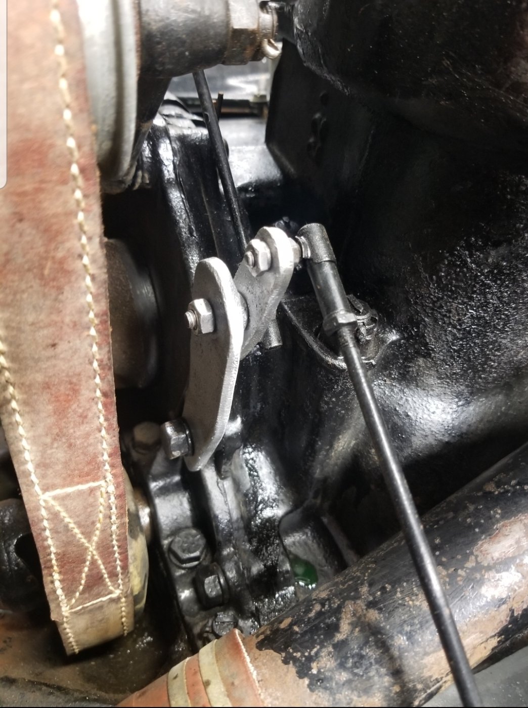

Is this a bell crank, 2 rods?
- Posts: 5499
Re: Spark plugs
Yes it is Vincent - looks like a Rader unit.

I'd look over the wiring very carefully. The primary wire in the picture looks skinny to me. Quality, full-gauge wiring with quality terminals will give best performance and reliability. Worn switches will make for weak ignition performance and increase the probability of intermittent performance.

I redid some the wiring. Inside of the cap, was a female lead from the points. Through the hole in the side of the distributor body was a wire from the capacitor and another lead from the coil. These bare wires were pushed into the female connector, smashed closed and electrical tape covering them. You can see evidence of the glue residue from the tape in the pic. I straightened out the terminal.
The lead from the capacitor and from the coil was sectioned together in pieces. This has also been resolved.
I then fabricated an insulator block with male spade terminals and put the proper female ends on them. Just so I wouldn't have wires going into the hole. I'll been 3D printing a new piece now that I know this works.
I tried to restart and still nothing. I'm going to see if I have fuel issues next. It was good but I might have some stickiness with the float or needle or both.

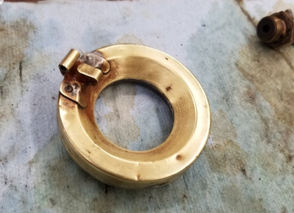

Needle and seat replaced and it fired right up. Carb flooded with gas though and not sure why. When it ran because I had no gas issues.. Then the Needle stuck. Now new needle and it's acting like the float has sunk.
This is the float I have. I had it floating in a bowl of mineral spirits. I'll try and figure it out this week.

Get a small sauce pan on the stove a little better than 1/2 full & turn on the stove - set the float in the water and hold it down with a wooden spoon just before it stars to boil & watch for bubbles.
- Posts: 4400
Re: Spark plugs
Did you reset your float level after replacing the needle & seat? Just going by what I'm seeing in your pic, it appears that the little tab that pushes on the needle is bent down kind of far. If that's true, it would cause your flooding problem. Roughly speaking, the needle should seat when the top edge of the float sits parallel with the carb body. Carefully bend the tab to suit.

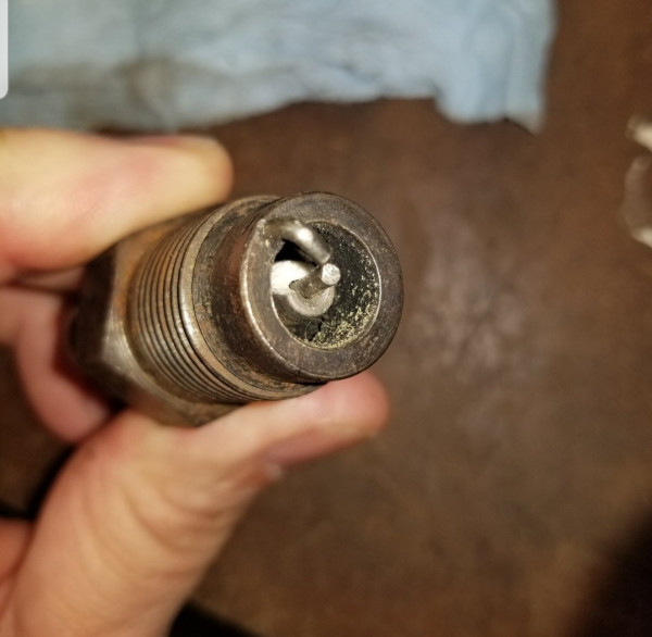

You repeatedly mention cleaning the plugs. Of what exactly? Excess fuel or soot or what?
vping
Topic author - Posts: 251
- Joined: Tue Sep 29, 2020 8:01 pm
- First Name: Vincent
- Last Name: Pina
- * REQUIRED* Type and Year of Model Ts owned: 1925 Tudor Sedan
- Location: Farmingdale
Re: Spark plugs
I think I'm guilty of this. When I posted the pic, I noticed the tab. I'll be checking that later for certain.Jerry VanOoteghem wrote: ↑Mon Mar 18, 2024 6:36 amDid you reset your float level after replacing the needle & seat? Just going by what I'm seeing in your pic, it appears that the little tab that pushes on the needle is bent down kind of far. If that's true, it would cause your flooding problem. Roughly speaking, the needle should seat when the top edge of the float sits parallel with the carb body. Carefully bend the tab to suit.
vping
- Last Name: Pina
Re: Spark plugs
Cleaned of anything on them so that I had a clear baseline. I can definitely eliminate the plugs and spark. I'm getting fuel, just too much which will be addressed later.Charlie B in N.J. wrote: ↑Mon Mar 18, 2024 9:11 amYou repeatedly mention cleaning the plugs. Of what exactly? Excess fuel or soot or what?

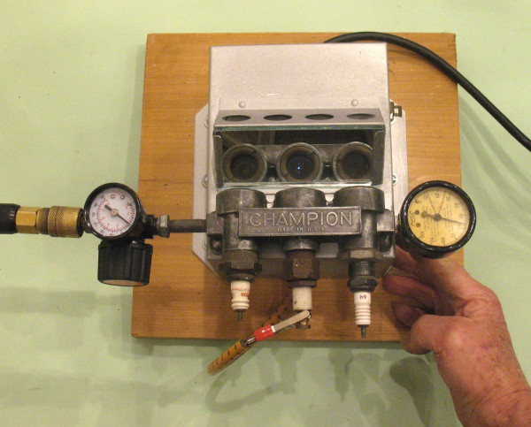

ThreePedalTapDancer
- Posts: 1727
- First Name: Ed
- Last Name: Martin
- Location: Idaho
Re: Spark plugs
Yes, a good spark plug checker tests the spark quality under cylinder pressure. I have found some duds that look really good, but were in fact firing weak when installed. I used my restored Champion quite often to root out questionable plugs. It has thread adapters to test all size plugs.
vping
- Last Name: Pina

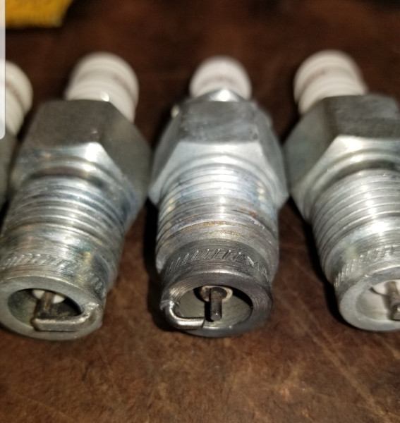

Re: Spark plugs
Would love one of those. Nice to hang on the wall and if it did different sized plugs, very handy too.
Currently in the car are Champion 25. I have another set of those as a spare but one of the 4 is a 2 piece style and has a different tip.
I also have a set of Champion X. Also 2 piece style. One has broken porcelain. I'd like to find a new porcelain and then clean up and try to use. Anyone have a spare porcelain?
Feel free to educate me on what these 2 piece plugs are called.

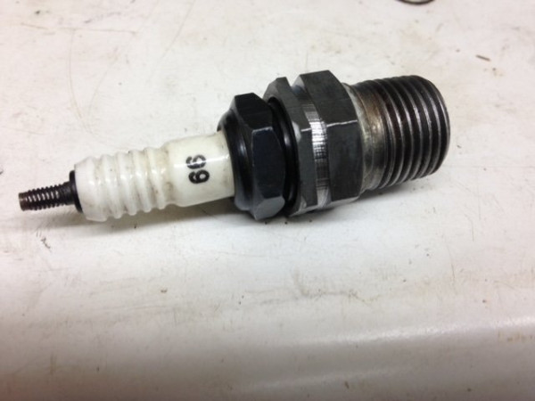

Are the nuts on the top of the plug backing out with vibration? Just something quick to check.
vping
- Last Name: Pina
Re: Spark plugs
Haven't had it running long enough to determine that yet. It's something for me to think about once I do get it on the road.

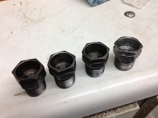

14mm plug adaptors cam be made from old spark plugs ( the crimped ones not the ones you can take apart ) They look correct. They can also
be used to repair over sized or damaged plug threads. Craig.
