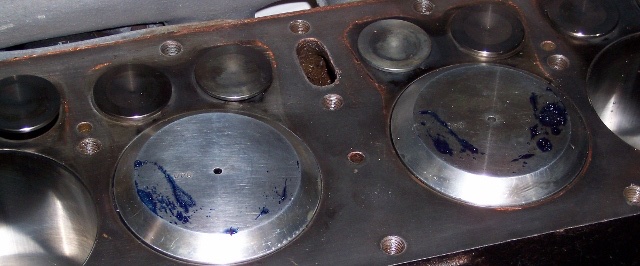

Prus head is on and TESTED.

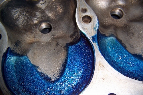

Anyone interested in finding out what the compression of a new 8:1 Prus head is in PSI?
If you didn't see the multiple times I used bluing to check for interference with the pistons - run through the playlist.
I believe there are two videos where the pistons hit the head (Z head was worse "bang" just to be fair).

I wonder how many other Prus head users have encountered clearance problems ? Its strange that I haven't seen or read any other posts to that effect on the Forum. Since there are replacement pistons made by more than one manufacturer and different head gaskets available, both New manufacture and New Old Stock, as well as USED, I can see where there could be enough clearance issues to cause a problem; its just odd this comes up so rarely, if ever, before. The other clearance problem is the one that John mentioned in the post after mine; a block having been previously decked. since the block in question was not a N.O.S. block, there's no telling whether, or how many times it might have been decked.

I have not had any fit issues with Prus heads. I have not tried one on a block decked 1/8"
I have had interference issues with every Z head. Thats from inconsistent combustion chamber castings.

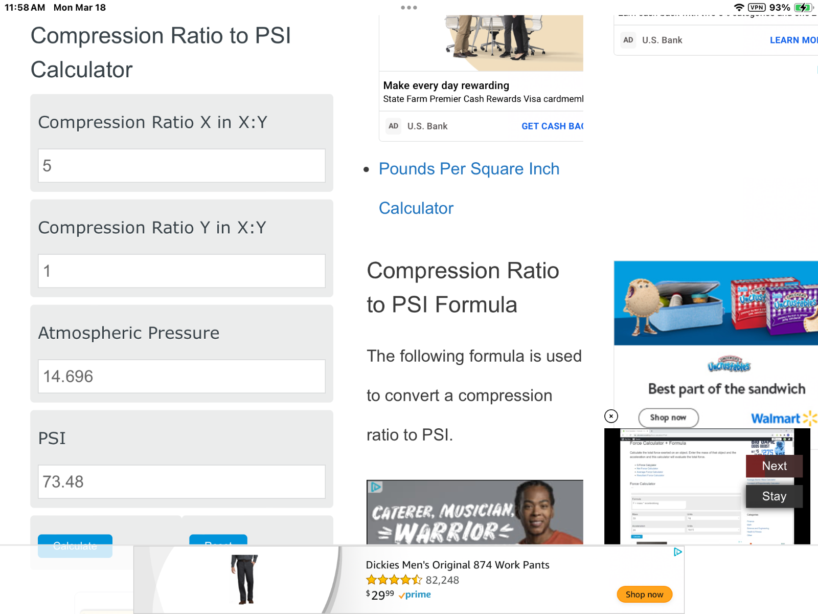

Based on an online compression ratio vs PSI calculator you should get around 115 PSI for an 8:1 ratio
75 PSI is more likely to result from a 5 to 1 ratio

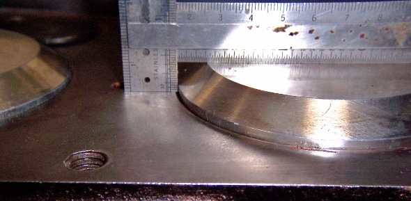

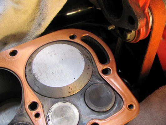

Speaking of pistons hitting the head, I had that problem fitting .080" OS pistons to a Ricardo head. Rather than machine the head, I turned down the top edges of the pistons. Solved the problem.

I'll second John K's observations. Z heads do vary in combustion chamber casting. I always fit them dry with no gasket first, and hand crank them to see if there are any issues to be worked around. The Prus heads I have seen have been trouble free, but I have had to put my own "Made in Canada" and Ford script on mine.

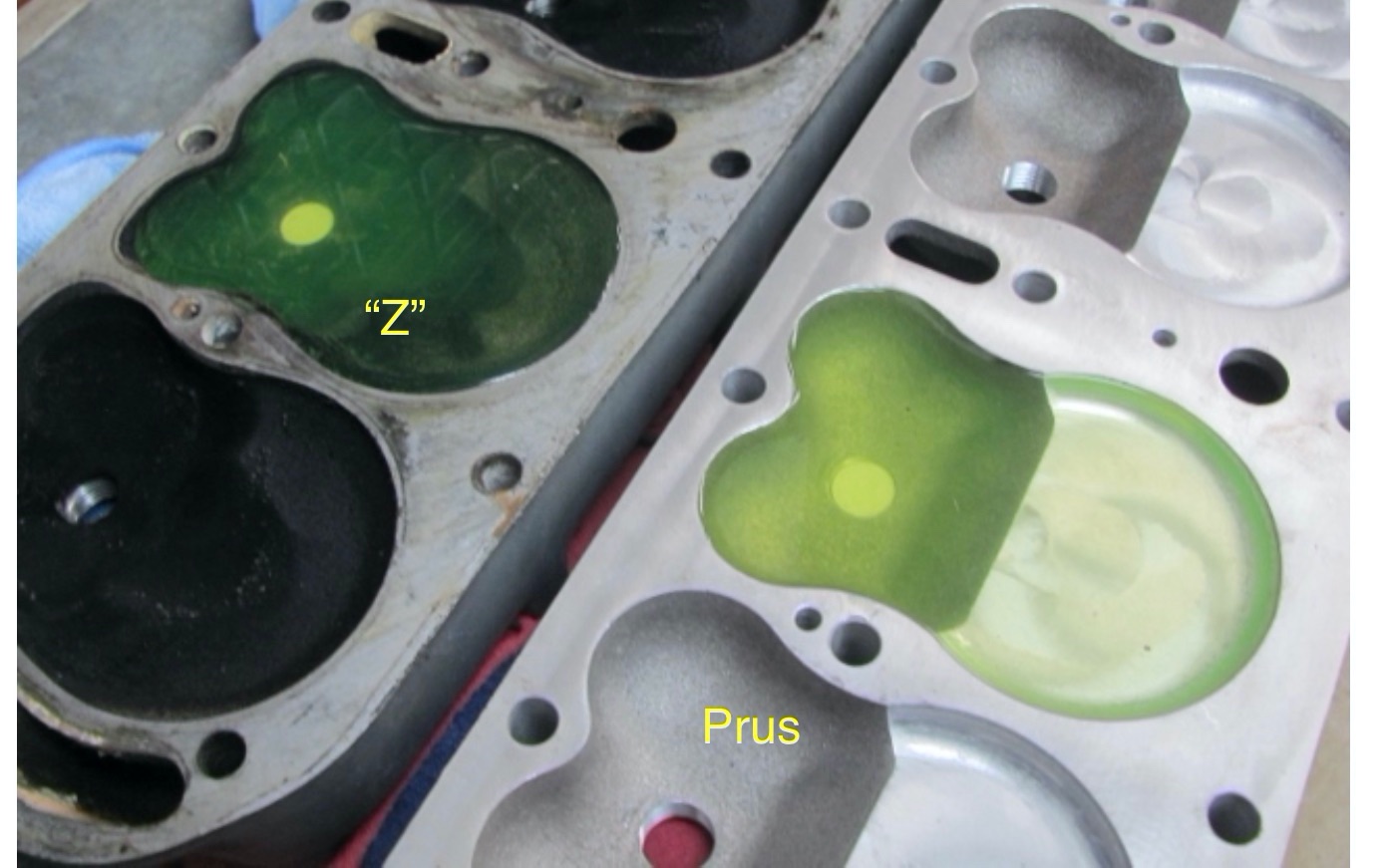

Same here.. Replaced a Z head on my 27 touring with the new Prus a few years ago.speedytinc wrote: ↑Tue Mar 19, 2024 8:18 am
I have CC'd various heads. The Prus head is a little more than the Z. Comparable. A little over 5:1.(I don't have the #'s with me now)
Don't let the 8:1 claim scare you away from it.
While on the bench, filled a chamber of each with fluid and measured.
The "Z" head held just at 250ml, the Prus head held just tad over 200ml, done with a measuring cup.
As one ml = one cubic centimeter, results were 250cc for the "Z" and 210cc for the Prus.

So here's the first test fit of the prus head. After this I pulled a Z head out of the pile and that hit in more places than this one did. I then changed the rods. I believe this engine was decked mercilessly, however - it didn't raise the compression much! As you could see in the video I posted above, it's a 5-ish to one compression ratio. I did this test cold, I can repeat it hot later after the engine has a couple miles on it if there is a demand for the information.
No clue where Kevin got 8:1 but I had a sneaky feeling it wasn't when I saw the ten foot deep valves live here caves in it. Anyway - here's the first test fit:

We’ll, as it turns out the clearance issues were due to a sketchy block and not the Prus head. That’s good news as no other problems had been reported. Thanks for the quality product Kevin. As I haven’t had one of these heads in my possession I won’t comment on the compression. I will say that with an 8:1 Sherman head premium gas was essential.

Clearance between the top of piston and the underside of the combustion chamber to generate quench (create turbulence) should be around 0.038 to 0.060. On a flat motor, quench can become problematic, because you need space around the valves to generate effective laminar flow both underneath and around the valve heads (increase cc volume). The only place where quench can really be attained is over the top of the piston. So ideally, you want to get the top of the piston as close as you can to the underside of the cylinder head. In the case of Mr. Pruss's design, it appears to be about the thickness of a compressed head gasket.
As you tested the head with no head gasket in place, there should be 100% contact because the head gasket is going to add in the thickness to generate that space required. Watching your blueing test showed that the machine inside of the combustion chamber above the piston seems acceptable, with a relatively complete contact area.
Put a head gasket on, grab some plasti-gauge, torque down and check. That should give you the answer you are seeking.

Am new to playing around with different heads but after i found my transmission filled with radiator fluid i realized i may have a head problem
Removed the head which was an aluminum high compression [ according to seller ] found out corrosion between the water ports and cyl 1 and 4, which prevented the head gasket from providing a good seal
So this led to me purchasing a replacement head, based on comments on this forum i selected the Prus head.
Head arrived yesterday and decided to do a fitment test today before bolting it up, good thing because could hear the interference
Piston looked like standard one and piston head shape and size appears match to indentation in head.
Looking to figure out amount of interference I doubled up the gaskets, 1 new 1 old, head laying loose on top. Interference went away and head allowed some lateral movement with piston all the way up.
So question to you experts is where to go from here, ask for replacement head, or take head to local machine shop and mill a larger piston cavity and then the question is by how much. Other options ?
Thanks for your input in advance.

WillsT wrote: ↑Sat Mar 15, 2025 10:48 pmbased on comments on this forum i selected the Prus head.
Expert certificate lacking, but have fitted alum high compression "Z' and the Prus heads.
The Prus head made no interference on 2 motors, both had block surfacing and new stock pistons, .030" over.
The "Z" fit didn't work as there were piston knocks after install (had not learned to fit with loose head bolts first). So took off the "Z" and painted the chambers with Prussian Blue paste. Fitted back with a few bolts and cranked over, that showed on the top of a couple of pistons where the piston hit the chamber dome.
So maybe do the same, also measure how much height you pistons rise, and if the pistons are .060" or more like .080 as there maybe contact on the edges of the chamber. There can be variations of how high pistons rise at TDC, like the one below:
This engine shows piston height at TDC much lower, and fit of a Prus head wasn't compromised, and worked great.
By using blue paste, you would see the issue. Maybe only one or two chambers are affected. Use judgement to see if alum has to be removed from the chamber(s).

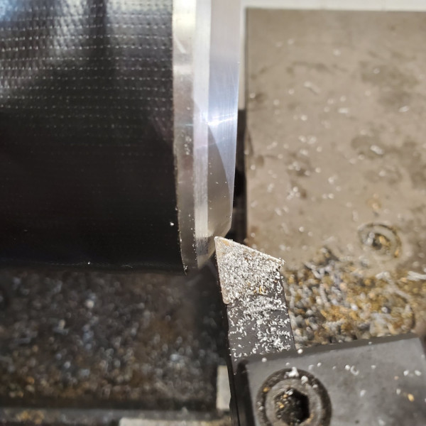

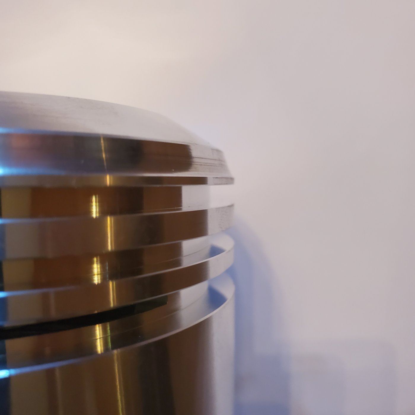

I'd use caution removing any metal from pistons. Thinning sections of a piston above the top ring can lead to hot spots. Balance issues might also occur.
The cylinder head is probably thicker, and it is water jacketed, and balance is no issue. The head is also more likely to be non-uniform than the pistons are.

Compression ratio and compression pressure are not the same thing, as was pointed out
Compression pressure is measured with a pressure gauge, and is subject to many variables besides head chamber volume.
Compression ratio is fixed for any given engine, as assembled, and it is calculated mathematically.
You need to calculate the swept volume of an engine cylinder, then calculate the volume of any dome or recess in the piston head, then measure the volume of the combustion chamber in the head, and allow for the head gasket installed thickness. If you have a flat head piston that TDCs level with the block deck, the ratio between the actual combustion chamber volume at TDC and the swept volume, plus the installed head gasket thickness, less any intrusion of the valve heads or spark plug into the chamber is the compression ratio. You cannot measure that with a compression gauge.
If you calculate the volume of any part of the T piston that is above the deck at TDC, and subtract that from the combustion chamber volume, and calculate the ratio of that volume to the swept volume of the cylinder, that ought to get you fairly close to the compression ratio.

I agree the Prus head appears to be very well made although I have never run mine. The chart I did at the Tulsa Website (https://mtfctulsa.com/Tech/head_design.htm) I explain how to account for piston popup, head gasket thickness, milling, overbore and stroking. I always use a plexiglas plate (as shown in photo) to get an accurate head volume measurement. I measure 215cc for a Prus head and 203cc for a Z head which is in line with what others have found. So both heads are a little more than 5:1 compression. I'm currently running a Sherman head that measured 214cc. I measure 220cc for a Chaffin Rajo. I have complained about truth in advertising before. How can someone make an informed decision without this basic number?
As has been noted, cranking pressure is not a precise number since it depends on thing like valve timing (camshaft). It makes a difference whether the exhaust valve opens at 35 deg or 55 deg BBDC. Also, Art is absolutely correct that you have to take the compression ratio to a power. This is fact not "theory" because the compression is not at constant temperature (the air heats up).

Thanks for supporting me on the compression calculation. I thought about explaining how the heat of compression increases the pressure, but just didn't feel like arguing with others.
Under ideal conditions the ratio would be raised to a power of 1.4 for air. Under realistic conditions, some of the heat that is generated from the compression escapes to the surfaces of the combustion chamber and to the piston. Empirical data ahows a factor of 1.1 to be fairly accurate.
I have thought checking the compression with a cold engine versus with a hot engine. I have not yet woke up my car from it's winter nap to try this. I am wondering if anyone has made this comparison.

First of all I need to make a correction on my “interference” problem with the Prius head.
This was a newby operator problem as I did not have the head centered over the pistons, after correcting this no more interference.

So I wanted to check to see how well the new head and gasket was sealing, so first I did a compression test using my starter as power source and all cylinders without plugs in
So all cylinders came out very similar at 70 PSI, no spark plugs firing so engine was barn cold
Then I started engine up with 3 plugs in and 1 measuring PSI all 4 cylinders showed around 80 PSI, engine now warmed up obviously
Don’t know is difference in PSI was due to temperature change or RPM change but here is a data point.
So hopefully my water leak is fixed

More precision = greater results.
There are some who just take full volume at bottom of stroke, and then remaining volume at top of stroke on a compression stroke. That’s one way.
There is a totally different way that gets a little scientific in the early Van Dykes...That’s another way.
There are those who like to use the old ‘rule of thumb’ of maximum pressure developed divided by ambient pressure (not including an absolute pressure and only using gauge pressure for the compressed value). Divide the two = CR.
There is yet another way to factor in the thermodynamics of gas changes due to combustion and that one throws all of these others out the window by not even being close!
Each way has survived with equal weight (lol) for most of my life as a motor-head! The easiest way is to forget CR as a ‘moniker’ and go for the volume using the Montana 500 way to measure-couldn’t be easier. Less volume = better ‘explosion’ with rapid expansion. With tongue in cheek, all else the same, ignoring a ‘squish/swirl’ value argument as it just gets complex, if you want to be all you can be...pick a clearance...make a mylar shim set that is that clearance while including gasket height...blue the head up...and polish out the bumps. To me, ain’t worth that kind of worry ‘cause a Model T ‘breathes’ so bad to begin with its all muck but performance is better with a blueprinted engine – right? Simple as that, I'd guess.
A final thought...for those that want to quantify --- ever ask yourself...at what point in these amazing reported CR's should you switch over to hi-octane with anti-ping??? Yeah, I know - - -goes back to that breathing problem and has nothing to do with these old school backyard thoughts...
