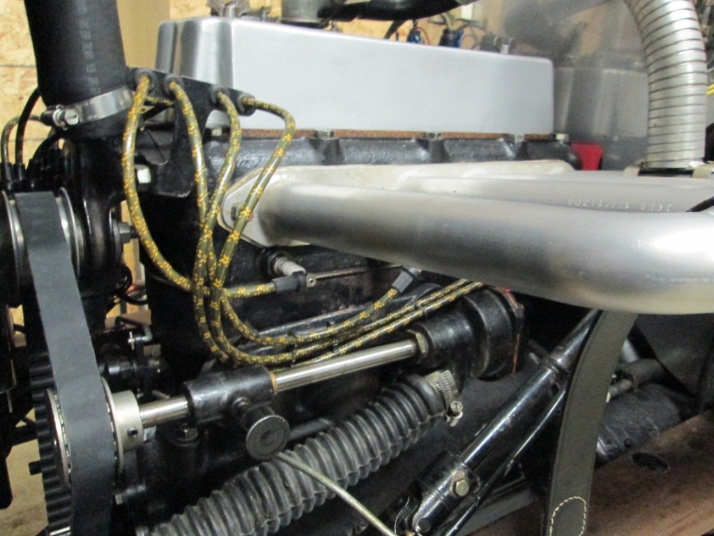

Post by RajoRacer » Thu Mar 28, 2024 11:01 am
I'm running a nearly identical OHV set-up - my radiator started life as a Whippet but I had a new top tank made with Model T inlet & outlets - it cools O.K. but I'm also running a 5/8" shaft water circulator - been on several 200+ mile NWVSC events and have never boiled over.

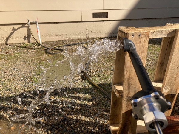

The cooling system on a T is sized appropriately for a stock T engine with thermo syphon. There are many overheads out there running without pumps, but I suspect they are producing little more than stock performance. With the addition of a pump the cooling system is capable of handling a much higher heat load.
If you have built up a “hot” motor (say 40+ hp) I would plan on keeping the pump. There are too many pumps for T’s to count, and not all have equal performance. Most pumps are circulators, and few are actually pumps. You could always build up a test rig to measure the pump output. With a 5 gallon bucket, pistol drill, stop watch, and a lot of duct tape, you can see what yours will do. This one was on the dyno supporting 55 hp with no issues

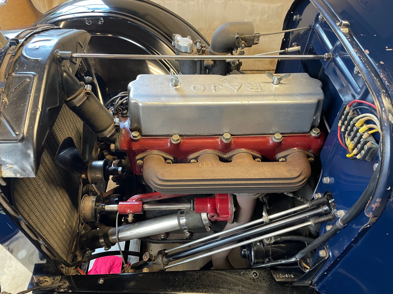

For what it’s worth, I have a Rajo Model 30 head with a Stromberg RF. Have never had a water pump (or circulator) and have never overheated or boiled over. That said, I just replaced a 100 year old worn out honeycomb radiator core with a new V-cell core. But even with the old core, it never overheated.

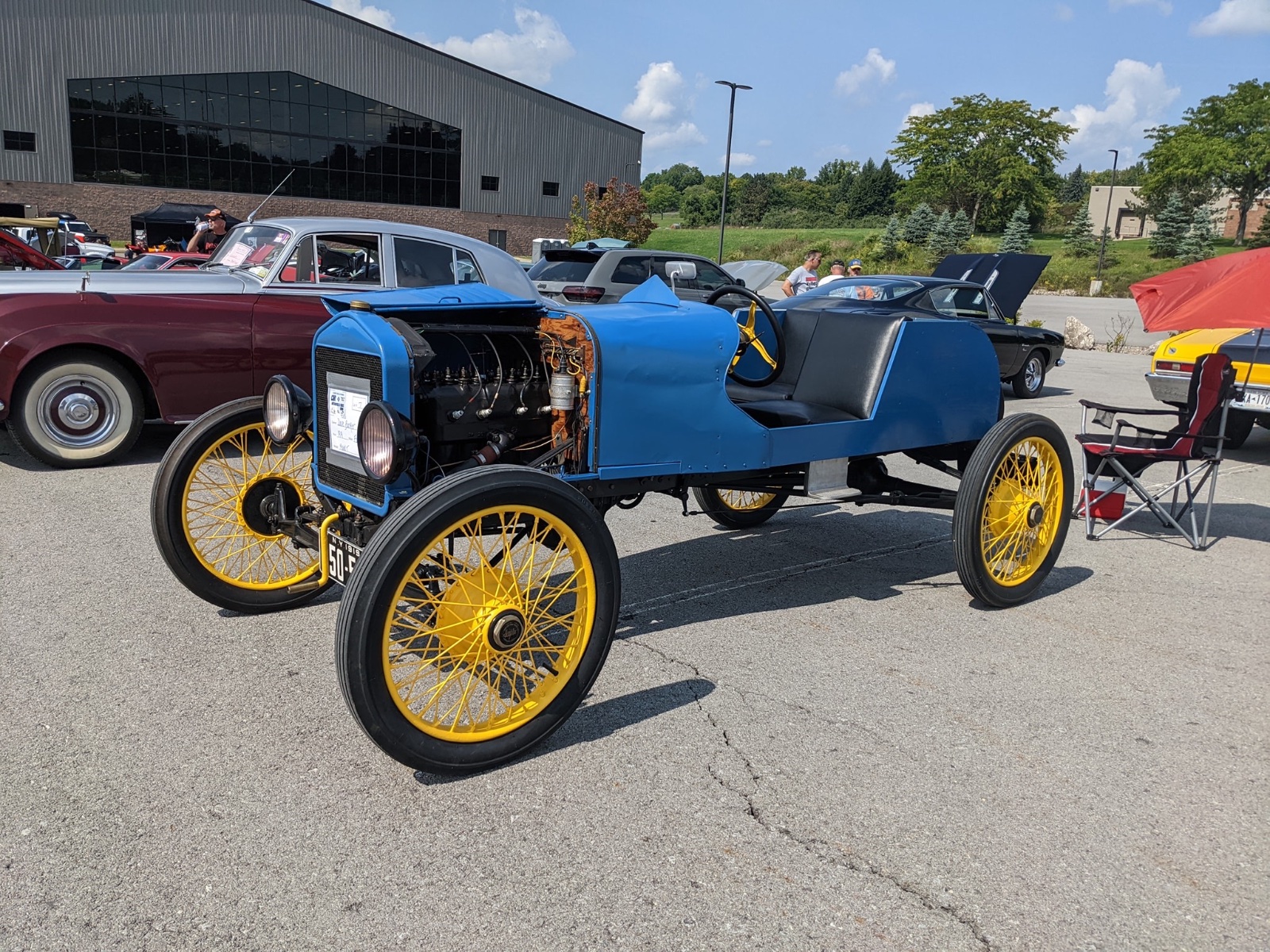

Thanks! I really like your T btw, dual ignition? What type?

Thanks for the compliment! No, it’s a basic Texas T dizzy, standard four plugs.

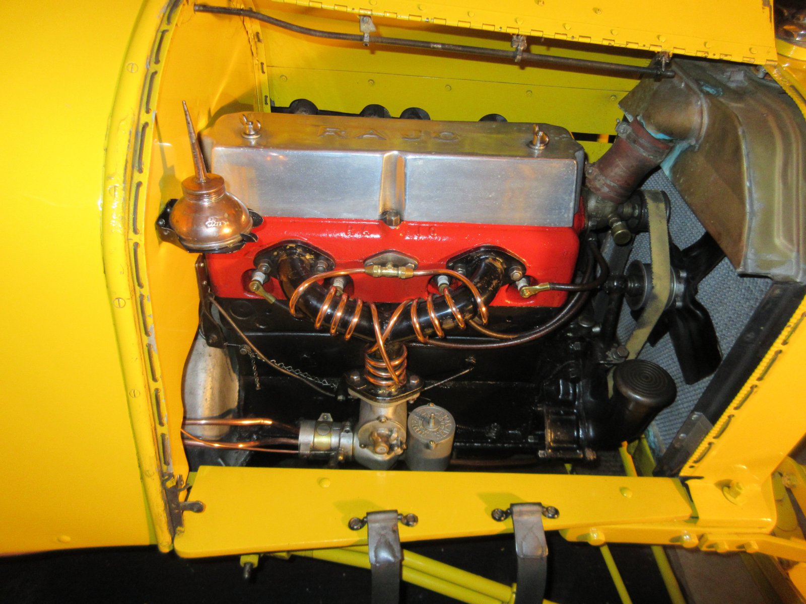

For what it's worth I've run both ways in old number 4 and saw very little difference on the Motometer. Not even close to overheating. To clarify, the head is a Rajo B. Engine, stock crank and cam. water pump is the Stockton, in the neck between the head and the radiator (a water pump that's a little better than nothing, in my opinion, but with a cross drive magneto drive it's the only easy option). And I'm running an early, pre 17 style, aftermarket honeycomb radiator. several years ago I was having a problem with the water pump and while it was being fixed, ran the car for a year or so without it and saw very little difference in the water temp (according to the Motometer). Then while preparing for one of our trips which included a drive across
the state of Nevada in July and I thought, "Hot Hot Hot, I better get the water pump back on". So bottom line, I couldn't tell much difference.
Ed aka #4

Thanks for the insight Ed! How well does your heat tubing work keeping your intake warm? It’s a neat look. Whole engine bay is very nicely done. Feel free to post more pics of your T/engine if you like!

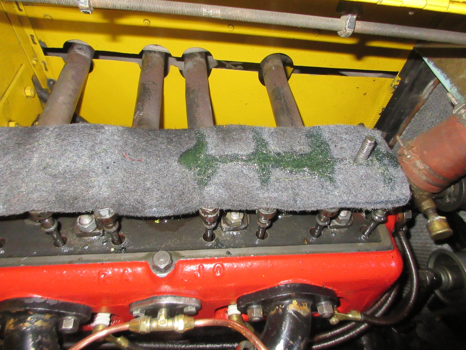

The wrap on the intake took care of the carb and manifold icing up (on a 104 degree day!) long story that I won't go into here but 20 or so years ago that happened. I installed the wrap and it hasn't happened since. As for the other side of the engine, I don't have a picture of it but no great loss, not much to see just the exhaust header and Bosch magneto. But here's a picture of the pad on top of the rockers. My morning lube routine on long trips is to lift the pad and a shot of oil directly on the assy. then a "streak" of oil on top of the pad. You can see the "streaks" in the picture taken as I was in the process of oiling. First on the front half of the pad working my way back to the rear. Good for the day's drive.
