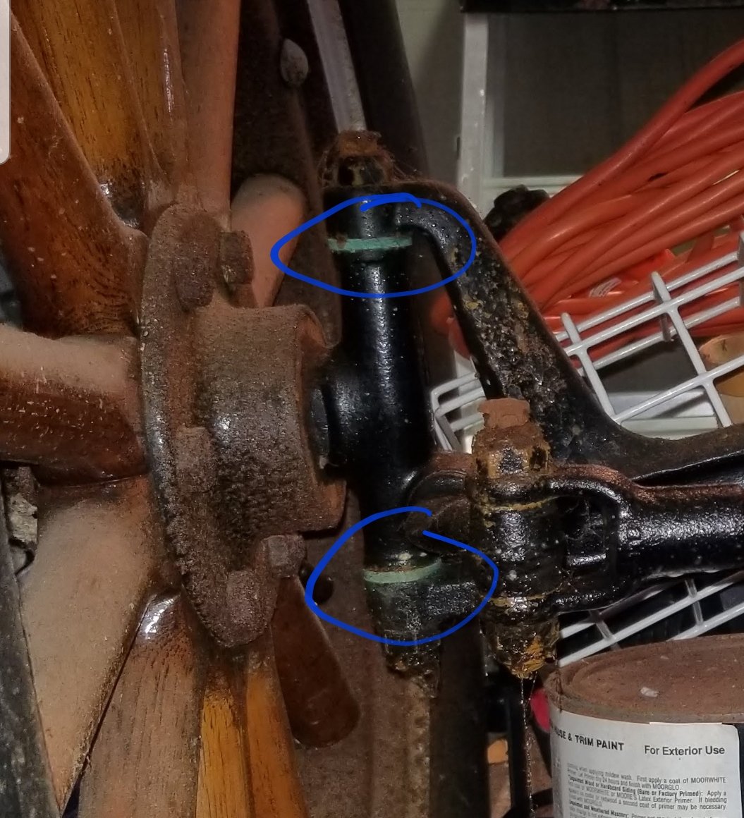

I do my own king pins on my MGB. Is there a reamer available for the model T and can they be done diy? I will say I noticed some play at these points.
jab35
- Posts: 1027
- Last Name: Bartsch
- Location: Dryden, NY 13053
Re: Tight steering
Spindle bushing reamer: https://www.modeltford.com/item/2713RM.aspx
The close up of the king bolt bushings and radius arm bolt appears to me to show badly corroded (green) spindle bushings and severely rusted flip top oilers. Were these somehow exposed to acid fumes??? I'd work on freeing up those parts with the axle jacked up and wheels off the ground and see what is binding. IIRC, someone posted awhile back that a jug of acid was stored under the front of a T and the fumes rusted up the wishbone. Those spindle bushings with green oxide may have been gassed by acid????

Bingo! That's her. She's free with the wheels up and no binding. The acid fumes mainly surface rusted some parts and took off the paint. Base metal is very solid. The green patina bushings do need to be replaced. I noticed one side had very little play whereas the other has about .040".jab35 wrote: ↑Tue Apr 02, 2024 12:52 amSpindle bushing reamer: https://www.modeltford.com/item/2713RM.aspx
