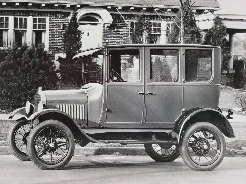

I am currently restoring a '27 Ford sedan. We came across the same page of that brochure. I also was looking at a factory promotional photo and it certainly looks quite like a satin finish to me. My inclination is to copy the finish of the car in that photo. I'm looking at the finishof the fenders compared to the body. Interesting.

The low gloss of the lacquer can be seen even in black & white photos against the high gloss enamel on the fenders & running boards.

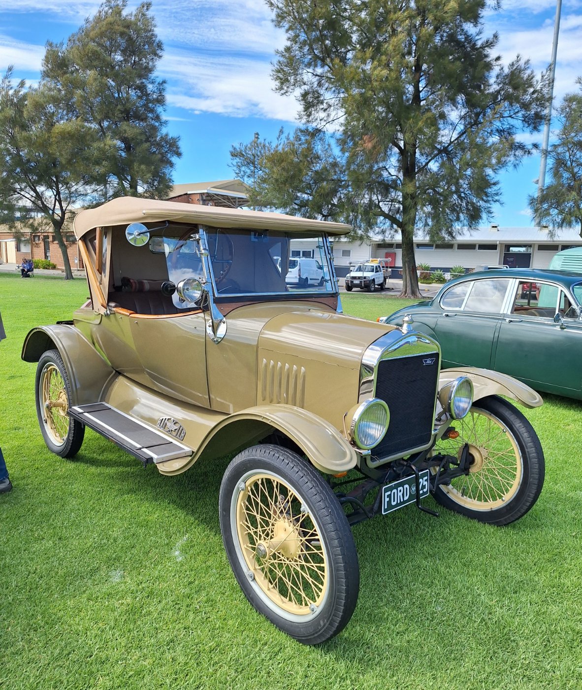

Here is my Duncan and Fraser wide body roadster, painted 9 years ago with lacquer. I did rub back and polish the flat trunk lid just to see if it was worth the effort. It was not.
