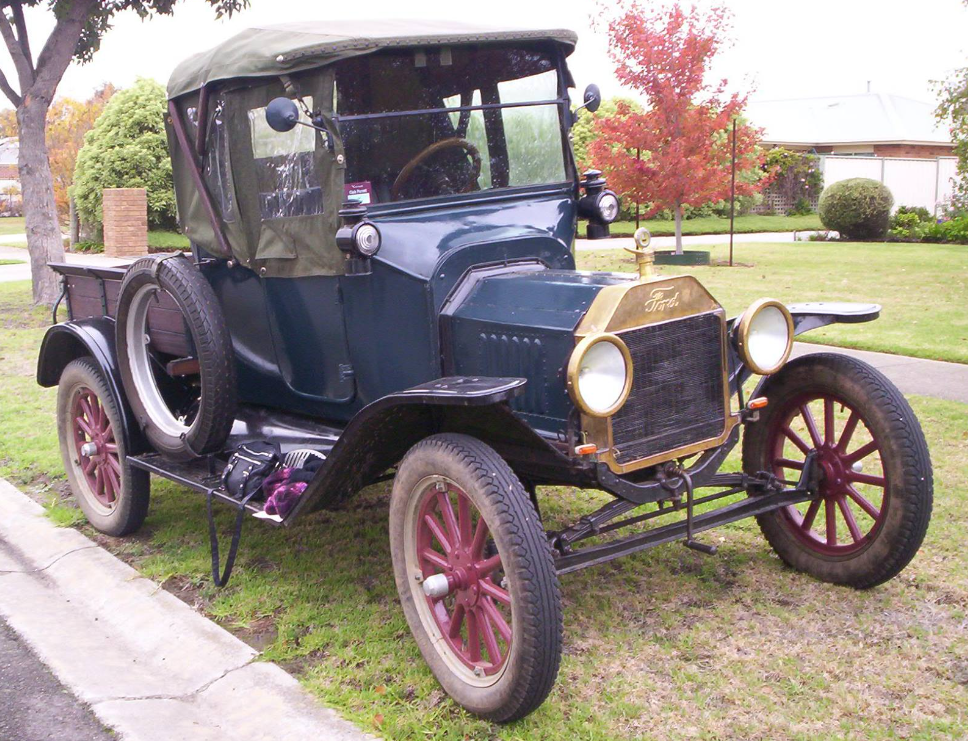

- Posts: 7167
Re: Canvas for tops
I have five T's with canvas tops.The canvas made today has a percentage of polyester in the weave. This makes it stronger and lowers the amount of shrinkage when it gets wet. Do not get this confused with the square grid of fibres in ripstop type fabrics. It looks just like canvas used to look on our colonial bodied cars.
The colour most suited to T's is light sand. This is a fawn colour rather than army green.
