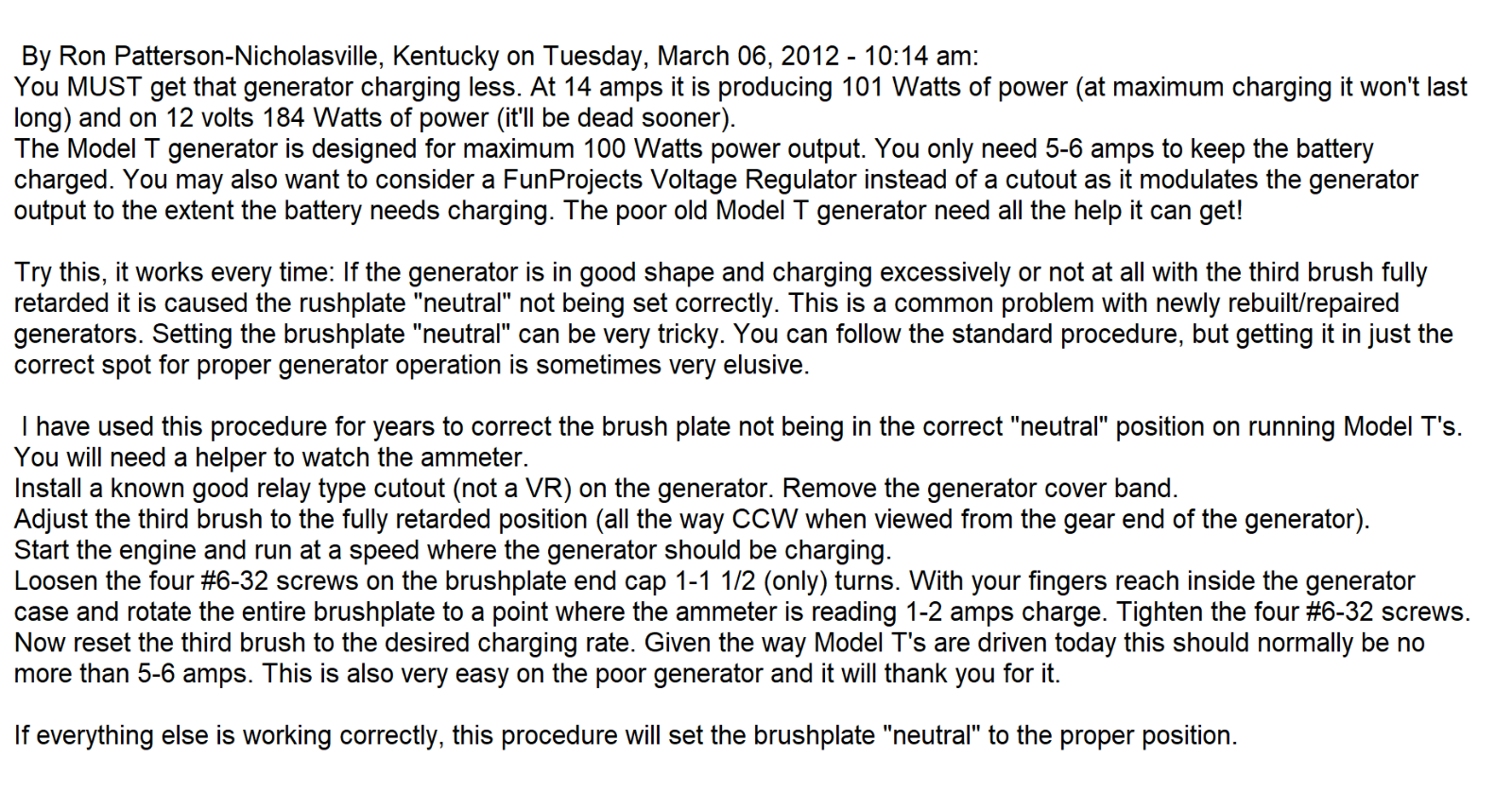

Honestly, there are so many things that can go awry inside that generator it's crazy. It's quite easy to take out of the car. To fully inspect it, you really need to do so. Once it's out, you can jump your 6v battery to it and see if it turns like a motor. If not, then something is broken inside. If it does turn, then the null point might just need adjusting. A Google search on this should turn up Ron Pattersons excellent article on how to do this.
If it doesn't turn, then depending on your comfort level and tools you have, you need to 1) dig deeper or 2) get a rebuilt one. Of the 100's of generators I've rebuilt over the years, the main failures I see are: shorted field coils ( I only use new ones now), shorted armatures ( only about 50% of the armatures I see are useable and strong) & shorted brush plates. The last one is a major pain as good, useable brush holders are harder and harder to come by, and rebuilding a brush plate properly is no small feat. I'm actually getting new replica brush holders cast out of zinc right now. I just approved the engineering drawings last night and should see them in a month or so. It will be one of my small contributions to the hobby to help save these aging generators (and starters).

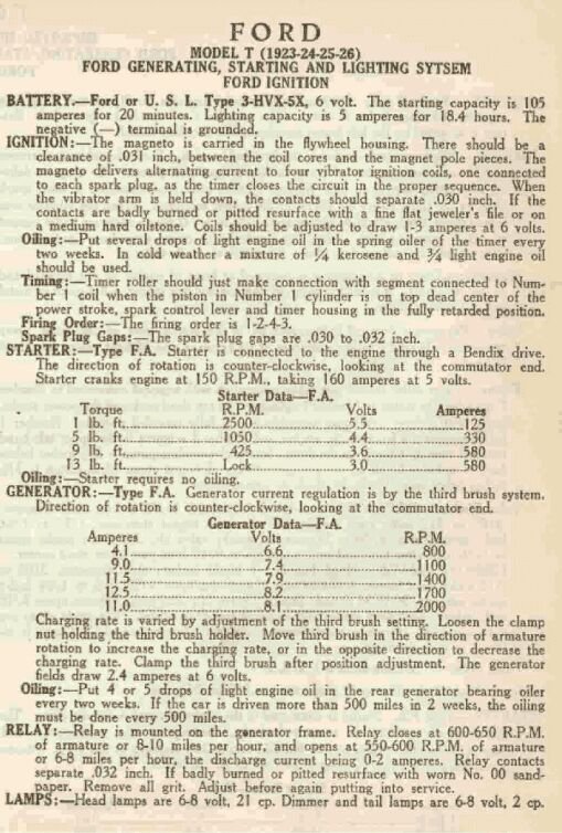

Here's some of the information that Jeff referred tooAdminJeff wrote: ↑Sat Apr 06, 2024 11:37 amHonestly, there are so many things that can go awry inside that generator it's crazy. It's quite easy to take out of the car. To fully inspect it, you really need to do so. Once it's out, you can jump your 6v battery to it and see if it turns like a motor. If not, then something is broken inside. If it does turn, then the null point might just need adjusting. A Google search on this should turn up Ron Pattersons excellent article on how to do this.
Jeff
Adjusting the Model T Generator Brushplate Null Point with the Generator Installed by Ron Patterson
https://modeltfordfix.com/adjusting-the ... patterson/
