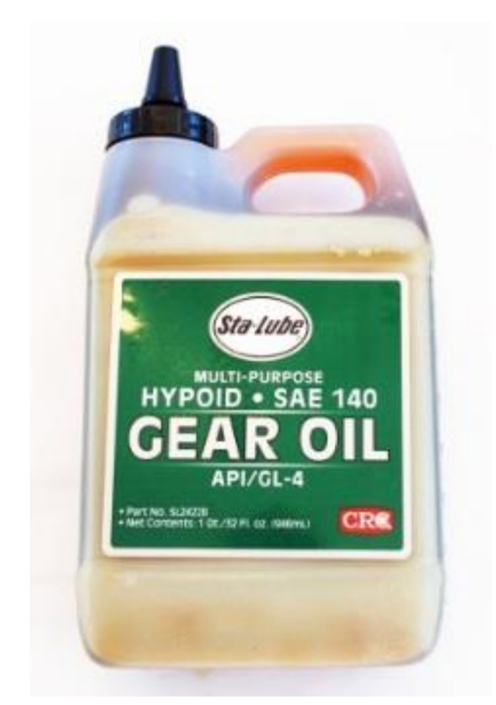

Re: Ruckstell ? new to me
This is what we recommend.
