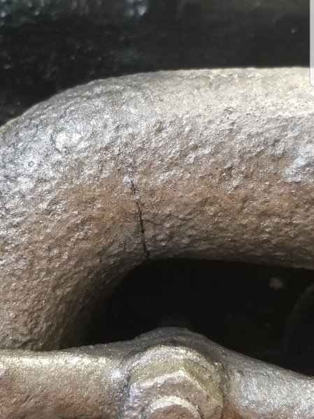

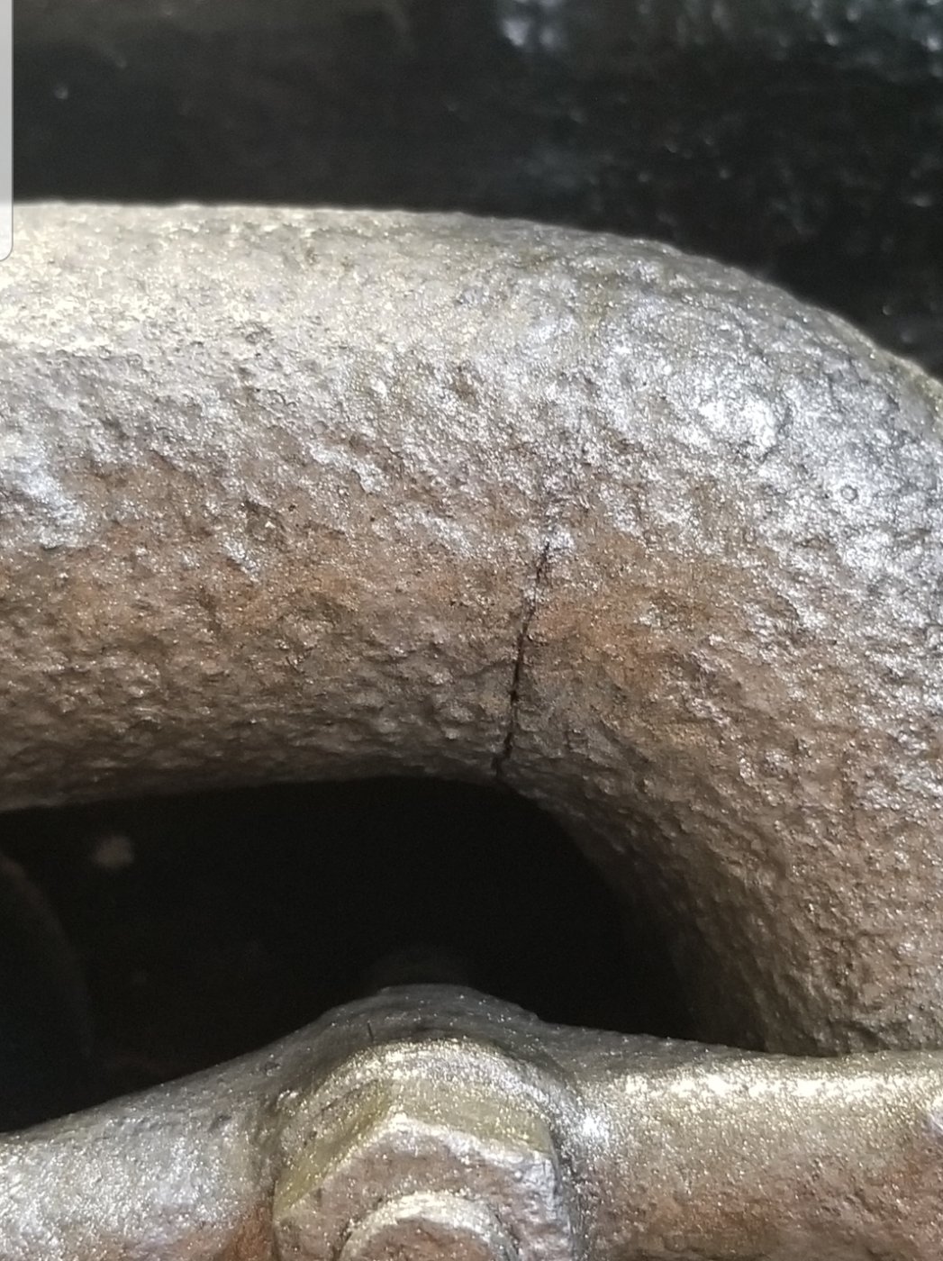

Seeing a very fine line in the manifold, I suspected a crack and proceeded to wire brush and paint anyway. Crack seemed to go away. After running it, I now see that the crack is in fact, a crack.
Question 1: Can I should I drive it this way?
Question two: If I shouldn't, what are the chances of repair?.
Question C: If question A and 2 are off the table, how good are the new manifolds?

Throw it in the scrap bin & purchase a new one - they're good ! Save yourself some grief !

Run the engine and check for noise... If it's acceptable, that's your choice

I can't help but think that the crack will get worse. Replace it.

Been looking at the Langs manifolds since I got noticed the crack, so I'm adding it to my list.

You might find a good original at Luray, Hershey, Bakersfield, etc. But going there is likely to cost more than a new manifold.

The 'value' answer is to purchase new. It's the best value for buck to be found...sooo much gets resolved in and of itself just by going in that direction.
Before I close my comment...one more thought for 'youngin' and 'newbies'. There was a time stuff like this was discussed, even debated, openly on forum...not so much these days as us old guys move onward
You can almost always stop a crack in cast iron! If it is due to torsion of flex...not really...as the answer is a crapshoot If it's just the release of old internal stress from the original shrinkage after a billion heat cycles?
1- Drill a 1/8" hole at each end of the found crack with a sharp bit. Normally, end of crack propagation by this step alone.
2- so what about the remaining opening? The best old school is to take a 1/4" copper rod and thread it, even to 1/4-20 if you don't have a 1/4-28 available. Sink a 1/4-whatever tap at the first relief hole. Thread in the rod and cut off slightly proud. Stitch along with a line of overlapping taps and inserted threaded copper rod cut off proud. All done the daisy chain? 'peen' without too much attention, then grind copper off flush. Good as new and you might not even have to take the part off!
Actually a better old school hole fixer is what is called a 'rust joint'. I'll leave it to anyone who wants to know to do a lookup but some easily available things, mixed into a putty. Drill the relief holes at cracks end, work the 'putty' like you might JB...ALL DONE, by tomorrow as strong if not stronger than the original material.
Here's a post I did 15 or so years ago, was for a head backbone crack at the time, but same stuff...which explains the home made putty better. Every head backbone crack that I've done for the last 40 years I believe is still holding strong...at least I know the first and second have no issues to this day. Old school stuff is fun to chat about. I know, new world, new order, and if I had to work to live...then time is precious and the cost of a new is dirt cheap. For an old timer swatting gnats? I have all week to do old school things

it would have been interesting to see a photo of the whole manifold. I wonder if it is warped as well? When replacing it, be sure to use gaskets with glands that center the manifold into the block.

All about budget and your talent if you don't have alot then fox it ibmve had very good results with might welding the cash manifolds if you don't have the talent then buy a new or good used one

That crack goes more than halfway around.
The manifold is trash!
