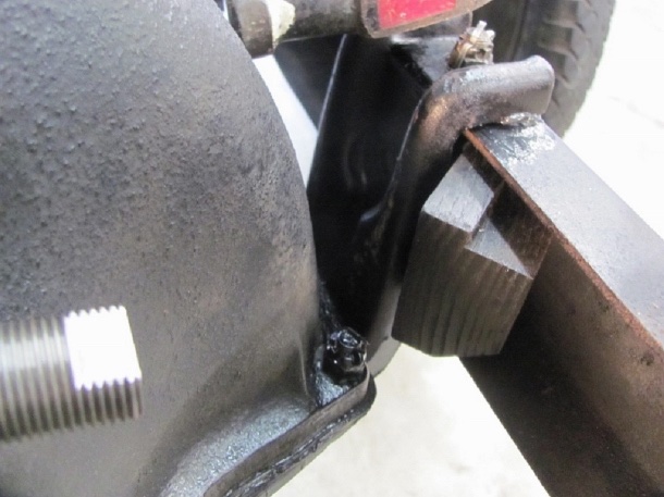

Here is that way to mount, as suggested not by Ford for the T, but by a long time T'er. Do so if you wish.
IMO the wood block and std mounting hardware is better for the T. The wood block does help resist frame twist on braking and acceleration. The single bolt, even with a spring can't do that.
That bolt, p/n 3074C is TT CC arm bolt, longer for the TT . The bolt is 3/8" x 24 and is 1 7/16" long.
The wood block, fitted very snug inside the frame rail and against the crankcase arm resists side twists of the engine and frame.

I would think the best option would be to do both. Use the bock and side bolt but just snug it, not murder it. Maybe add a spring there and then use the spring on the upper bolt. Be close to a rubber mounted engine and flex when it needs to.
