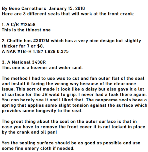

Does anybody have the Gene Carrothers step by step that he said was listed on the Mtfca site? He said they used this procedure at a club session and it was on the site butit can’t be found. If anyone has this procedure if they could text or email it it would be appreciated.
Regards
Larry LaPatka

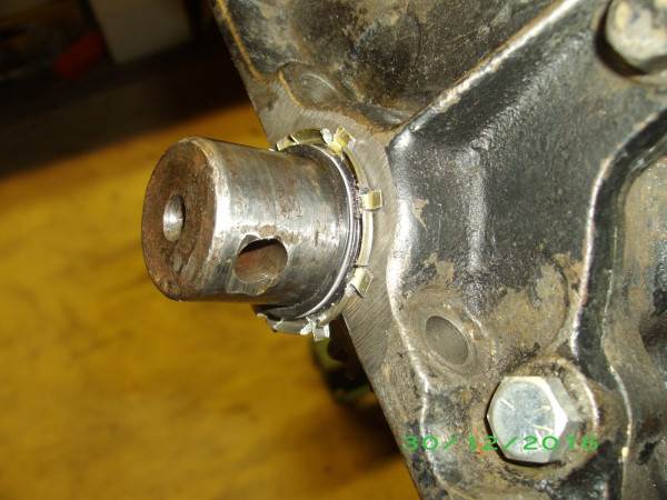

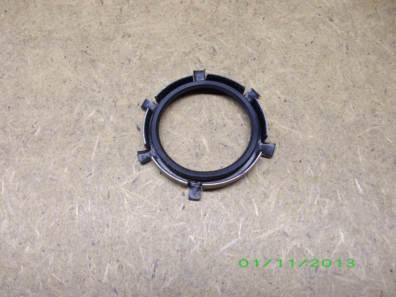

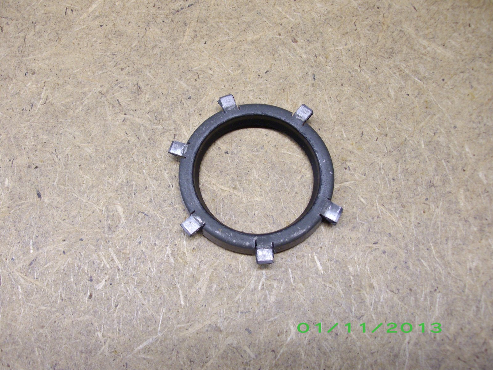

To seal the Crankshaft I use an oilseal and [ glue ] them with JB weld
See the pictures .
Toon
Toon

Is this what your looking for ?
