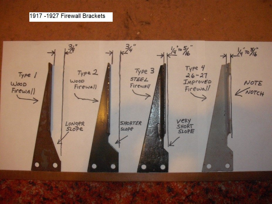

Is the firewall to frame brackets for the wooden firewalls a left and a right?
The reason I ask is the pair that were on this speedster are exactly the same and the person who built it put one flat side to engine and the other flat side to coil on the firewall which seems to put the firewall at a bit of an angle.
I would think they should be mirroring images of each other and on the same side of the firewall. Whichever is the correct side they should be on.

Yes, the correct firewall brackets have a right and a left, All years and wood or steel firewalls, 1909 through 1927. If I recall correctly, all of them correctly mount on the engine side of the firewall (although I could be wrong about the 1926/'27?). Other details bolted to the top of the frame or the side of the frame, and whether the offset is inward or outward does vary a little by different years.

Other details of yours, whether bolted onto the top of the frame rail or the side of the frame rail, year model of car and/or chassis. "Wood" firewall helps, however there was a big change in the brackets about 1916 when Ford switched to bolting the bracket onto the side of the frame rather than the top of the frame (made servicing the car or removing the engine much easier).
Photos of the car, hood, and firewall would also help.

Bolted on the top of the frame.
Ugh. It just gets worse. So, seems that the brackets are not of the same time frame, side by side the bases are different. Also, the person who put these brackets on drilled holes for them, and not very well. They are at least 3/16" off from each other so the firewall has a noticeable unsquared cant to it.
But it has to be a mid 16 and up because it has side holes for that type of bracket, so I think I need to get the 17 to 23 style and move on.

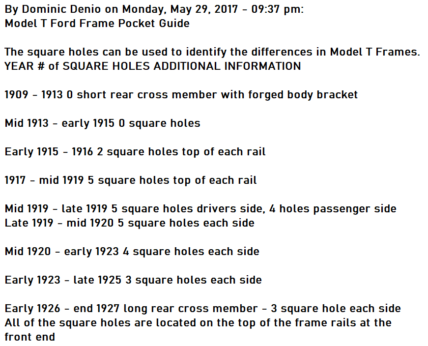

A lot of the responses reference frame differences. Have you identified the year of your frame?

Frank. I have seen that. But the rear crossmember was trimmed and there are many holes in many places on the frame so without a diagram of frames marking what holes are what and where they are located it's a daunting task. Some holes are square, and some are round. Little was attached to the frame so I would not know what was attached where.
- Posts: 6548
Re: Model T firewall to frame bracket help.
Some more info. Square holes are not usually a DIY --skyhunter wrote: ↑Sat May 04, 2024 12:35 pmFrank. I have seen that. But the rear crossmember was trimmed and there are many holes in many places on the frame so without a diagram of frames marking what holes are what and where they are located it's a daunting task. Some holes are square, and some are round. Little was attached to the frame so I would not know what was attached where.
