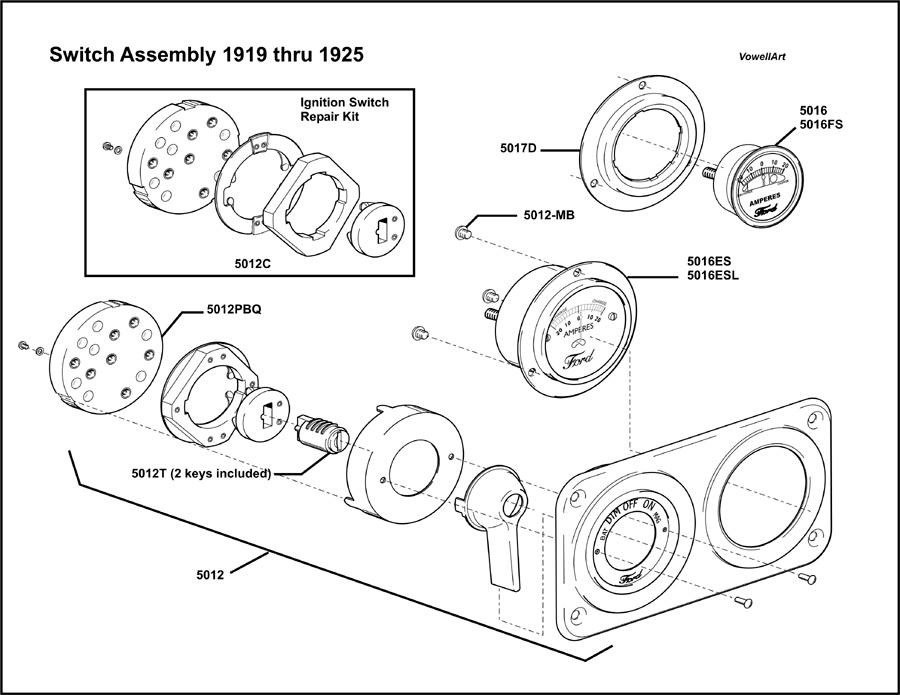

Is your wiring new or old? Does it have a main fuse? Might need to rewire with new harnesses. Since all the wiring goes through the switch, have you checked that out? Switch contacts sometimes get gummed up and lose contact. Might need to be cleaned and contacts re-established. I was not sure what kind of switch you had, so I sent drawings of all the 1922’s. Good luck. Jim Patrick

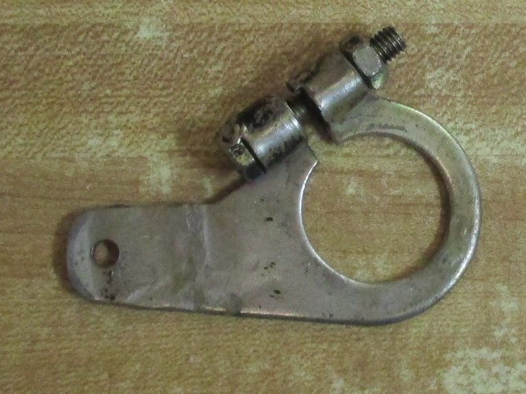

I just went through that problem on another T with a distributor and found not one, but three problems.
1. The manifolds to engine connection did not have rings and glands and a backfire or two had blown away the gasket material, so the engine was only sucking air.
2. The distributor turned the other way, so #2 and #3 plug wires were reversed.
3. The connection between the distributor and spark adjust rod was loose enough to let the distributor cam turn the distributor too far.
