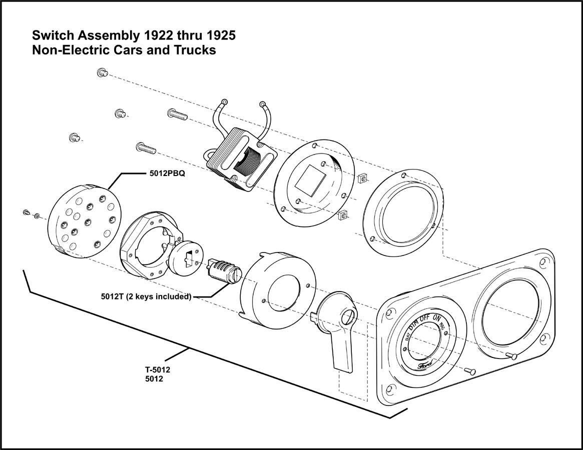

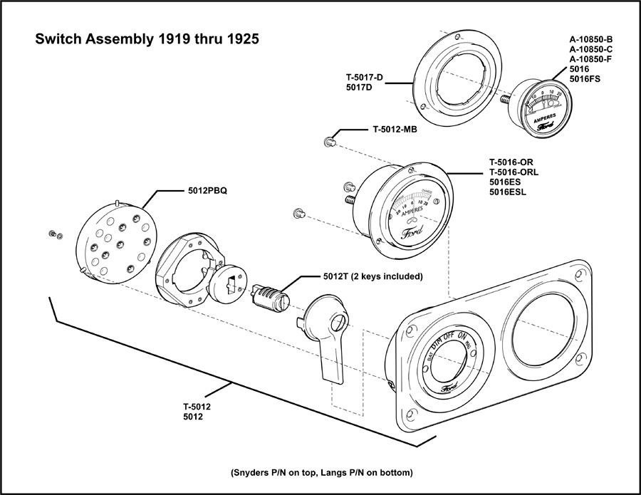

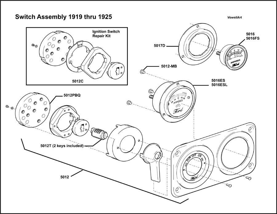

Is your wiring new or old? Does it have a main fuse? Might need to rewire with new harnesses. Since all the wiring goes through the switch, have you checked that out? Switch contacts sometimes get gummed up and lose contact. Might need to be cleaned and contacts re-established. I was not sure what kind of switch you had, so I sent drawings of all the 1922’s. Good luck. Jim Patrick

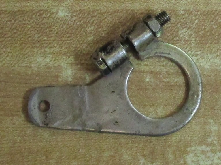

OP is running a dizzy. I have had experience with a southern supplier's unit where that did happen. The gear shaft had nothing to keep it in place. A simple set screw under the upper ball bearing did the trick.Jerry VanOoteghem wrote: ↑Sun May 05, 2024 3:49 pm3) Please explain how timing slips.speedytinc wrote: ↑Sun May 05, 2024 2:33 pm
3) pull the distributor cap. Does the rotor turn? A timing check may be in order to confirm the timing has not slipped.
4) with the distributor cap off. Set with the points closed by hand cranking. Turn on ign. With a screwdriver open the points several times. You should see & hear a spark.
4) Doing as described above should cause the ignition coil to fire. In addition to the process given, pull the coil wire from the center of the distributor cap and place the end of the coil wire near near ground. Then, when you manually operate the points, there should be a spark to ground from the coil wire.
Also the drive gear , if not keyed & the nut gets loose, can slip out of time. One of them units relied on cam nut pressure only.

I just went through that problem on another T with a distributor and found not one, but three problems.
1. The manifolds to engine connection did not have rings and glands and a backfire or two had blown away the gasket material, so the engine was only sucking air.
2. The distributor turned the other way, so #2 and #3 plug wires were reversed.
3. The connection between the distributor and spark adjust rod was loose enough to let the distributor cam turn the distributor too far.
