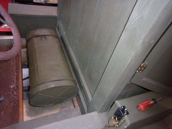

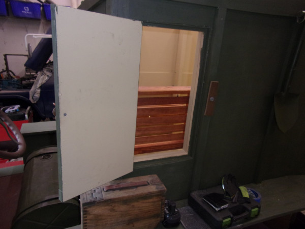

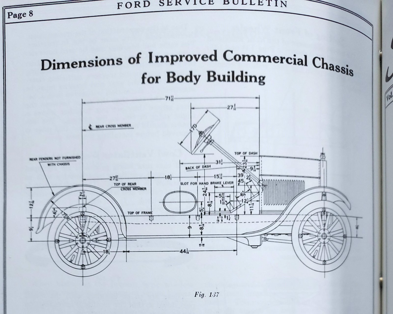

Here is what all the fuss is about. I'd like to move the tank all the way back to the division panel without touching. Maybe 2 inches, but we'll see what the net affect is on the bench seat.
Also pic of those bench seats showing how far forward they want the weight in the rear. Two stretchers on floor would bump the handles up against the division panel with hole cut in the tail gate for the rear handles to stick out.

- Posts: 6798
Re: Moving gas tank rearward?
Raising the fuel tank and moving it forward both help with fuel supply. Think of the improved 1926-7 cars with the fuel tank in the cowl. The lower you go and the further back you go, the worse it gets. My Duncan and Fraser roadster has the tank in the turtlledeck behind the seat back. This backward step is compensated for by mounting the tank approx. 5" higher than standard.
- Posts: 2278
- Last Name: Juhl
- Location: Thumb of Michigan
Later cars were a bit of a tighter fit. Since this is supposed to be a WWI ambulance, you might want to go with an earlier style steering wheel. They were smaller in diameter, 15 (14.59) inches compared to 17 inches in a 1926. It would also be wood painted black (or maybe OD), not Fordite. I believe the spider is a little flatter in the 26 which would put the wheel back even farther.

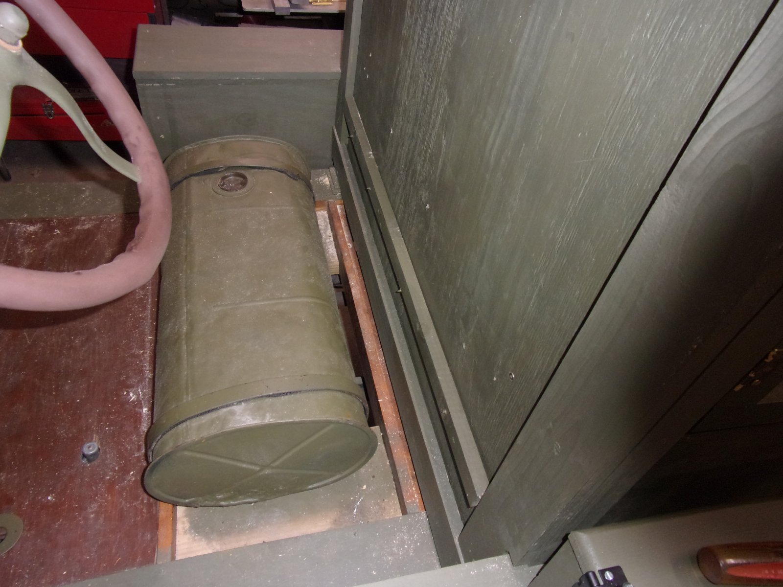

Here is what it looks like after the approx. 3" relocation. I've left it on the sub frame, so it is still 3/4" higher than Henry had it. Took off my glass bowl fuel strainer and noticed that bubba had welded on a larger threaded nipple to the tank so that the standard potato will not fit unless I screw on a bunch of adapters and that lowers the fuel line connection. So, I'll leave it as it has a screen filament in it as well as a shut off and fo from there.
I've got several steering wheels in stock, so I will look at a smaller wheel or a more depressed spider to get the wheel out of her gut.. And, I checked to make sure my steering column mounting flange was on the hood side of the firewall.
Talk about tight, we made the rear box to Ford specification and it is 48" wide and 48" tall. It is like a dog house in there.

While piddling with the revised seat frame today, I noticed that the tank straps are actually drilled through a 2x6 board laid flat as part of the sub frame for the former depot hack. Then through the original holes on the frame. I can pick up this board as it overhangs the inside top of the frame and move the straps in a little and mount to the board and not have to drill new holes in a stock T frame. I have just enough wiggle room to allow the tank lid to unscrew without interference from a strap.
After moving everything back 3" I now have a 3" gap in the floorboards to where the depot hack had a cross member rabbited for the large flat floorboard with the starter switch hole and hand brake notch. So I need to fill that gap with lumber and all should be good when painted OD green or stained dark walnut as I plan to do on the floorboards to hide wear and tear.
Cut the new seat bottom boards, I am making two seperate seats so that only one section needs to come out for filling the tank, which it seems I will need to keep topped off.

So the point of the last post was that my tank is sitting 1 3/4" on top of the stock rail, so fuel starvation should not be an issue as much as a stock pre 26 T. Probably part of the reason why we had a steering wheel clearance issue. My new seats will clear the tank by about 1/2" and the forward seat riser is literally touching the tank straps. It is held in place with four screws into screw blocks.
