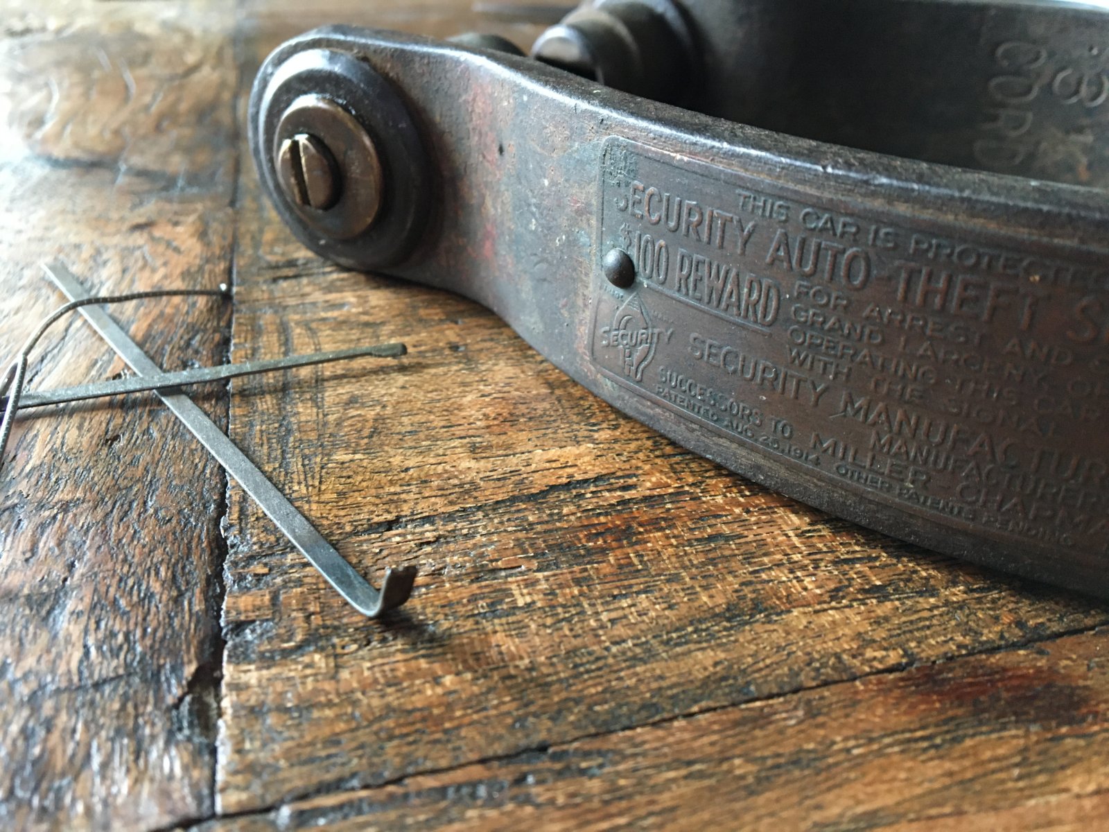

How does the lock cylinder come out?
This one has no key, so I picked it, but I can't figure out how the cylinder comes out to rekey it. It's a Corbin keyway. Searches show it looks like their old cabinet type. (Ilco1000G)?). Has anyone dealt with this?
What key does it take?
When it opens, does the key just turn, or does the cylinder also "pop out." If so, do you have to turn it to the right? (I picked it to the left and I'm trying to avoid having to do it again.)

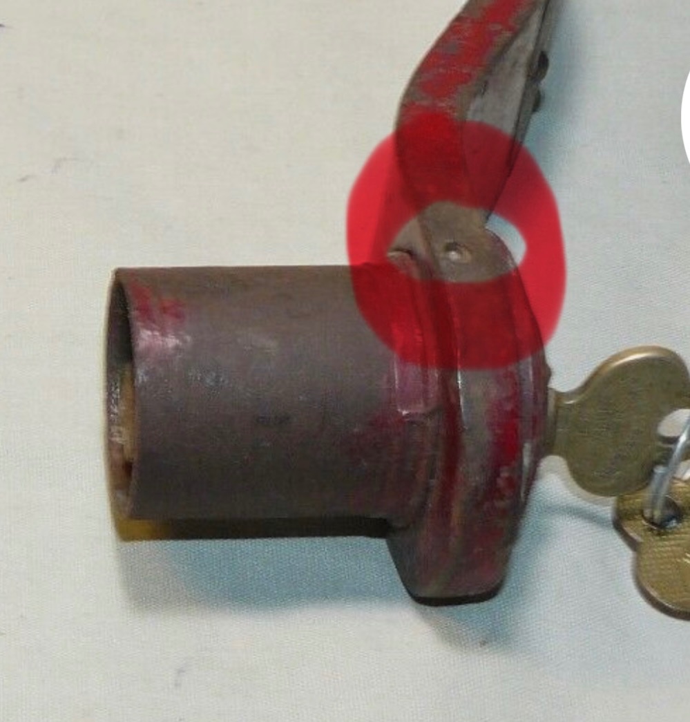

There should be a pin holding the lock in the cylinder. Usually it would be around the edge or someplace. You have to clean off the paint and rust to see it because it’s usually ground flush and smooth. It might be other places too so you have to look closely. I currently dont own a lock like that , but remember from having one years ago.

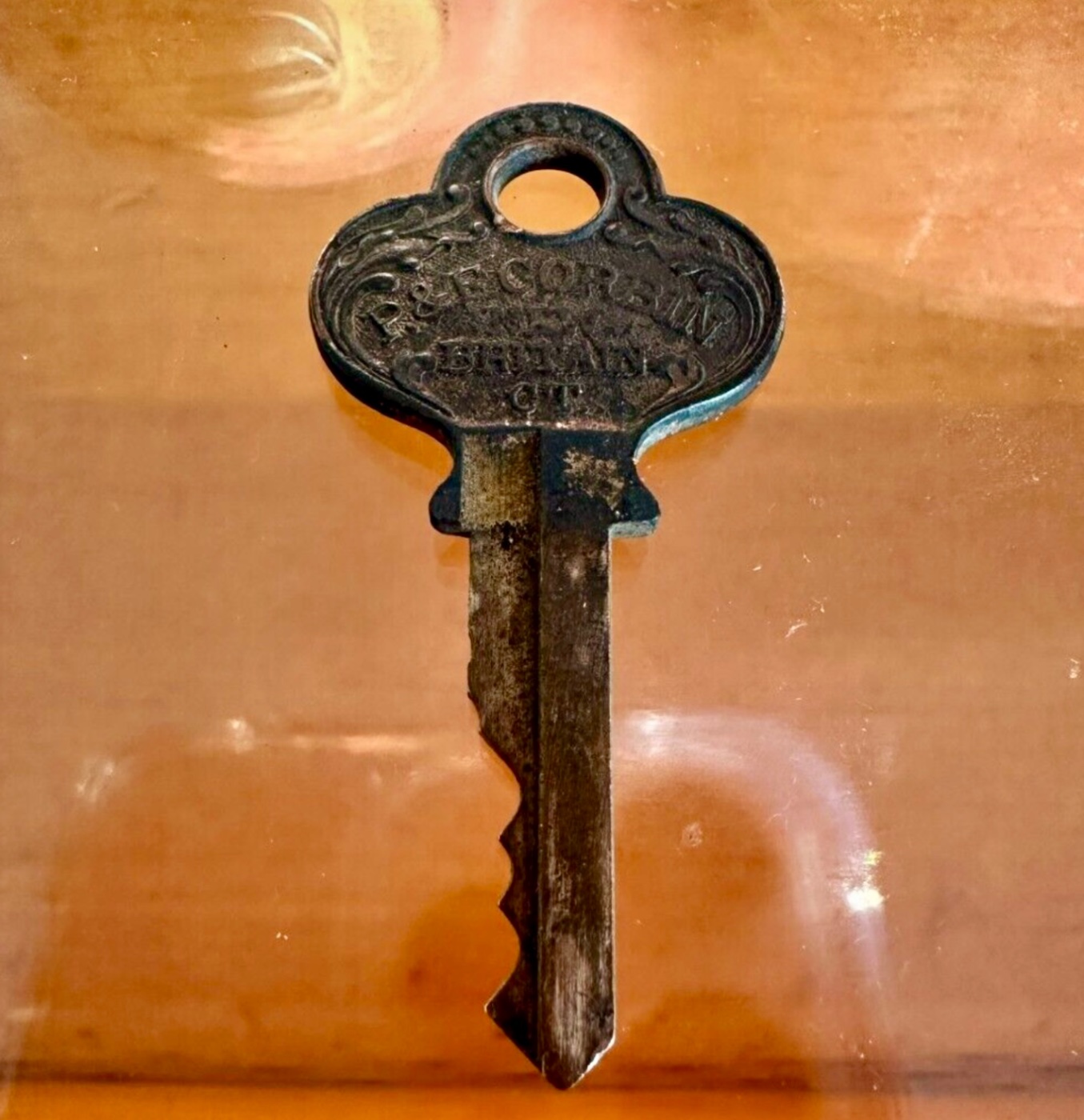

It originally used a Corbin key. This was from an eBay ad of same model of lock.

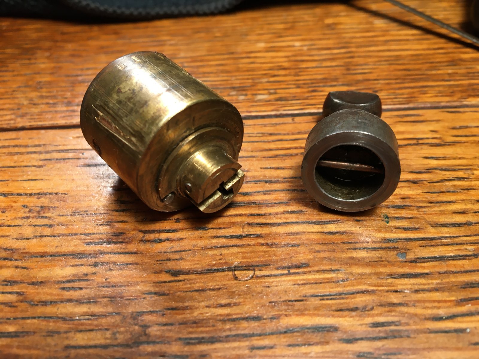

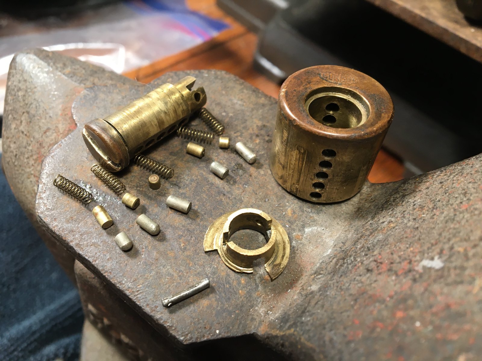

Lock Cylinder Pictures.
I accidentally let the lock turn so I had to pick it all over again. It took forever. The tolerances are too tight for shimming.
There are two new pins. And a hat. The "big" pin on the back stops the hat from turning one way, so you may only unlock by turning the key 90 degrees to the left, this pin won't let it turn right, or past 90 degrees to the left. And the smaller pin goes right through the hat and the shaft to keep the hat on the shaft.
Do not lose any tumblers! They are thinner than the ones in your modern Schlage or Kwikset kit.
