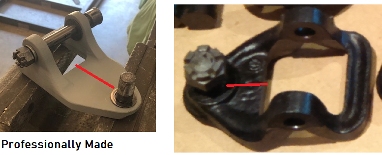

The issue with almost all aftermarket rear shocks have with accessory brakes (AC, RM etc) is that their perch doesn't clear the additional thickness of the drum. Snubbers are a possibility as are friction shocks OR have a rear perch made to clear.
I was fortunate to have some made for Hassler shocks as my project unfolded I wasn't sure if I was going to use them. Someone was looking for them and the "professional" maker wasn't ready to make another set, so I sold mine
but the idea should work for others

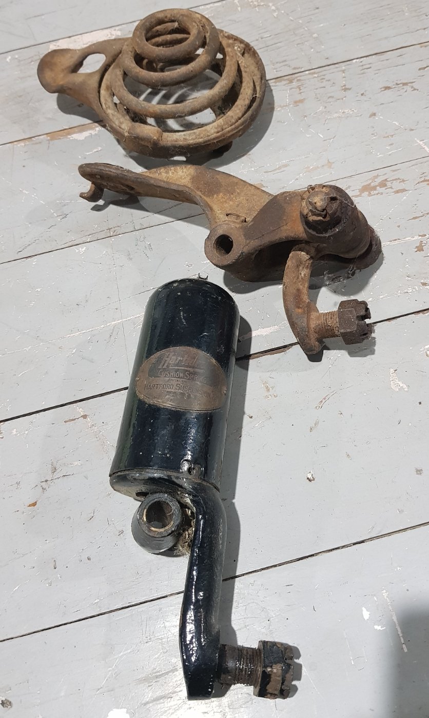

I don't know much about them, but was given these Hartford branded units, and assume they fit a T?
What I thought looked promising was that they don't sit over top of the drum like the Hasslers do in the top of the picture (or as per Dan's pictures) which I always thought would interfere with the AC bands.
