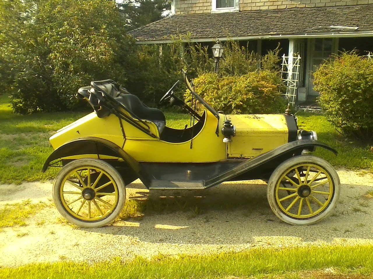

A couple of points to ponder from a former 1912 Metz owner.
I used to have a slightly mixed up 1912 Metz. Overall a fun car, but a few things to be aware of going in. The 1912 is a one year only model with different wheels and rear axle than the '13 up Metz. It was the first year of the 4 cylinder Metz, and guess what, like many first year models it had a few less than desirable features that were changed for 1913.
The wheels are designed to be quick dis-mountable and are actually reversable to change the track. The wheel center has a straight bore that slides over the hubs (both front and rear) that are mounted on the axle. Then the wheel is held on by a SINGLE bolt that goes through the hub in an off center position to act like a key to keep the wheel on the hub. Similar in general principle to the very early Ts. As a result, once there is a little wear on the wheel center or hub the wheel will wobble going down the road. And if the single retaining bolt falls out, or breaks the wheel can come right off. It very nearly happened to me when one retaining bolt broke and only half a bolt was holding the wheel on and the tension of turning was holding it in place. Very nearly lost a front wheel at speed.
And it has an odd rear wheel brake design that are built in the axle ends and rear hubs. The brake assemble a multi-disc friction brake designed on the principle of the T transmission multi-disc clutch. On mine the grooves were worn in the axle and wheel hub and the brake discs would not move properly to provide good brakes. Similar to what happens when the T transmission discs wear grooves in the drum. The previous owner of mine had installed a mechanical band brake on the jack-shaft that drove the chains to the wheels. Similar to the T, if a chain broke the brakes would be lost. And there is no back up emergency brake either.
On the fun side, the car is light and nimble, but flat out on mine was 33 mph. And it was a bit scary at that speed knowing the wheels and the poor brakes. Changing the drive sprockets on the jack-shaft would have allowed it to go faster, but I didn't get that far.
By the way, the shift lever travels in a quadrant with notches to provide fixed gear ratios. It's not entirely a "infinitely variable" transmission.
These features were changed in 1913. The wheel hubs were more conventional like Ts and the rear wheel brakes more like other period band brakes.
I sold mine to make room for another project. Otherwise it might still be in the garage.
If you can live with these idiosyncrocies, then you will be fine. But I would recommend a good inspection to see if these features are on this Metz and perhaps a test drive before making a final decision.

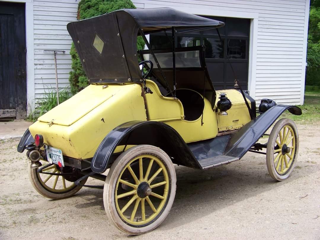

I have been reading this thread with great interest because I own a 1914 Metz Model 22. I live in New Hampshire and am a bit far from New Jersey to look at the car which you are interested in and way too far from you to schedule a driving lesson.
Your understanding of "drive ratios" between the drive disk and the friction wheel is correct.
As you have likely discovered, the Metz has a shorter wheelbase than a Model T and the car is lighter, that lighter weight and a true 22 horsepower engine give the Metz a sprightly performance. They are fun to drive.
They are also a handful to operate. The pressure pedal does require varying its setting to change the pressure of the drive disk against the friction wheel. The pedal locks into place with a ratcheting feature to relieve the driver from having to keep the right foot on the pedal. To release the pedal you rock your shoe using the ball of your foot to disengage the ratchet.
The brake pedal (left foot) serves as the service brake AND the parking brake. You depress the pedal as far as it will go and set the ratchet (as with the pressure pedal) and that locks the rear brakes. When driving and you need to slow or stop, you depress the brake pedal using the ball of your foot to avoid ratcheting into a fixed position. You genuinely must be on your toes while driving a Metz.
Oh, there is no ignition advance lever because the magneto timing is fixed. The hand throttle is in the same location as on the Model T, but it is reversed: down is closed and up is open.
After a day of driving my Metz the Model T feels like a modern car.

And my 1914. The turtledeck was new for 1914 along with some "1914 Improvements" as touted in the advertisements bragging about winning the 1913 Glidden Tour.

For those of you who are following Bob's Metz exploration and education, I have replied to his email and we are continuing our conversation.
The beat goes on.
Another image of my '14 Model 22 Torpedo Runabout
The beat goes on.
