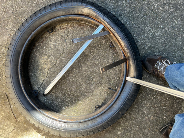

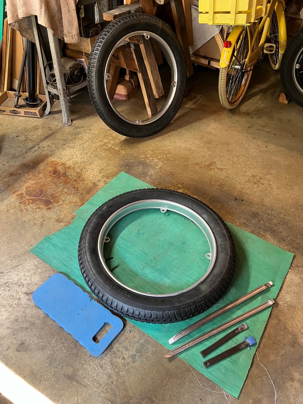

MY way--- No flaps, Rim strips.Two Long CHROME Harbor Freight tire irons ($8 ea). Baby powder dusting and GoJo for a lubricant. wheels on the vehicle. Warm weather and sunlight helps. I do not want to open the flaps controversy. This method works for me a 75 yr. old senior. Colonial Heights, Va.

Struggle with installing clinchers? Been there, done that. Removing old, hard tires? That too.
I agree about irons. Changing tires with original Ford irons is the job from Hell. The cheap HF two-footers greatly reduce the trouble. Ask Mr. Archimedes.
Yes, changing tires is easier with the wheel on the car. With the stem at the bottom, you can let the wheel down just enough to keep the tire in place, with the stem in its hole.
Flaps? If I ever used them I don't remember it. Ford didn't use them, and neither do I. With good enough rims, flaps are superfluous.
Install both beads together, not one and then the other.
Don't just buy "tubes". Know your brands. By all reports Blockleys are best. I haven't tried them because it saves money to buy rubber-stem tubes (Blockley doesn't sell them), cut off the stems, and install my own metal stems gathered on the cheap at swap meets. For my uses, Hartford tubes have proved quite adequate. After a bad experience with Custom Classic tubes, I avoid them.

My old knees don't appreciate the concrete anymore and I do most of the clincher tire mounting for the local clubs so I finally purchased a manual motorcycle tire mounting machine - had some special "spools" made to hold the rim tight and sure made my job alot easier !

All my T's have demountable rims, so i do all my tyre changing off the car on a waist high table. This is much more comfortable than working with the tryes on the car.
The Blockley tyres are a gem to fit. They are soft and pliable and could almost be fitted with Henry's stubby little original levers. With the 15" levers I have, they are a cinch. How much effort you make depends a lot on your fitting technique, and then the tyres you are working with.
There are three things I consider "must haves" when fitting clincher tyres.
