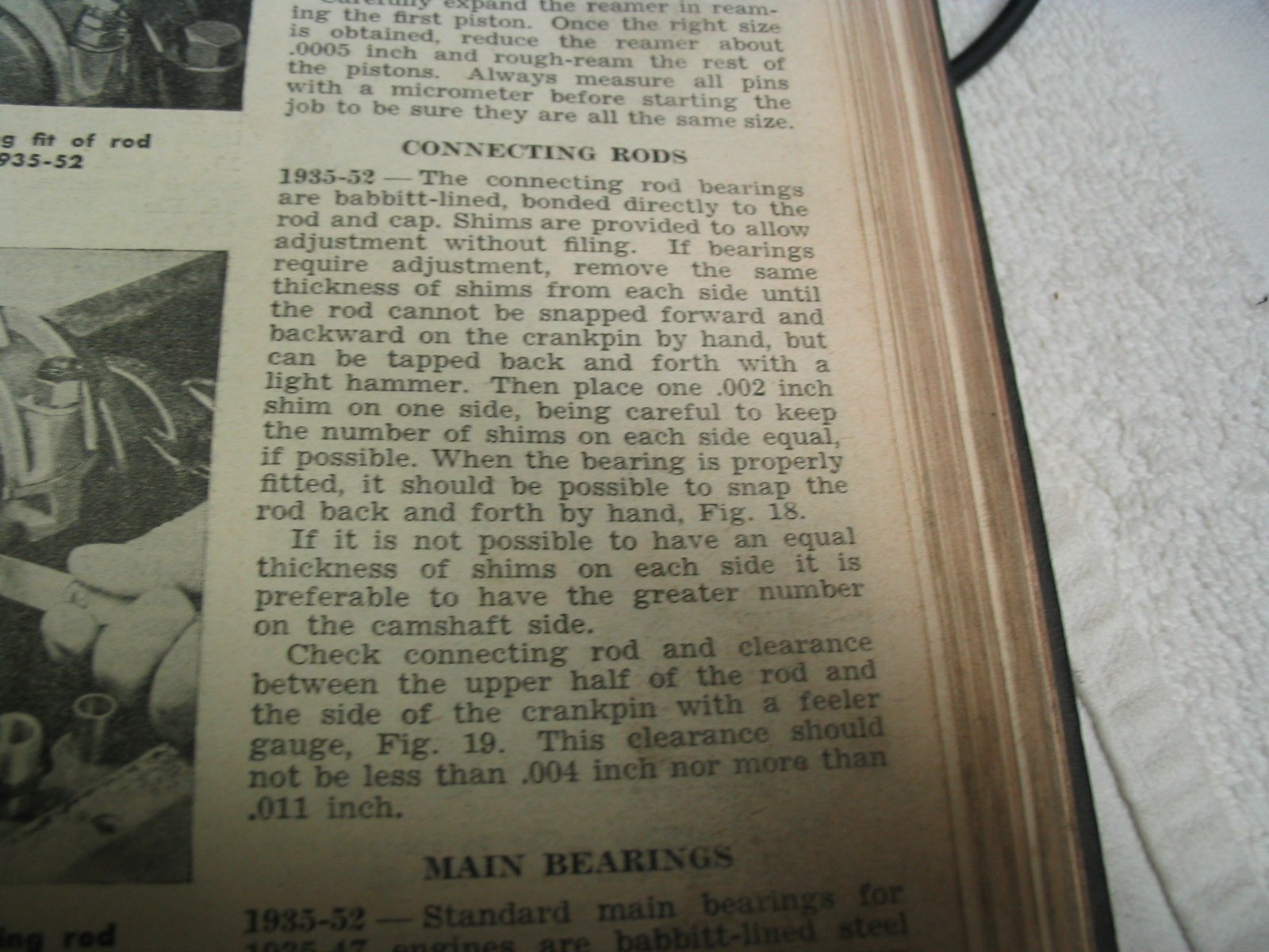

Up until the 50's the 6 cylinder, Chevrolet used poured Babbitt rods with inserts on the mains only.

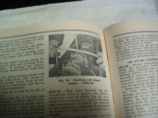

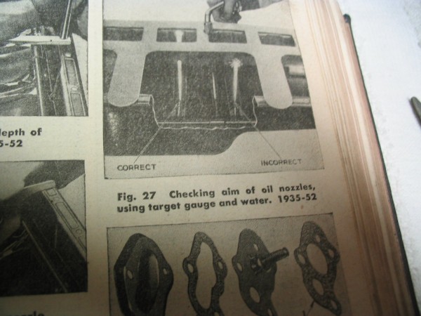

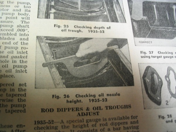

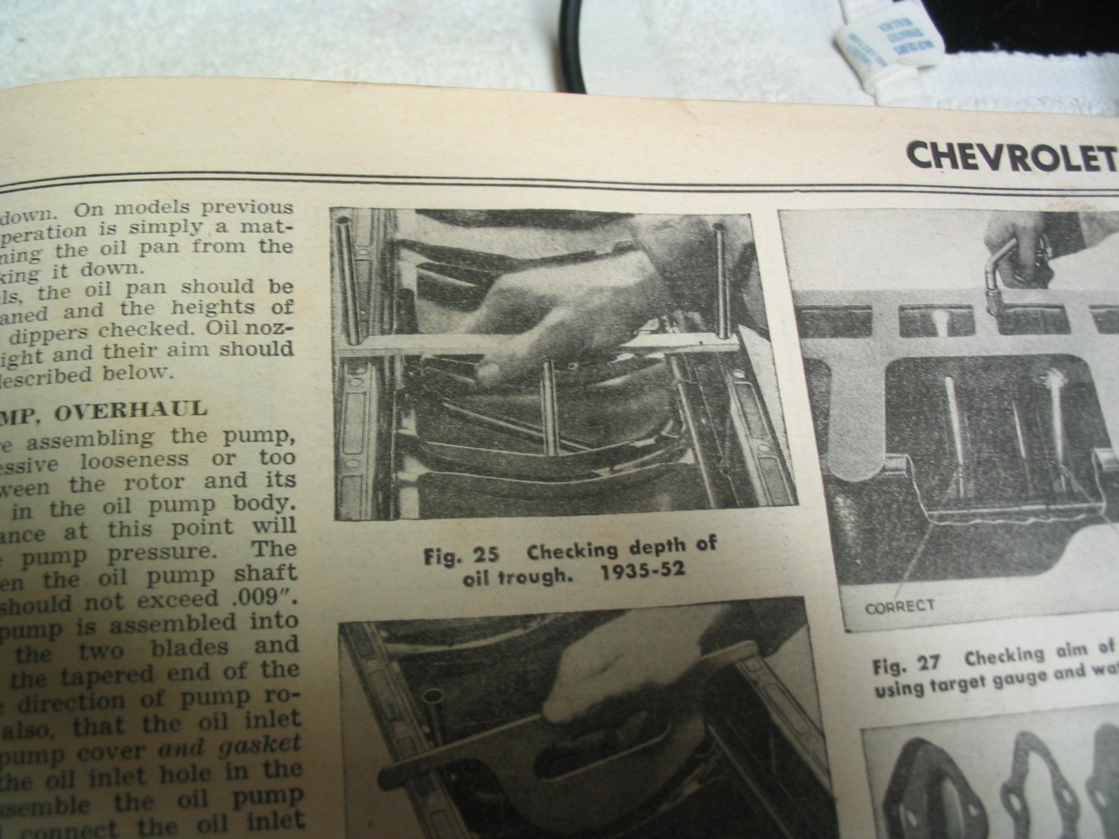

Re: INSERT ROD BEARINGS--LONG TEM REPORT?
Kevin,
Do you know how many degrees of the crank rotation the oil spray set up would hit it's target of the dipper? would it be more than the oil dip of a T ?

Frank, I don't know the target info in crank deg's of rotation, the spray hits the dipper a little before BDC above the dip tray that fills with oil, and would hit the bottom of the rod a little after it leaves the dip tray. The targeting left or right is the more important than up or down a little off so that the dip tray fills with oil on the rods up stroke.

Thanks Herman for the pictures.
