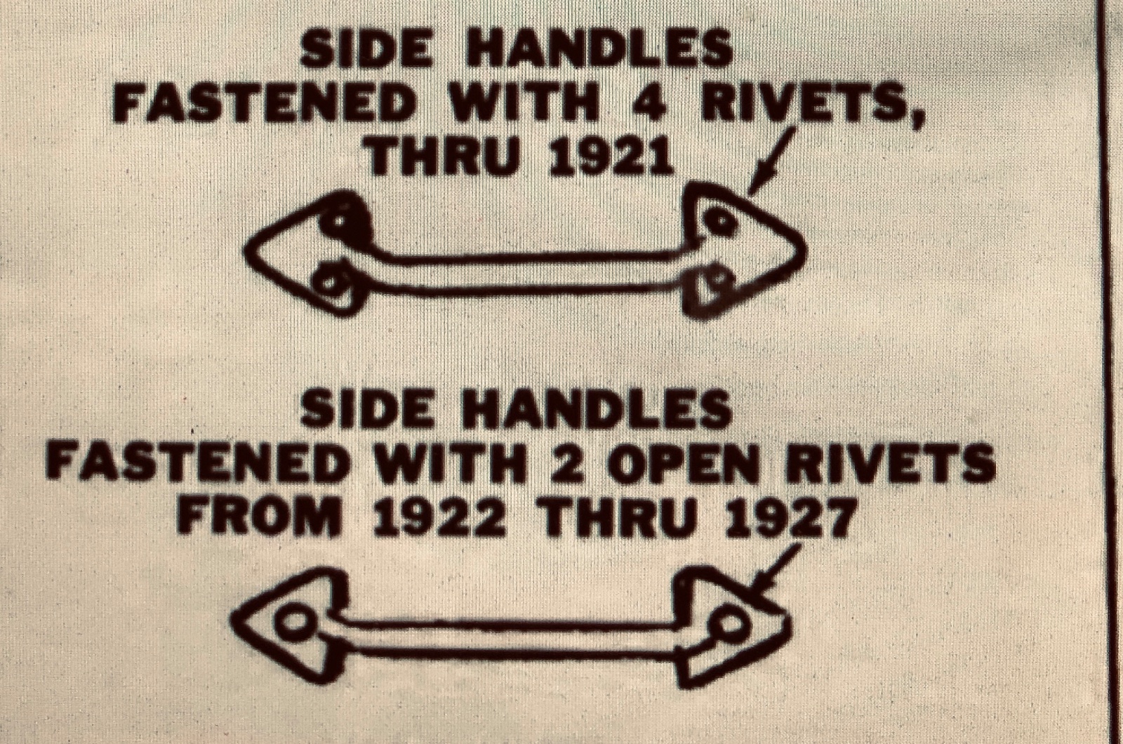

July of 1920 the pressed steel rivet handle was changed to just pressed steel handle pre formed with rolled in hole to secure .
‘13-late ‘15 handles were cast iron riveted, up to ‘20 cast steel riveted.
