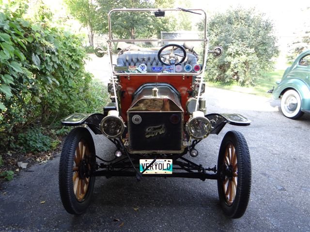

Does anyone have pictures and measurement and attaching point of the leather strap that holds the speedometer cable off the tire when turning or do I just wing it

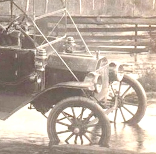

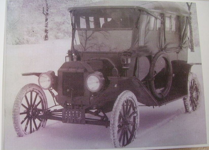

These period photos show some owner's fittings, Ford didn't supply a speedo cable strap.
Appears this one on the wishbone...and useful to keep the cable out of the water
This strap on the headlamp/fender bracket, may have even been a screen door spring added to take up bounce slack, to keep a wide radius for the cable to run true without bending the cable links. And keep it from dragging in the snow and freezing the lube around the links

My car is a 1912 touring Canadian made It will rub on right hand turns. It has never had a strap in 63 years I did not know about the strap until I found the 1918 Steward book online that is the page I posted In Canada our cable housings are steel and it just shows a bit of shine but no damage,so It would go another 63years.

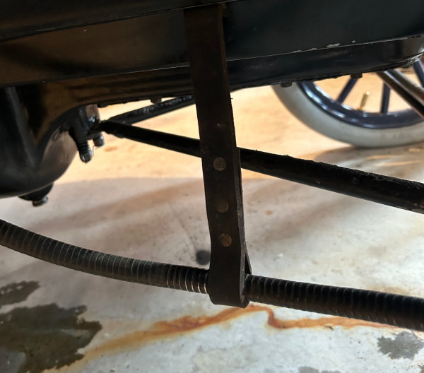

Maybe this is helpful ? My ‘13 came to me this way, cable loop has three flat rivets, working length 7-1/2”. It’s secured to the frame rail with a 5/16” round head machine screw just forward of the carburetor. I have no idea whether the hole in the frame rail was added, or was original.

Well that looks good and keeps the cable straight in the past 3 years I have broken 4 links it is the original cable and chain and the links are getting brittle, keeping it straight can't hurt.

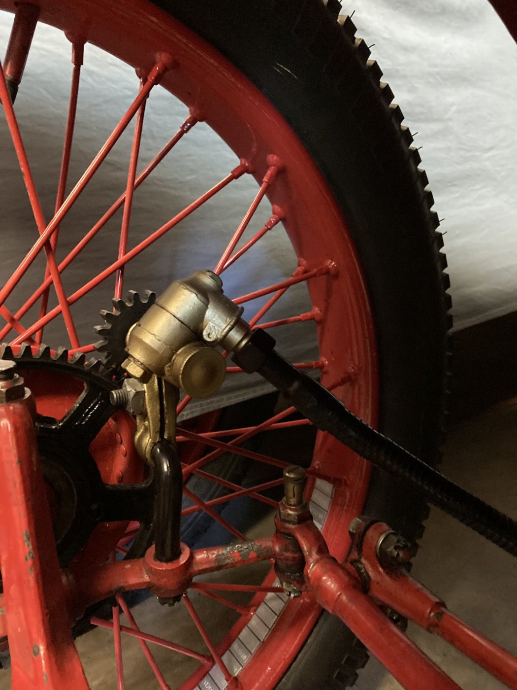

I've worked on speedometers and their drive components for a few years and DO NOT recommend using a support strap on a Model T. The Model T uses cables that range from 48" to 63" and this length is just too short to need a support strap. The cable should hang freely from the swivel to the head. When a longer cable is used than what is recommended, then a support strap may be needed. Here are the length of cables used on a Model T Ford:
1909-1914 - 48" cable
1915-1918 - 45" cable
1919-1922 - 54" cable
1923-1925 - 60" cable
1926-1927 - 63" cable
The Stewart Warner Company recommended that the cable have a graceful bend from the swivel to the speedometer head. A tight bend can cause failure. If the bend is too tight, the inner cable (chain link) WILL fail and break. The attached photo shows the correct way the swivel should be positioned, allowing the cable to go straight out from the swivel and creating a graceful arch. I hope this helps. Russ Furstnow
