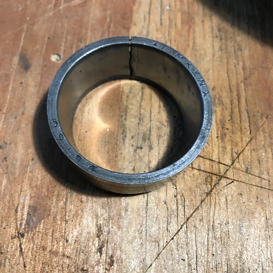

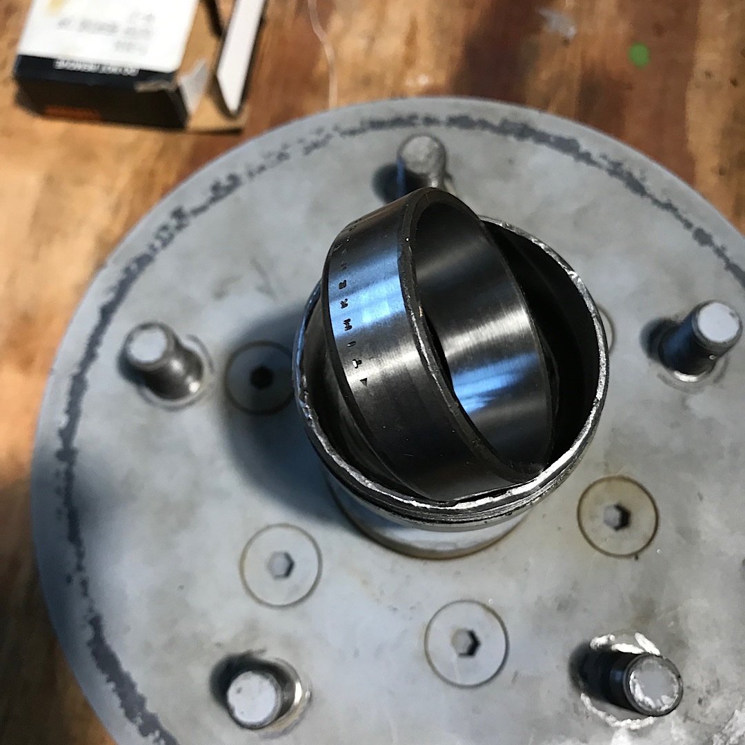

By the attached photos, the outer cup developed a crack and had to be replaced. Once the old one was removed, I dry fitted the new cup.

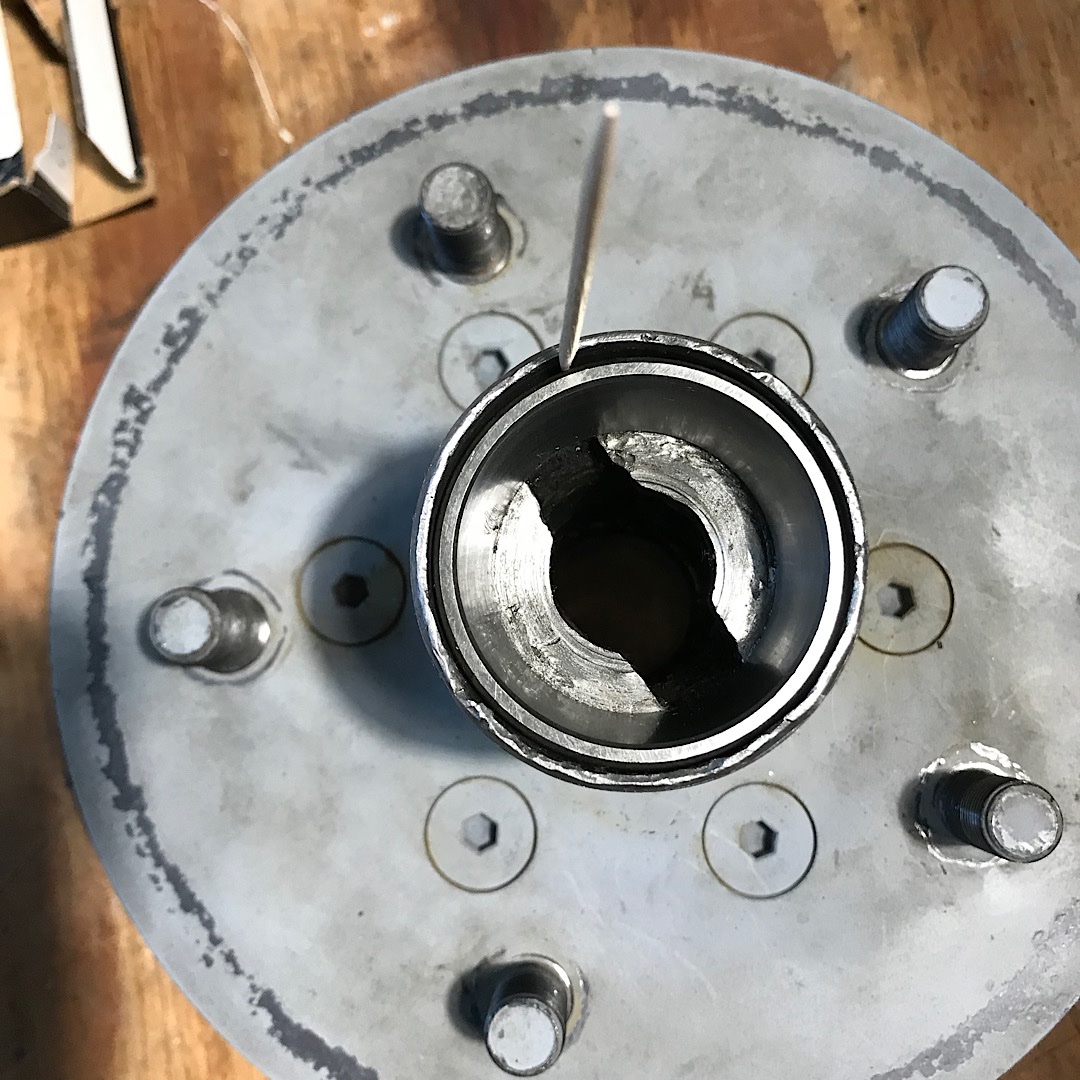

My question is this, does the cup need to be pressed in. Mine just dropped in and has a great deal of slack. Note the toothpick sticking in the gap.

The same force that split the bearing cup also stretched the hub. Sorry to say, that hub is toast. I'm willing to bet that you can't put a hubcap on it either, since the threads will be stretched way too big for the cap to thread on.

Your front hub must be cracked or badly worn, that cup should be a light press fit. I see that you are using 1928-29 Model A wire wheel adapters and those adapters are heavy. I would find better front hubs because those cups must be tight in the hub.

He has a whole toothpick in the gap between the new bearing cup and the hub. Loctite 660 will not fill that gap and it certainly won't center it. The hub is junk...speedytinc wrote: ↑Wed May 29, 2024 10:40 pmThe thread issue is tough, but you can use loctite 660 to set the bearing.

I too think that gap was way too wide for a Loktite product to work. In John's defence, if his W/W refers to wire wheels, there may be a use for it. Those hubs are constricted by the wheel centre, and are a relatively neat fit, so they are not likely to ever stretch as much as this one has, and of course there is no hubcap to thread on.

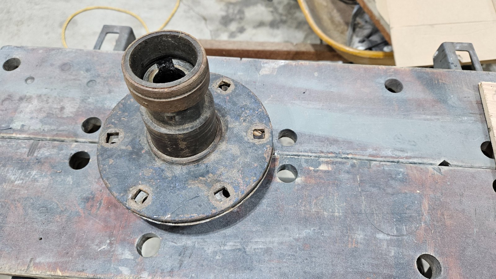

Puzzled.... What is this "hub" supposed to be for? Looks like this Model T Wood to Model A Wire Wheel Adapter not a "hub" per se.
Pictures of it front & back without the race to understand what it is would be helpful
So is the adapter supposed to slide over the existing hub withe the race inside the existing hub.

What I see of the toothpick is the tip in the gap not the full diameter.
The gap aint that big. I would not use the 660 if the gap was out of the listed range.
The 660 does self center when used properly. It solidifies from the metal surfaces inwardly as you rotate the race during the quick cure.
