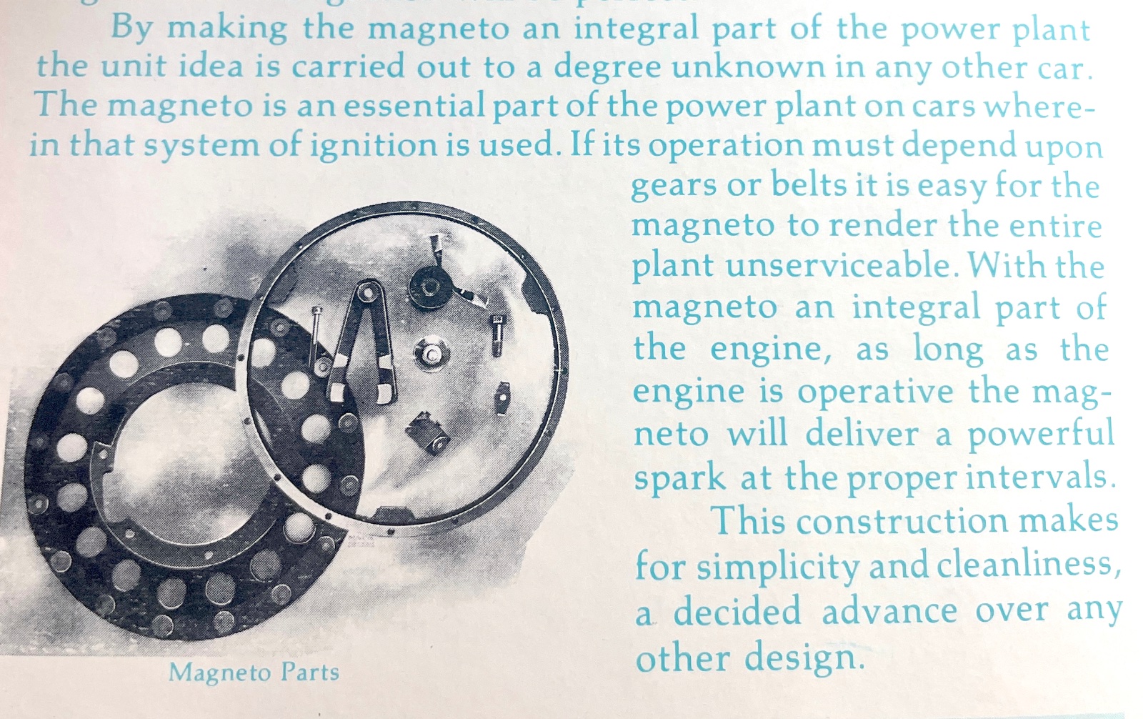

Looking over early sales literature, the advantages of the flywheel magneto get a fair amount of coverage. Early “unit” magnetos were fairly troublesome and undependable.
Once Ford attained mass production on an unprecedented scale, fiddling with design changes would have meant a huge loss of momentum. The simplicity and dependability of the model T was not affected by advances that may have appeared to make it obsolete until well into the 20’s.
