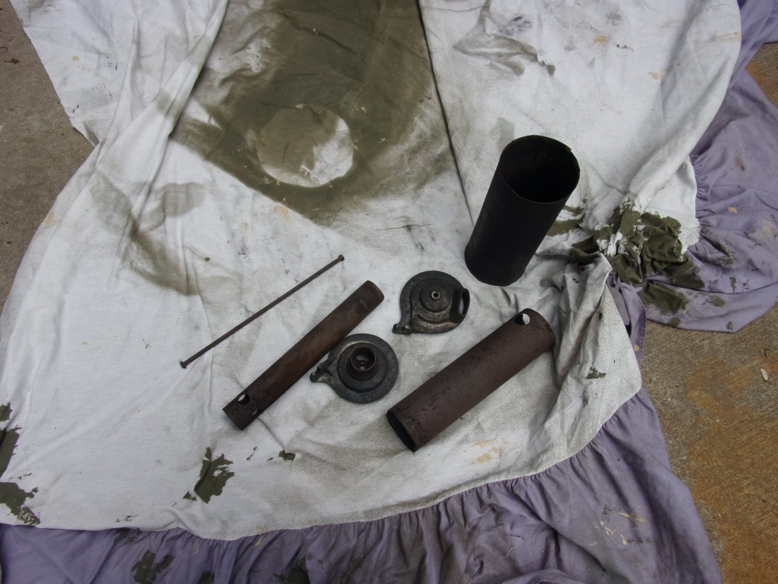

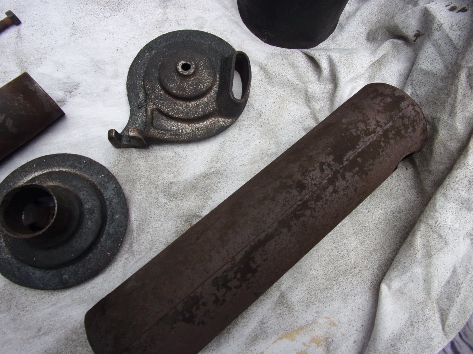

I don't know what I got here...pulled it off the shelf. Repro? Original? But if it helps someone, my shelf does not need to pass emissions.
A bunch of old cars
Sometimes they run.
Sometimes, they don't.
Posts: 7260
Re: Late Muffler Shells
Post by Allan » Tue May 14, 2024 8:26 pm
Robert, what you have there is the last incarnation of the cast end mufflers, just before the introduction of the full length exhaust pipe and pressed steel ends for the muffler. Prior to this one, the cast ends had mounting lugs cast with an open triangle in the web. I will leave the timeline to those more knowledgeable.

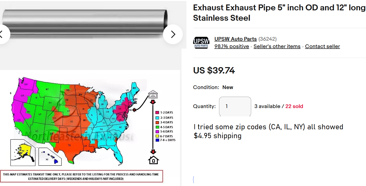

Since I was not looking for an authentic outer shell for my muffler and since my middle pipe and the inner exhaust pipe were rust out free, I found this new stainless 5" diameter, 12" long piece of stainless pipe that fits like it was made for the job; no modification needed, and the stainless is at least twice the thickness of the original steel and will outlast the rest of the Model T and ME.

Terry, where did you find this outer stainless piece? Was it a random find or did you order it from somewhere?

Shannon, I found it on EBAY. The seller UPSW Auto Parts still has an ad currently, however they say they have only 3 left. Their EBAY listing number is 195306884812. The price is $39.74 plus $4.95 shipping, but it is a perfect fit and I didn't have to go scrounging for it. Postman delivered it to my front door.

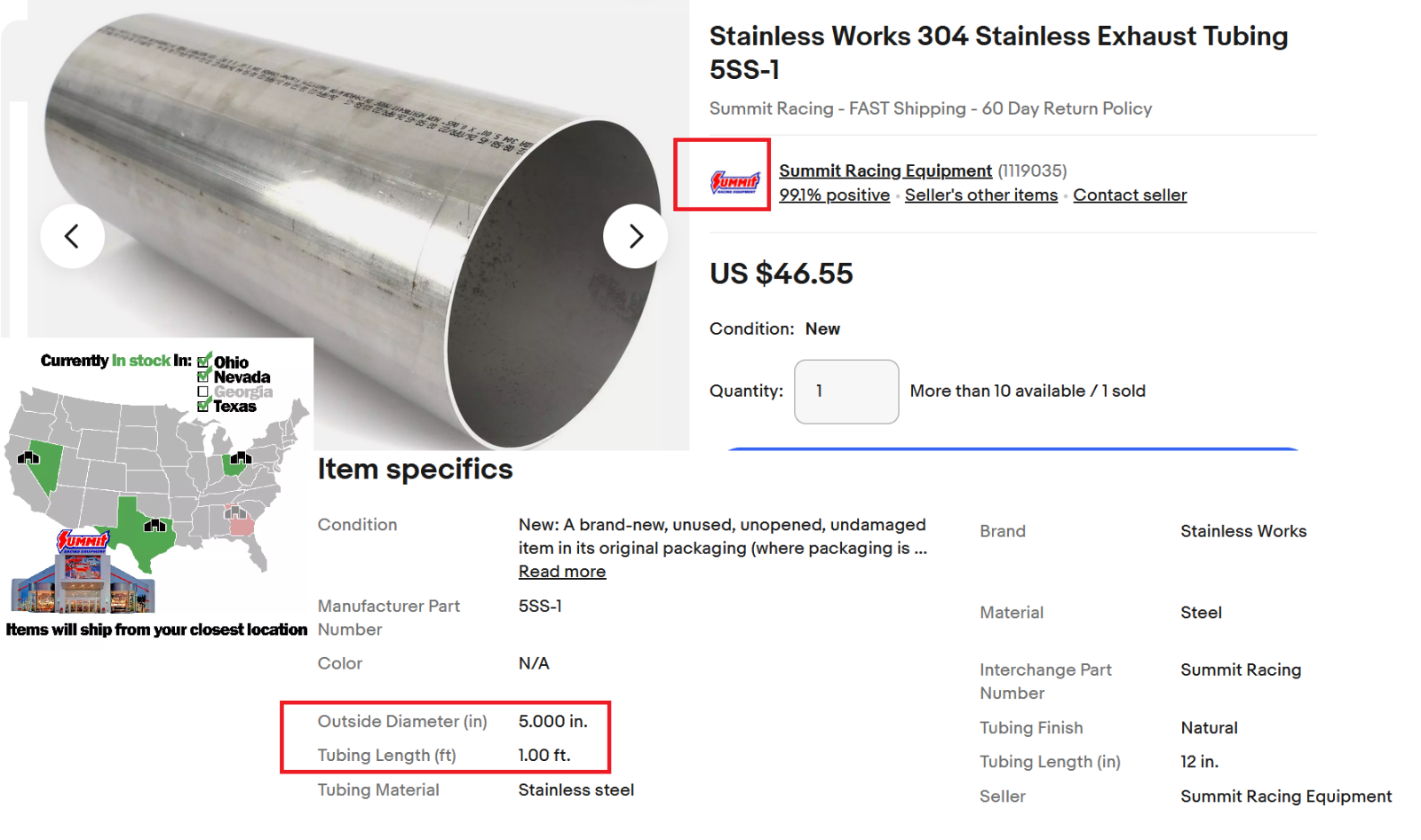

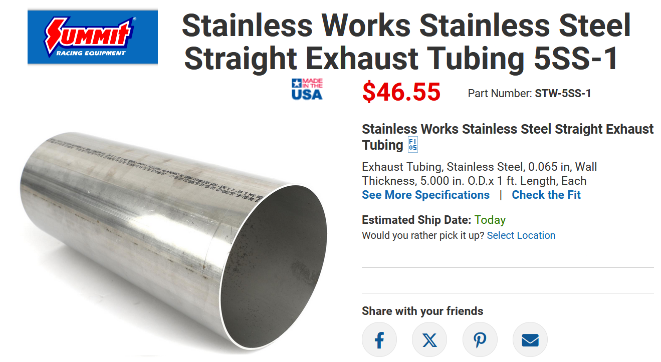

Checking Google
Deal here make's 3 1-footers
https://www.amazon.com/Straight-Mandrel ... d_source=1
Walk in
https://www.summitracing.com/parts/stw- ... gK0Y_D_BwE
Summit on eBay likely this shipping is better
https://www.ebay.com/itm/196273315583?c ... gJQ0vD_BwE

I was thinking that some one might get the Amazon one (also on eBay), cut it, make 3 sell 1 or 2. least cost
If some one is close to a Summit location, can walk in save the shipping and see the goods
