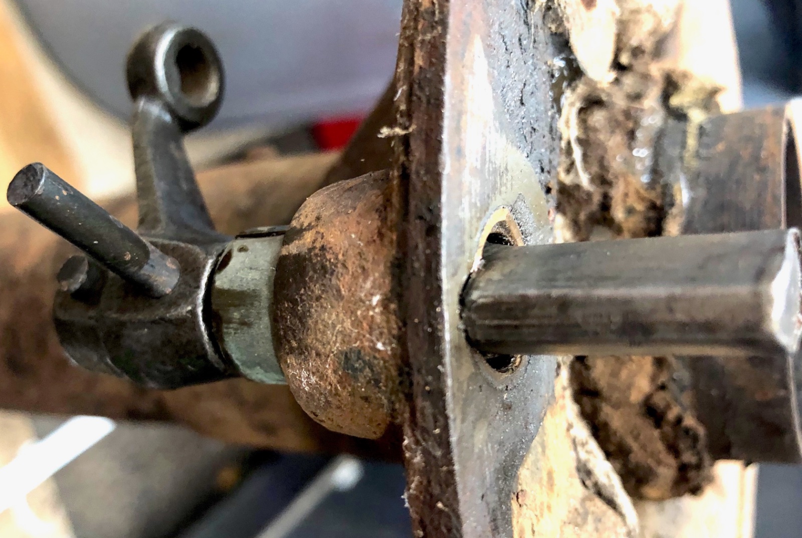

I'm going to be doing this soon-ish on a rear end in the car & have wondered the same, on the stand its not to difficult but on the car by yourself
I will assume it's a PITA. My thought & I have not tried it yet, was to use a nut splitter to force a groove in the pin then turn 90* & make a second
one. Then turn the nut splitter around & repeat. Making a X in the ends of the pin & will not put any undue force on the shaft of the cam or the
bushing. I made a press for removing & installing valve linkage pins on fire trucks I will be trying it also.
I do something similar on U/joint pins. I center drill the pin in the lathe both ends then install a bolt with a very shallow point into the bottom
hole until it supports the pin, then flair the top side with a shallow pointed punch. Turn 180* & repeat until satisfied with the end of the pin.
This takes the load off of the drive shaft bushing.

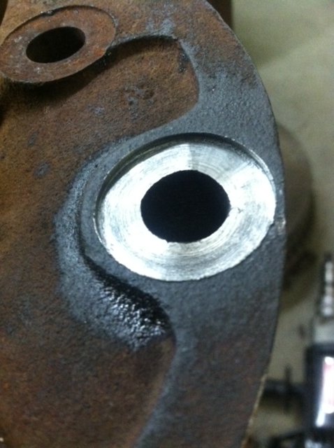

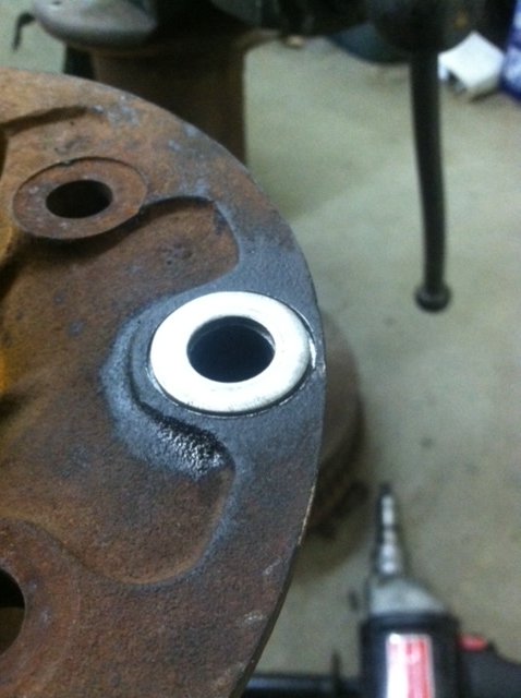

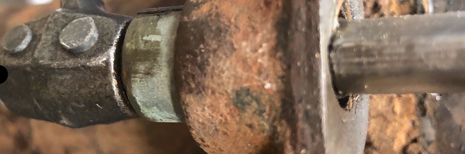

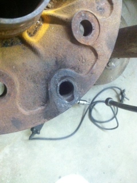

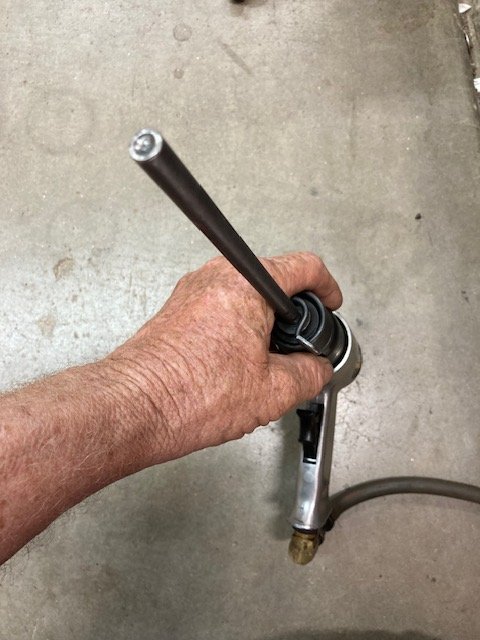

Back in June I made a suggestion for peening brake cam pins/rivets using a nut splitter to press & flare the pins. I'm still thinking it will work
when doing this with the rear end out but there is little need as you have good access to do this when the rear is out. How ever the question was
for ideas when it is in the car. This proved to be undoable if in the car especially if you have RM brakes. So I had to punt on this one! There is
little room to access the pins with radius rods & RM brakes. In fact it's darn hard! so came up with a solution that may be of interest to those
that like making their own tools. Using a valve guide impact driver ( that was miss ordered ) cut the end off & drilled recess in the end with a
ball end mill ( a drill Will work ) This worked great for peening the rivets when backed up with a dolly. I noticed in one photo a worn backing plate where the brake cam had cut into it. I found a solution
to this by counter boring the backing plate & installing a washer for the cam to run on which should prevent that issue. Craig.
