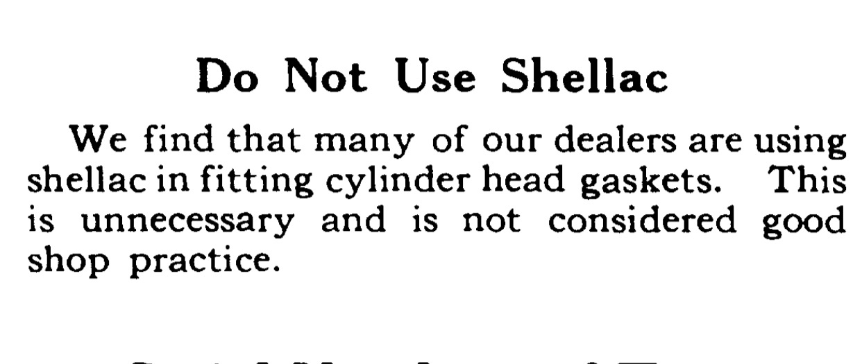

Adam
Posts: 1602
First Name: Adam
Last Name: Doleshal
Location: Wisconsin
Re: Copper Head Gasket
Post by Adam » Fri Jun 14, 2024 9:05 pm
Ford Service Bulletin:
