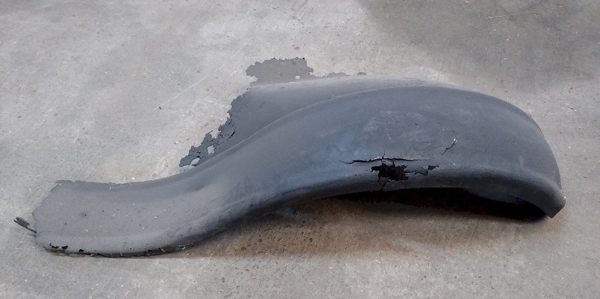

Aside for the sticker shock, I need two front fenders for my 26/27 T project. I'm starting with a 26/27 donor vehicle for my WWI ambulance project so it has the incorrect year chassis, but it is what it is. Original car was depot hack so I have no idea if the original fenders were off a touring or roadster or coupe or what. But I've got the angled attachment brackets and running boards and splash shields from the 26/27 and the frame, so I presume I need to go back with 26/27 fenders. There are no rear fenders on this project, large wooden guard rails.
Almost $700 ea from Langs plus almost $400 for s/h. Eklers wants almost $1k per fender plus s/h, so not a cheap replacement.
Passenger fender is beyond our repair with cuts, rips, dings, dents, etc., and a lot of flat out rot in the running board attachment area. We are not body workers,. And, if we were to replace one, we'd go with both to match the appearance.
So, any other options for acquiring reproduction fenders that I'm overlooking? We presume taking fender to professional for possible repair would not be cost effective and don't know if other years reduce the cost any. I've got the light bar on the headlights to deal with as well. And fiberglass fenders did not save that much money to have to get into the fiberglass body finishing business.
Any insights appreciated. I will post a WTB on the classifieds and hope there is one out there within driving distance from GA.

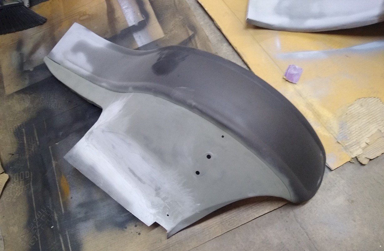

I tried to get replacement front fenders for my 26, avoiding the fiberglass and failed for months. I had to become a body man and it shows that I am not but we are content to have used steel fenders. The before and after are so-so up close.
Vern (Vieux Carre)
