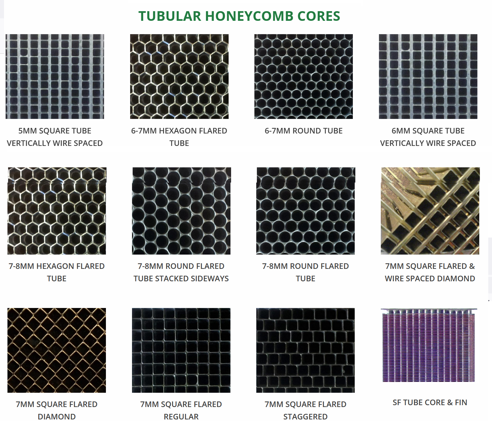

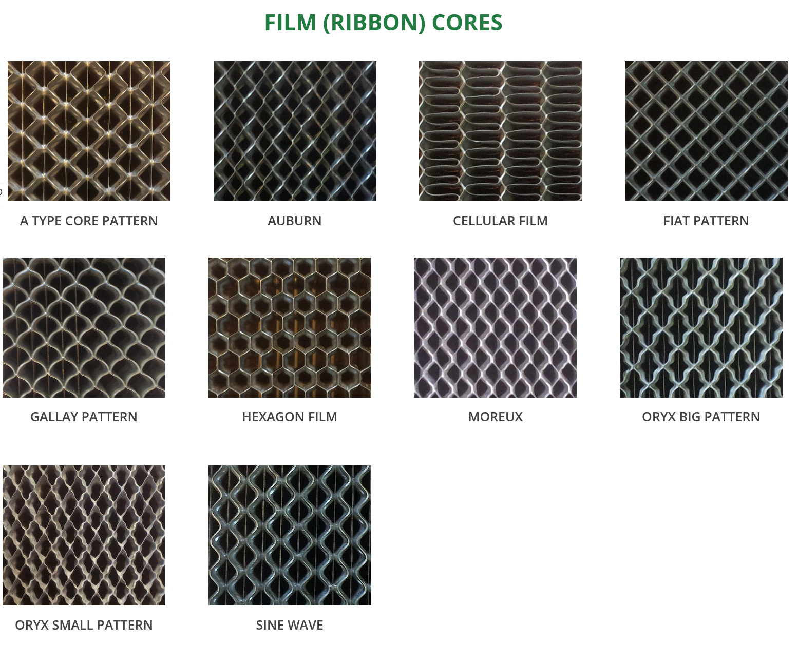

Looks like a good possibility - not a lot of explanation
https://maineradiator.com/restorations/
https://maineradiator.com/vintage-cores-catalog/

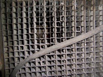

Larry
I went a completely different route with very nice results, rare radiator made new, but still looking old and rare.
The custom bodied T acquired had a special square honeycomb type, that could not be replicated, and even other sources noted, couldn't provide a quote, just saying time, material availability, and transportation costs.
So ended up with Universal Carnegie. http://ucvintagerad.com/
That special radiator core leaked, and note the inside view of the square pocket core, rather difficult to replicate.
Radiator inside core.jpg (78.84 KiB) Viewed 2555 times
The fix by Universal was to replace the core with their own mfg. 'heater core', which functions as a radiator just fine, and my results with the radiator were great, super cooling. BUT...the main thing they did was to SAVE the face of the original core, by cutting off 1/4" or so thickness of the original square core and soldering it over the new core, so from the outside, was the 'original'. Very good result IMO. ;)

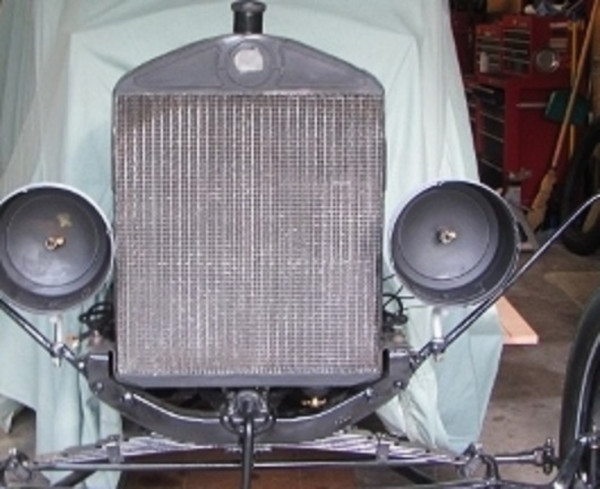

Here is the new/old look:
From the inside
From the outside
