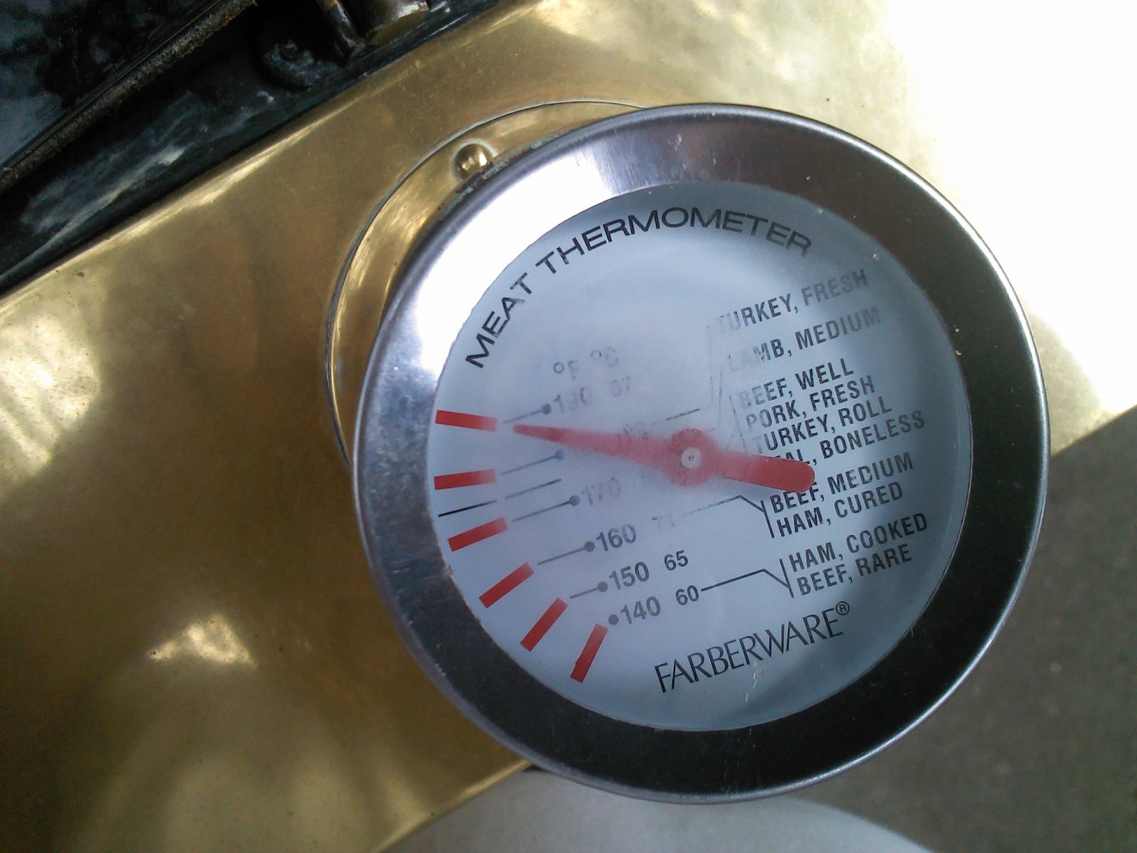

I say no boil but right at the point of boiling. I judge mine by always being able to hold my hand on the water return pipe going back to the block.

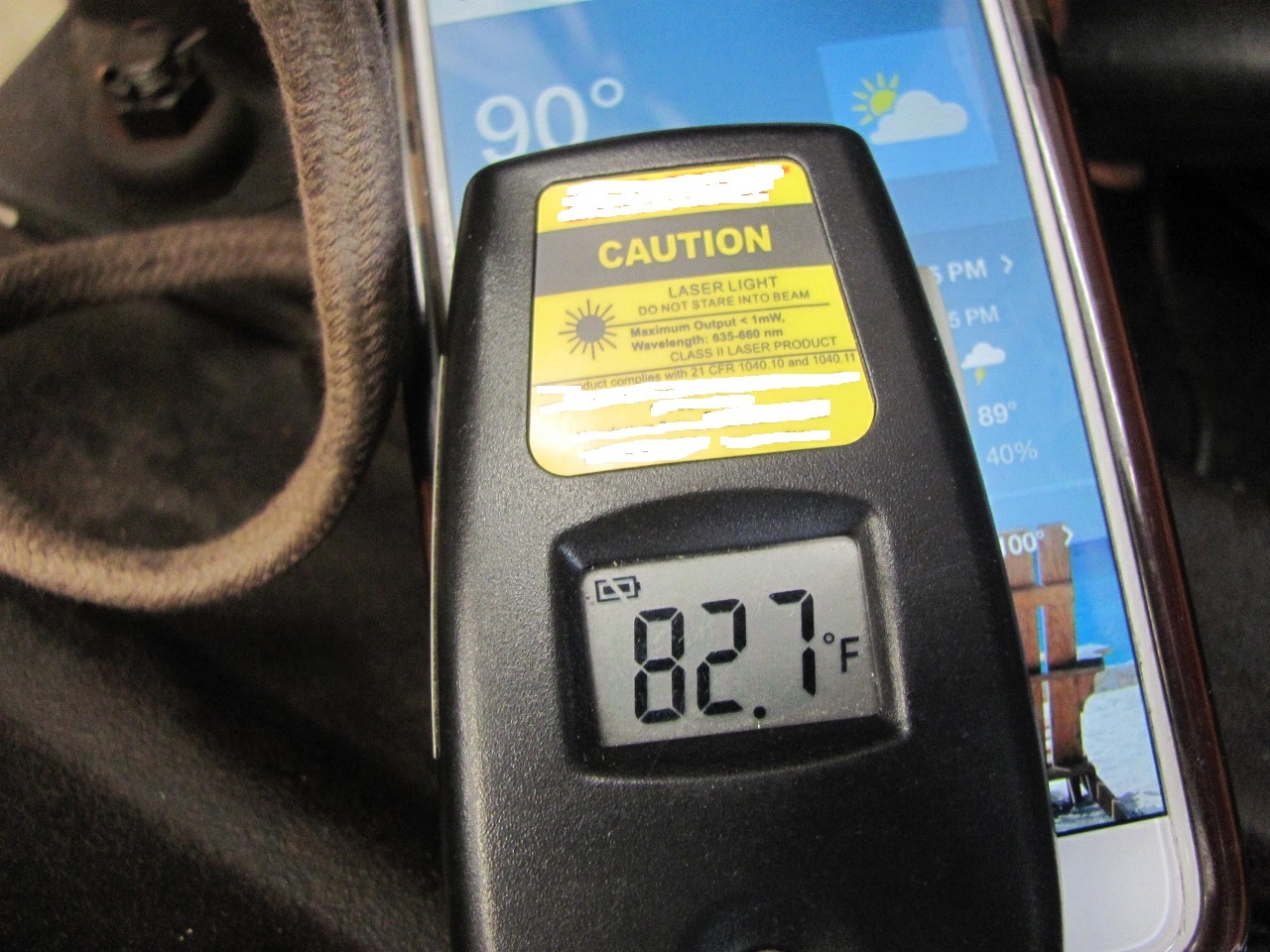

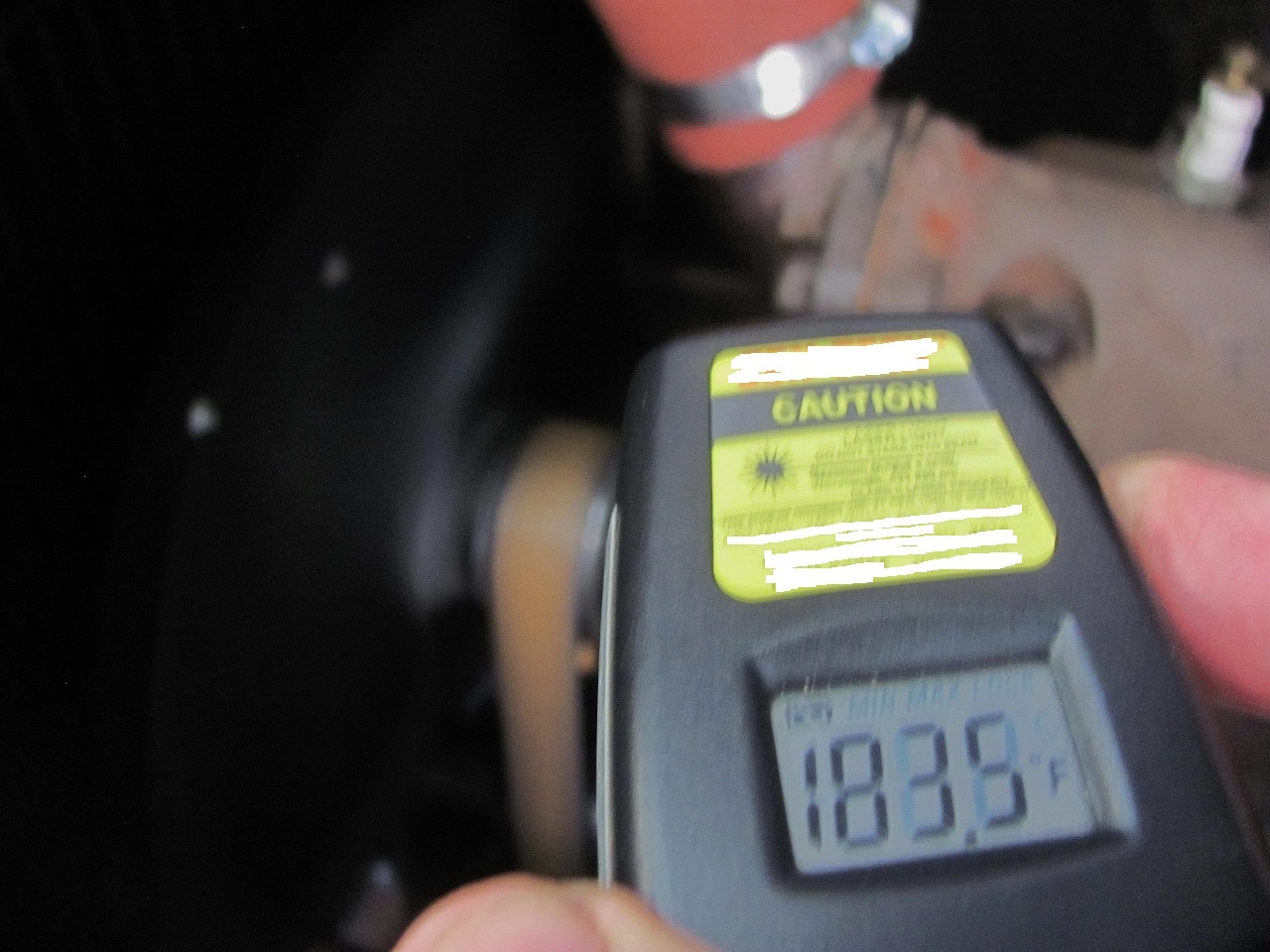

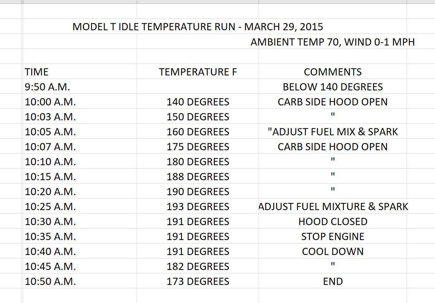

And with a low cost infrared temp gauge, you can test the system for efficient cooling, did that on a typical warm 90 degree FL day.
Pointed the infrared at the upper tank under the hood, and on the lower metal return pipe from the radiator.
Start point, T in garage, upper tank at temp of around 82.
Drove around to warm to operating temp, about 2 miles and stopped with engine idle and pointed infrared at backside of the upper tank , right at normal operating temp.
Then pointed at the lower pipe and temp was much lower, about 62 degrees difference, can touch that pipe as not too hot, of course don't touch that upper tank
Added bonus, with running also a motometer, that confirmed the operating efficiency too, normal reading for summer!

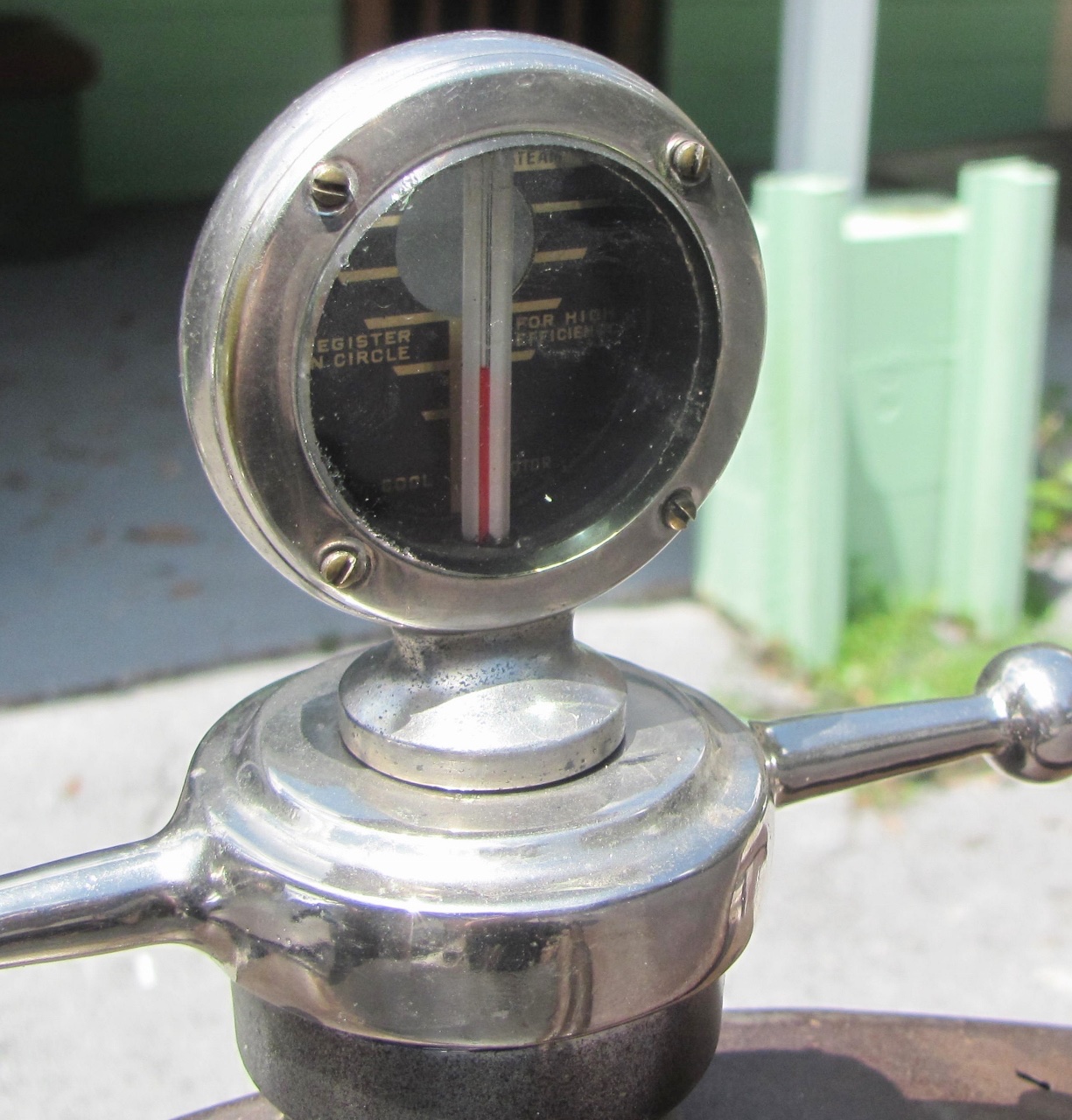

Wonder what temp's the motometers are set to read?

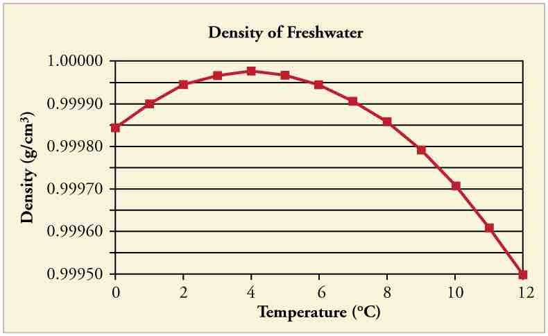

The thermosyphon action is based on a density differential. As water is heated it becomes less dense. Example: the air bubbles that begin to form in a pot of water on the stove. In the cooling system the hot fluid begins to rise and float above the cooler fluid. This action, in effect pushes the fluid into the radiator where gravity and capillary action causes the fluid to fall as it cools in the radiator. The action is also dependent on atmospheric pressure.
If the water turns to steam its supposed to condense in the tank on top of the radiator...but some may leak out through the overflow tube. The loss of fluid will eventually stop the flow reaching the radiator.
The greater the density differential the faster the flow. I couldn't find what "density" differential would trigger the thermosyphon action.

Re: How hot is cool enough?
Vernon,
Yes you are correct. Here is a 1914 that sat idling on my driveway for an hour.
Kitchen thermometer.

- Posts: 6552
Just to review what I had posted earlier. I used the air bubbles as an EXAMPLE to show how the water was becoming less dense as the temperature increases. For thermosyphon to cause "flow", the fluid being heated needs to expand. As the heated fluid expands, the fluid level in the engine determines the point at which circulation actually occurs as it needs to flow into the radiator. A second effect also occurs as the surface tension of the heated fluid is lessened making it easier to flow through the radiator core.TRDxB2 wrote: ↑Wed Jun 19, 2024 10:28 amThe thermosyphon action is based on a density differential. As water is heated it becomes less dense. Example: the air bubbles that begin to form in a pot of water on the stove. In the cooling system the hot fluid begins to rise and float above the cooler fluid. This action, in effect pushes the fluid into the radiator where gravity and capillary action causes the fluid to fall as it cools in the radiator. The action is also dependent on atmospheric pressure.
12°C = 53.6°F
