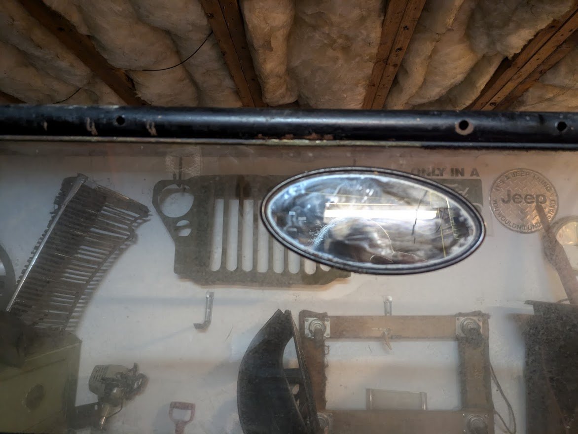

My 25 touring has three holes drilled in the top of the windshield frame. None of them looks like anything was ever bolted through them. Were they there for a windshield wiper and or mirror? When were windshield wipers introduced, and/or standardized? My car has a mirror drilled through the glass. How common was that?

First mirror mounted into the glass I have seen.

Your later oval mirror from some other auto has glass drilled to mount, while safety plate glass can be drilled, plate glass can too, would suspect your windshield glass is the old plate glass. Plate glass is illegal in most all states now.

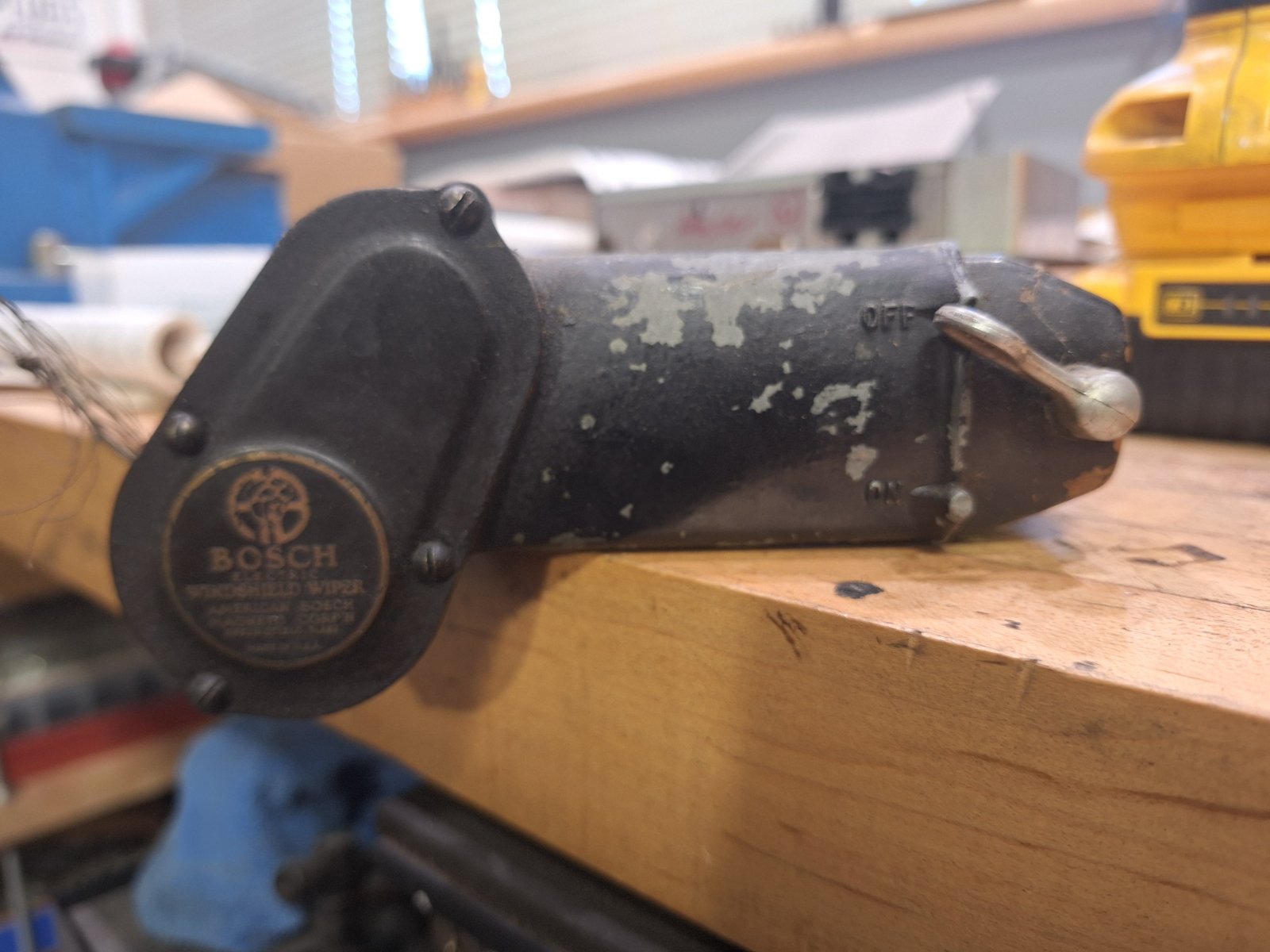

Yet another possibility. Bosch made a 6volt wiper for the Ts.

Curious! Unless that mirror is convex, it is likely useless. What are the chances of the windscreen glass being at the required angle for rear vision for any particular driver/seating combination.
More curious! if the car is a LHD vehicle, the single hole may be for a windscreen wiper, but the two holes, perhaps for a mirror, are way over on the right.

The two holes in the upper frame for the rear view mirror are correct for LHD.
That offsets the mirror mount for the driver to get a good view out the back, of course in the '24 model year, if the top is up, there are two rear windows, which makes mirror look back difficult, so Ford for 1925 and later changed the rear windows to a single wide window, somewhat better rear view
Note the Ford mirror for open cars has offset bracket, that is adjustable to the left angle for facing the LHD driver.
Later sport touring showing the Ford accessory rear view mirror.

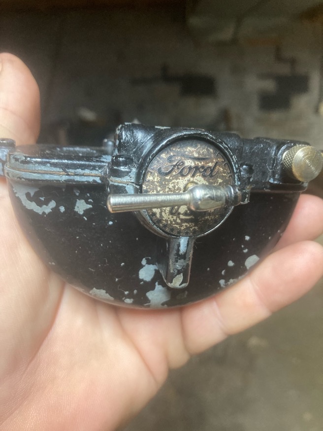

Original Ford 1926/27. I’m guessing this was a Dealer item? I’d love to get it restored and put on my 27 Roadster.
