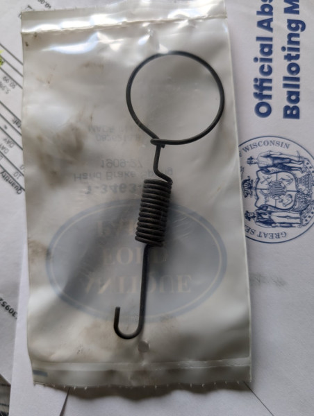

I got this spring. I thought I had a picture of where it goes, but I cannot find it.
I am not sure how it attaches to the brake. There is a hook hanging down from
the hand brake lever. Either the circle goes in the hook or the hook goes through
the other hook. But then where does the circle go?
I currently have a temporary straight spring with a hook at each end, with one hook
attached to the hand brake hook, and I have the second hook wrapped around the
brake clevis, but I know that is not correct either.
Thank you.

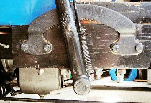

Unhook the round end and put it around the handbrake cross shaft then hook back then put the hook end on the rod at the pawl so it pulls the rod down.

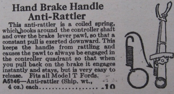

from blue oval:
"This accessory type replacement spring snaps around the crossshaft and locks onto brake pawl. It is not visible when installed"
Don't trust the brake until you have a serviceable brake pawl with notches that hold, and you have the spring in place to keep it locked.... the last thing anyone needs is a car jumping into gear, especially when your not behind the wheel!

Excellent photo. Thank you all for all the help.
