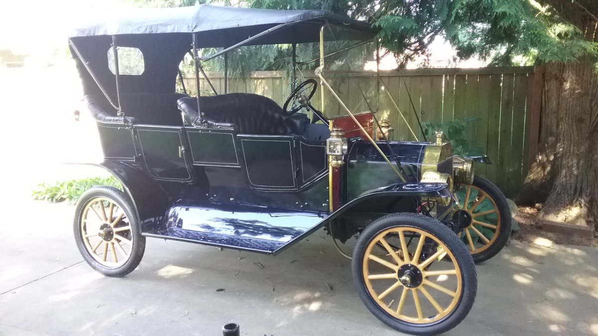

Here's my May 10th 1911 build date touring.

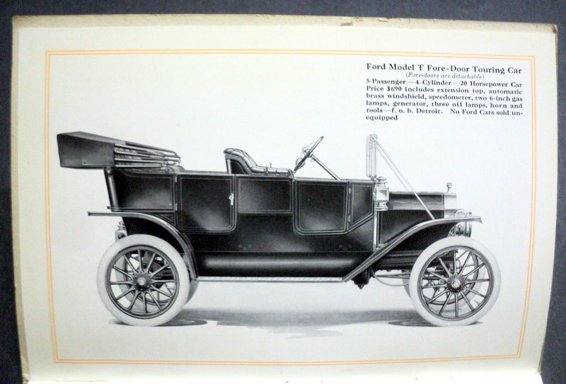

Here is an interesting image from a Ford publication showing a step-side body with straight-top fore-doors: If anyone here has a late 1911 or early 1912, please contact me.
