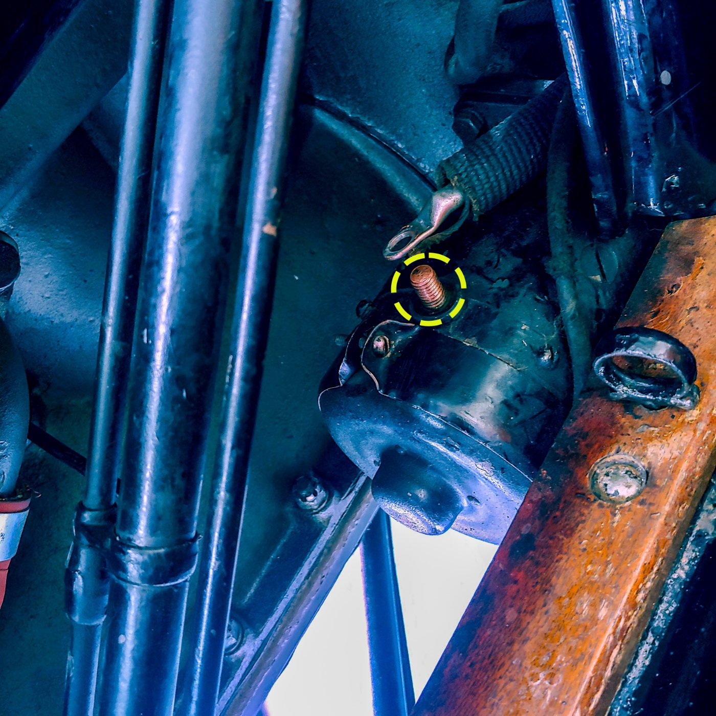

Continuity to ground on starter post.
I'm not an electrical guy, so I don't want to hook up the battery until I'm sure...
Is there supposed to be continuity to ground on this starter post?

YES. ..... The starter is a motor that relies on a switch to be engaged. It works like any other motor. Power is applied by the switch to the unit at the terminal , goes through the circuits , and needs to be grounded to the engine/trans to work.

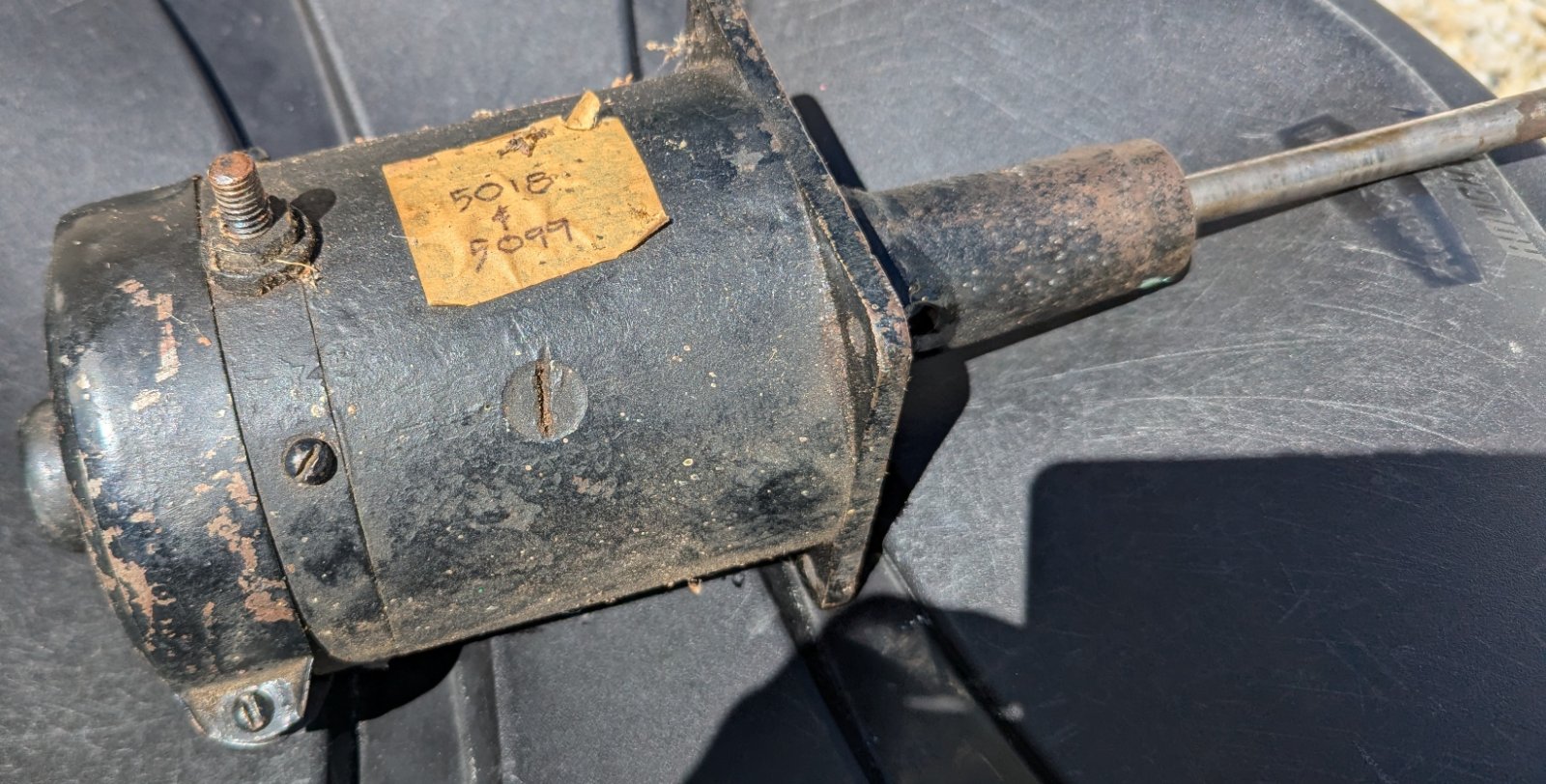

. . .... The suggestions on tightening the terminal nut "spot on " ....... The extra starter that I've had for over 20 years was obtained through a friend's estate sale and was told by the son that it was rebuilt and sold through Lang's Auto parts.
This is the starter that I had to test for continuity between the terminal post and the starter case ground. Perfect continuity. This morning, just for the heck of it, I hooked up jumper cables from 6 volt battery to the positive terminal and then tapped the case for ground... And son of a gun. It's spun like nobody's business. I suggest that you go ahead with a charged battery and then connect the starter cable to the terminal and give it a try..... ..when pressing the starter button, the starter does not turn , promptly disconnect your battery and do what you have to to fix your starter .Chances are, that you'll get a smile on your face without having to send your starter in for repair...... If I'm wrong on your starter, my apology in advance....... The bottom section of the threaded post just above the insulator looks shiny, doesn't it? I was in need of a terminal nut on my other car, used the one from this starter..... Also, removed the Bendix that was on this one, and installed on our 26 Runabout.
