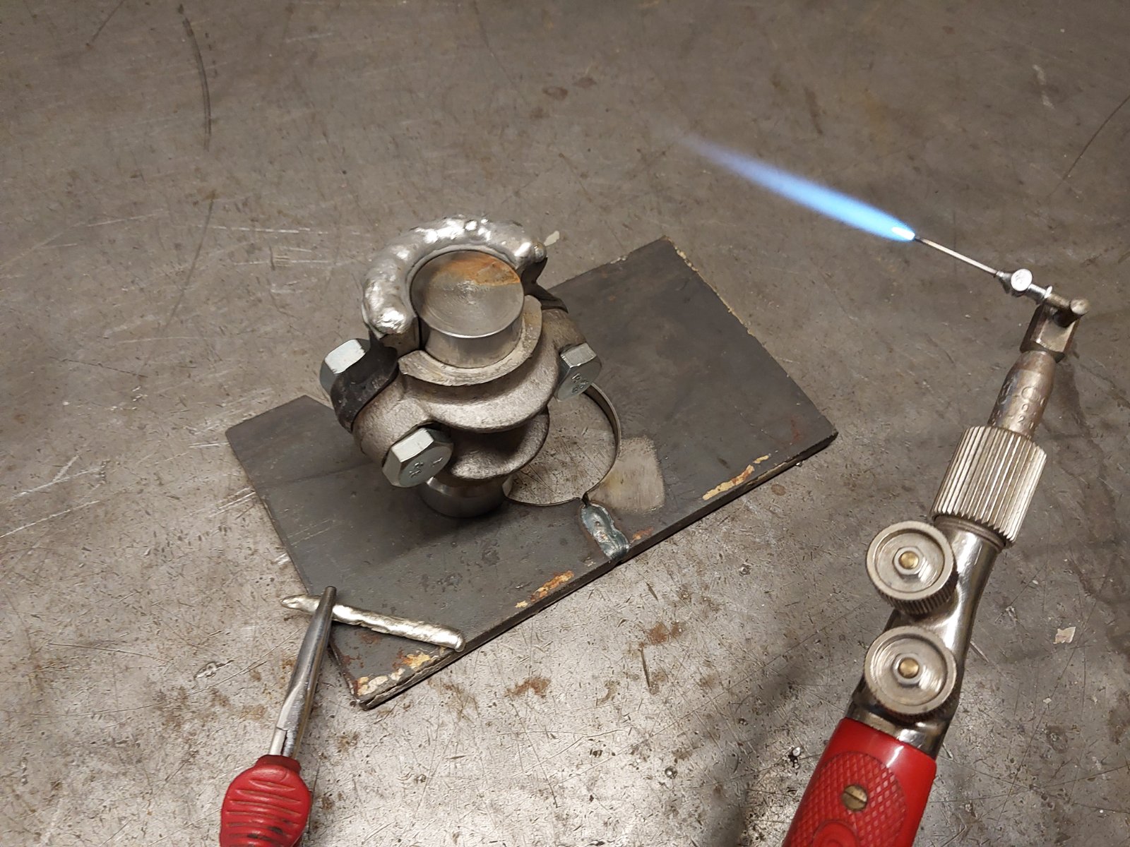

Today I made my first attempts to solder Babbitt on an old bearing shell. Has anyone done this and can give me some tips?
I would like to fix the axial play of the crankshaft on my engine.

Turn up a dummy bearing, a piece of exhaust pipe works OK, clamp it to the cap and that way you are only working with the thrust surface and not having the bearing babbitt run away on you.

Yes, that's what I said and I'm already in the process of turning a blind bearing.
What's the best way to add new Babbitt? Should I melt it into a wire first and then add it while soldering? Or is it better to place pieces on the printing surface and then simply melt them?

I use a large electric soldering iron to melt babbit I have previously poured into a thin stick. The iron provides controllable heat to melt the stick into the thrust face on the cap. I have yet to use a dummy crank piece.
When reworking the cap I use wet n dry paper on a glass plate to work down the added material. I start with the cap at a slight angle until the cap just enters the space on the crank throw. Then the cap is brought up to square and worked down until it can be inserted all the way.

I used a D/S inner bearing race to simulate the crank, raised 1/8" high. Outside I used an aluminum can shell & clamped together with a hose clamp. Using a small, cool oxy/acetylene frame heated the face warm & dripped new babbitt from an old rod. once piled in place, I used the torch to melt it even into the mold area. Be careful not to overheat. Just enough to flow the new top layer.

I use a piece of solid stock turned to the crankshaft diameter clamping in thecap. Using solid material it acts as a heat sink to protect the babbit surface of the beaing cap. I work with a small acetylene flame.

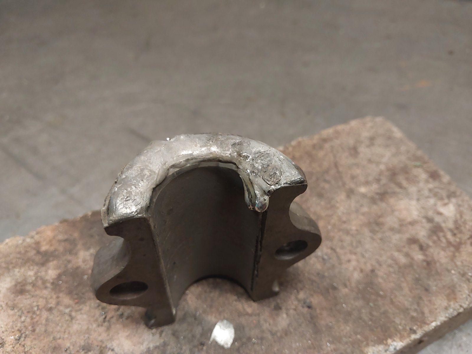

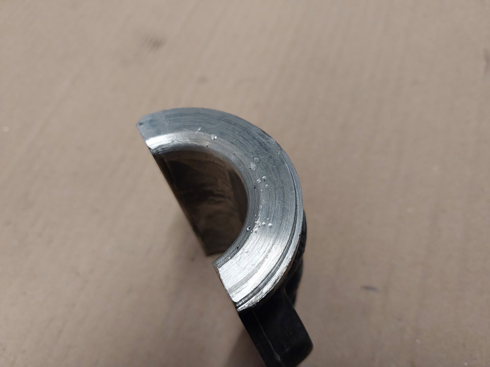

Post by Vonau » Sat Jul 06, 2024 5:55 pm
Thank you for all the answers

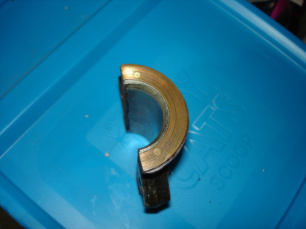

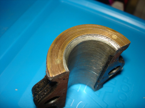

Today I soldered and processed my bearing shell. I used a small propane flame to do this.
It went pretty well, but I didn't make it pore-free.
What do you think, can I use it like that?

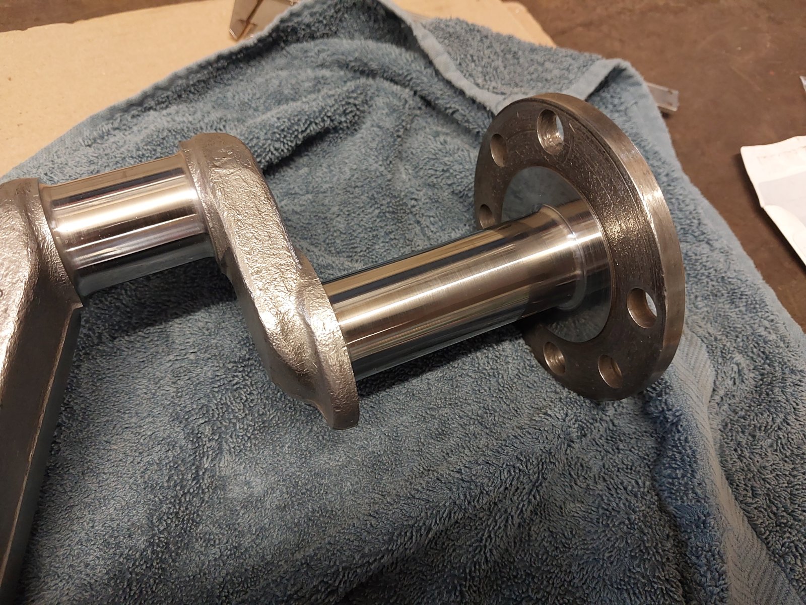

I also machined the pressure surface on the crankshaft to remove the wear.
greetings from Switzerland

Looks fine to me!

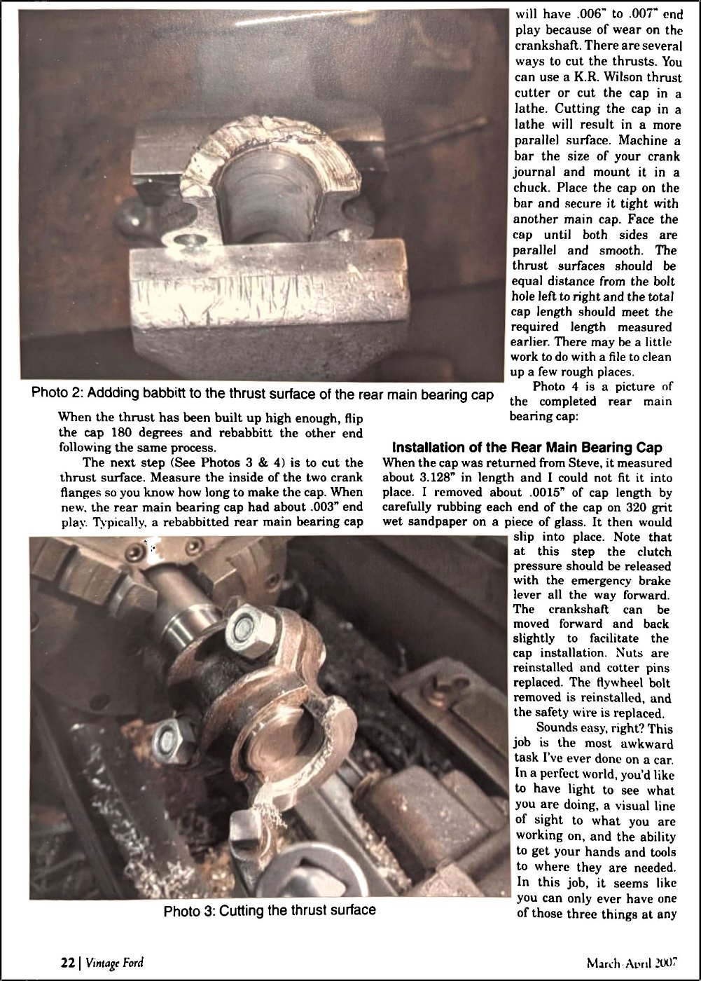

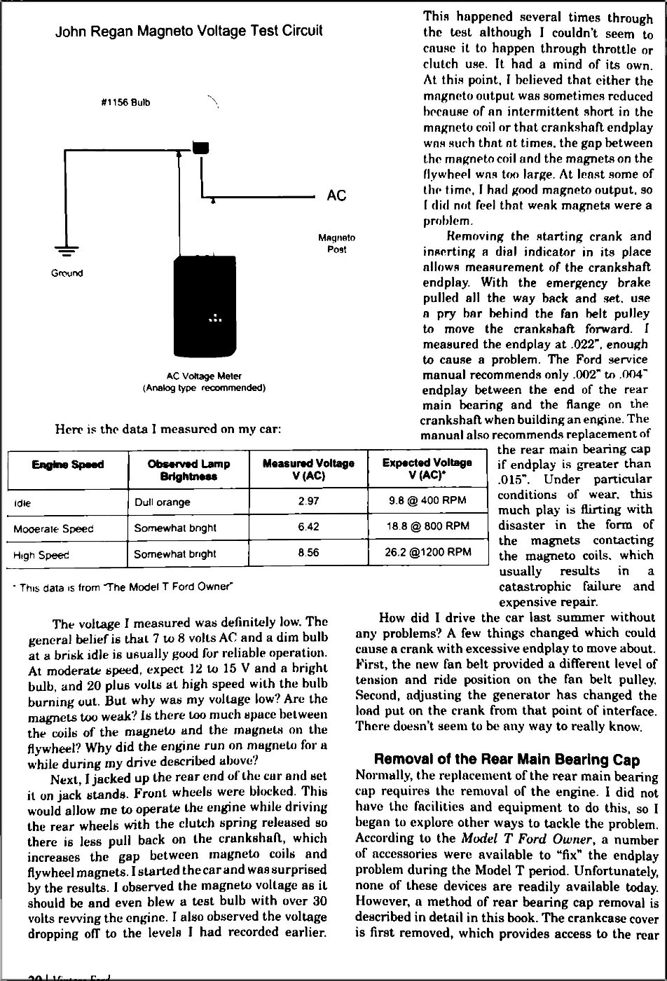

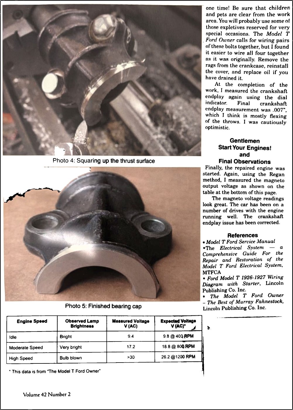

Came across Vol 42, Number 2 .... MARCH/APRIL 2007.

Beat,
Nice job on the crank surfacing. IMV minor pitting on the cap thrust face is not a bad thing and I'd be happy to use it IF I was certain the babbit was well adhered to the cap and the pitting/porosity wasn't the result of poor material or significant foreign material in the mix.

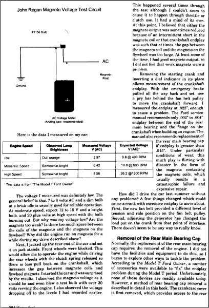

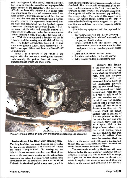

Moxie26 wrote:
Sat Jul 06, 2024 10:19 pm
Robert,

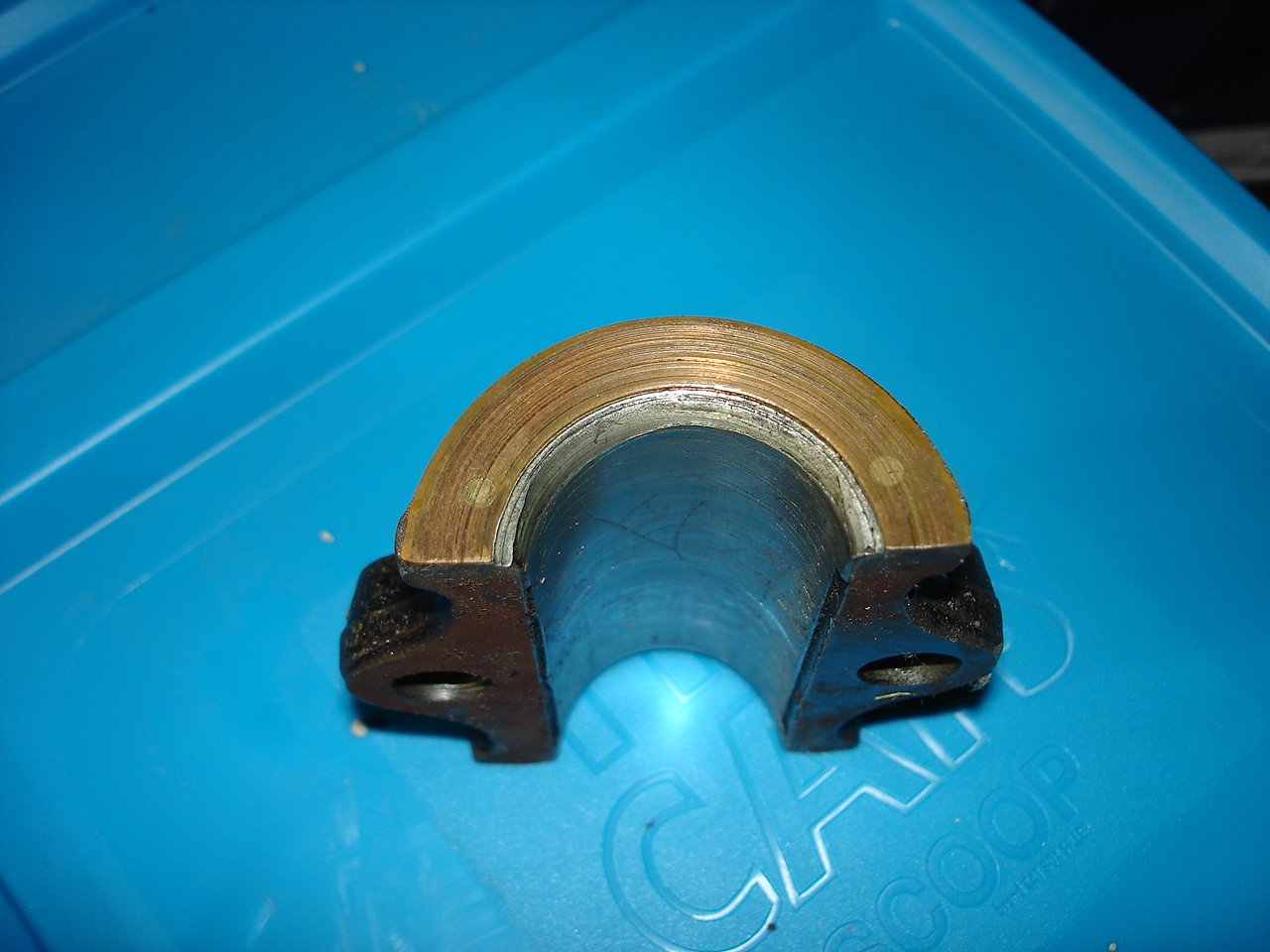

Good on you for finding the article, hope you don't mind but I've taken your images and sorted them out a bit here...

This is a pdf version of the Ken Foster article.
Excessive Crankshaft Endplay Repair.pdf
