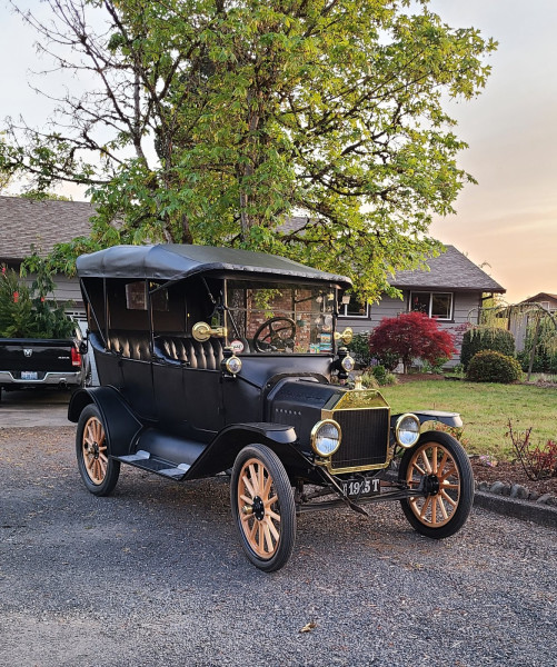

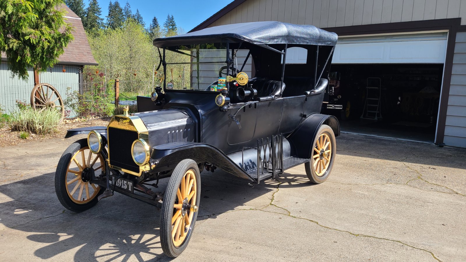

Post by MichaelFrice » Wed May 28, 2025 6:44 pm
Well, I finally went for it. It has been done for a while now; I am just getting back to the forum to post about it.
Thank you everyone for your encouragement. You were right, it wasn't hard, just a new process to me so I went slow.
It came out pretty good. I see a few mistakes that I would do differently, but it looks pretty good.
ewdysar
Posts: 374
First Name: Eric
Last Name: D
Re: 1915 Model T Top - HELP in Vancouver, Washington / Portland, Oregon area
Post by ewdysar » Wed May 28, 2025 7:18 pm
That looks great, Michael! Great job!

Posts: 7167
Post by Allan » Wed May 28, 2025 8:16 pm
Sure is a neat job. Much better than some I have seen. Well done.
